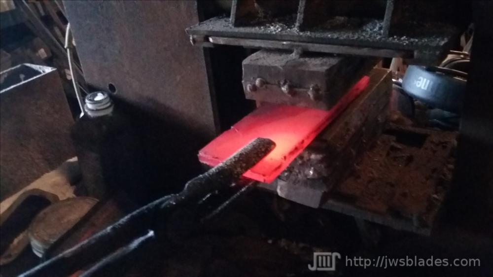

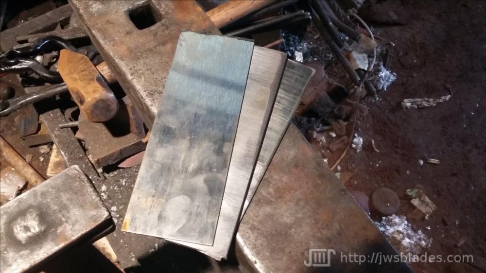

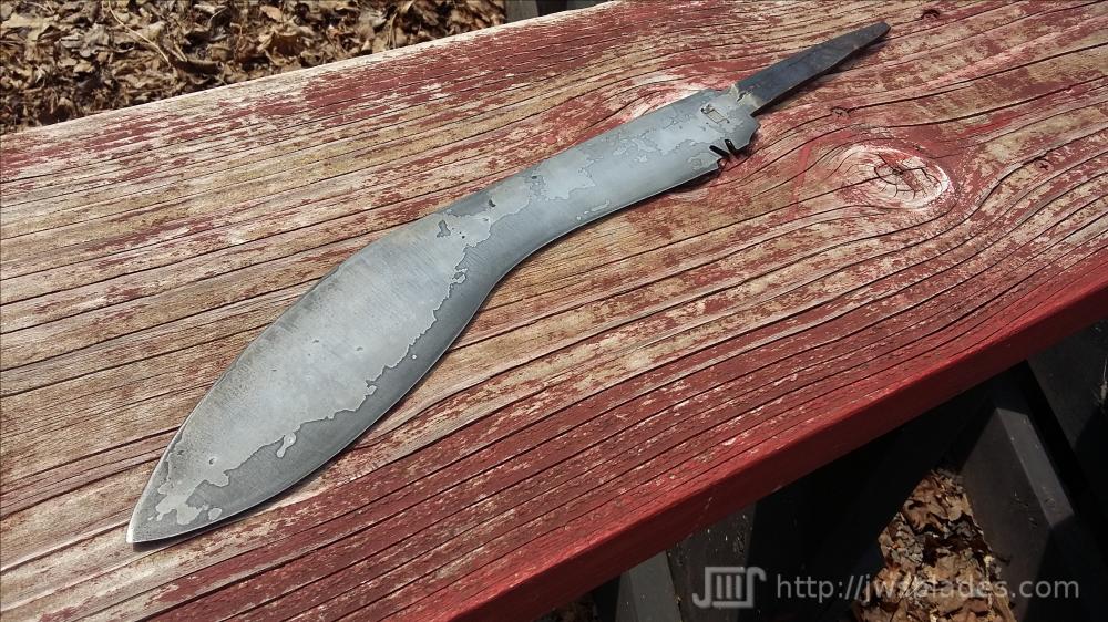

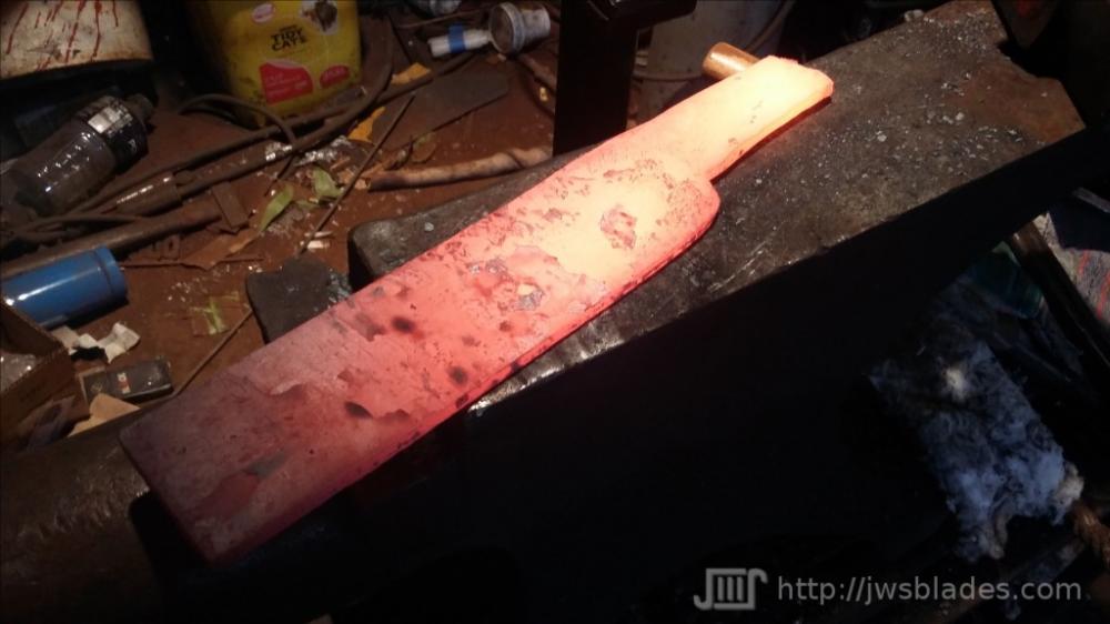

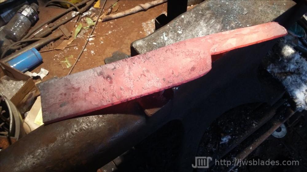

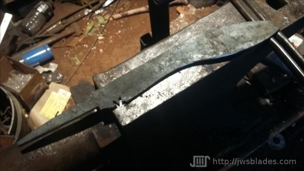

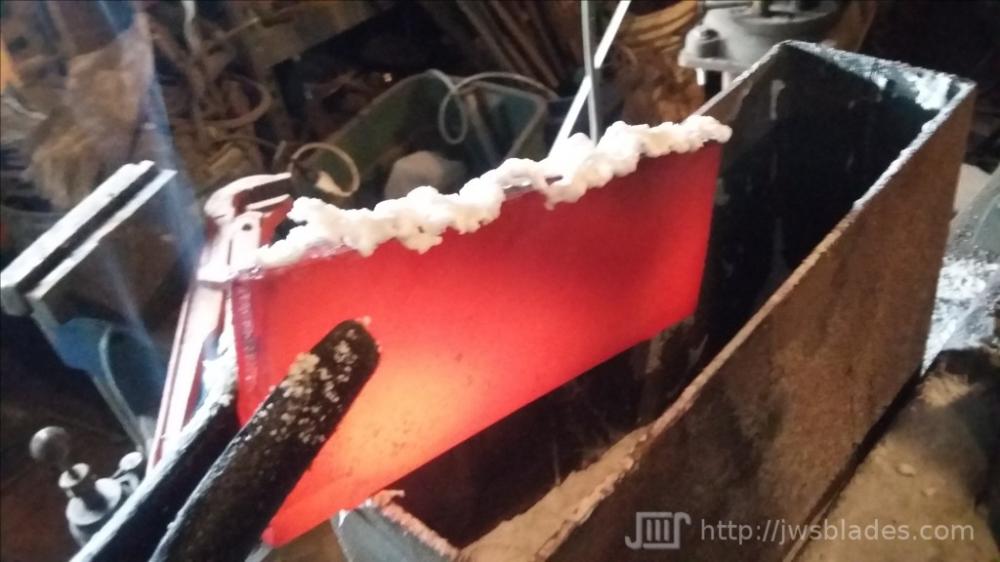

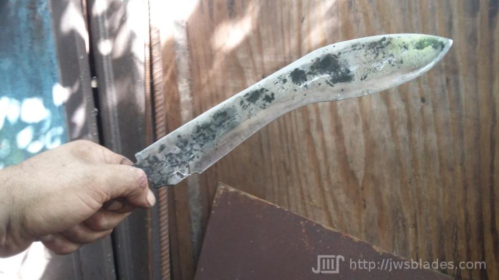

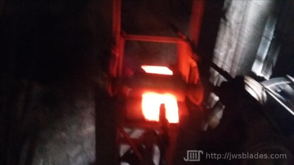

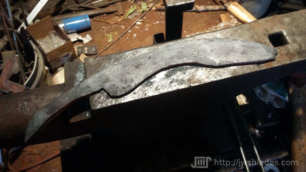

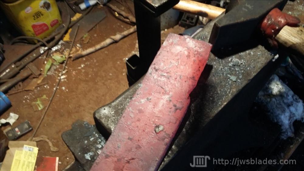

j.w.s. Posted July 10, 2015 Share Posted July 10, 2015 Here's a custom order I'm working on right now, figured I'd share some of the making of photos. Steel is 15N20 and 1084, no mystical reason behind the choice of steels other than I like the way it works and holds an edge, plus I love the look I get after etching. Sorry if a few of these pics are a little blurry but I'm just shooting from my phone as I'm working so no real time to be too darn professional about it.. Anyway, I had some other things going on this week and haven't had a chance to finish it, but I'll be doing the heat treatment as a demonstration this weekend during my knife making class. Enjoy!-J Quote Link to comment Share on other sites More sharing options...
Frosty Posted July 10, 2015 Share Posted July 10, 2015 I have a "Kukri" question. What are the notches in front of the guard for? They seem to be a pretty common Kukri feature.Frosty The Lucky. Quote Link to comment Share on other sites More sharing options...
HWooldridge Posted July 10, 2015 Share Posted July 10, 2015 I have a "Kukri" question. What are the notches in front of the guard for? They seem to be a pretty common Kukri feature.Frosty The Lucky.I have read that nobody really knows anymore as the answer is lost in antiquity. Some believe the notches symbolize a cow's udder (sacred Hindu symbol), others say it symbolizes the lower nether regions of Shiva. Still others say it is a shock absorbing feature - this because very few traditional kukri have full tangs. I like the last explanation because every old kukri I have examined has a rat-tail tang that is riveted over the pommel and it stands to reason that some give on a large blade might be a good engineering detail. Quote Link to comment Share on other sites More sharing options...
j.w.s. Posted July 10, 2015 Author Share Posted July 10, 2015 That notch is called the cho. What it's exactly for has pretty much been lost through the ages but there's plenty of wild speculation out there on the net. Historically it's not present on every kukri but its prevalent enough to have been associated with it. I've heard everything from using it as a defensive mechanism to cutting a finger just saw the blade always draws blood when it's removed from the sheath. Personally, there's so much variation in cho designs that I think it could have just been an expression of the makers art or talent, perhaps there are even regionally diverse. But I'm not knowledgeable enough to give a real reason, which along with my earlier Internet citation, I don't think anyone else is either. Lol-JI have a "Kukri" question. What are the notches in front of the guard for? They seem to be a pretty common Kukri feature.Frosty The Lucky. Quote Link to comment Share on other sites More sharing options...
Frosty Posted July 11, 2015 Share Posted July 11, 2015 Thanks, lost in antiquity works for me. Now I can speculate wildly and not look any dumber than anyone else! My first thought was a blade catcher not really a "sword breaker" but similar. Were one to parry a blade with the Kukri held perpendicular and slid against the guard it might be possible to catch the other blade between the guard and notches for a disarm.Hmmmm?Frosty The Lucky. Quote Link to comment Share on other sites More sharing options...
j.w.s. Posted July 11, 2015 Author Share Posted July 11, 2015 Thanks, lost in antiquity works for me. Now I can speculate wildly and not look any dumber than anyone else! My first thought was a blade catcher not really a "sword breaker" but similar. Were one to parry a blade with the Kukri held perpendicular and slid against the guard it might be possible to catch the other blade between the guard and notches for a disarm.Hmmmm?Frosty The Lucky. And that very well could be a reason, specially since there's no guard or a flared bolster for hand protection. Its a knife fight afterall, you're going to get cut, the objective is to cut the other guy more. -J Quote Link to comment Share on other sites More sharing options...

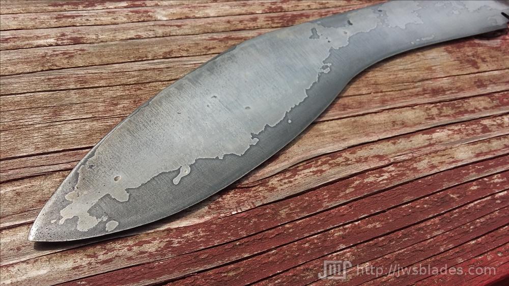

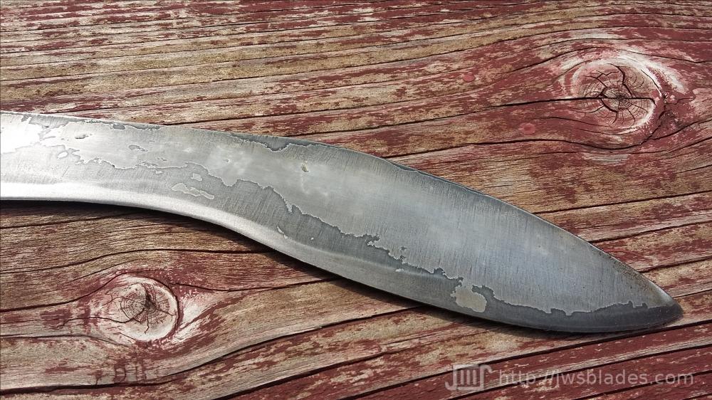

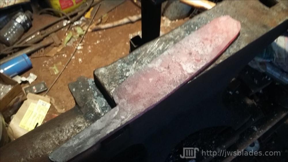

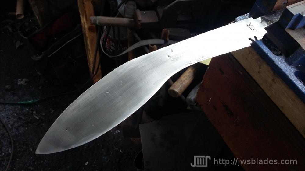

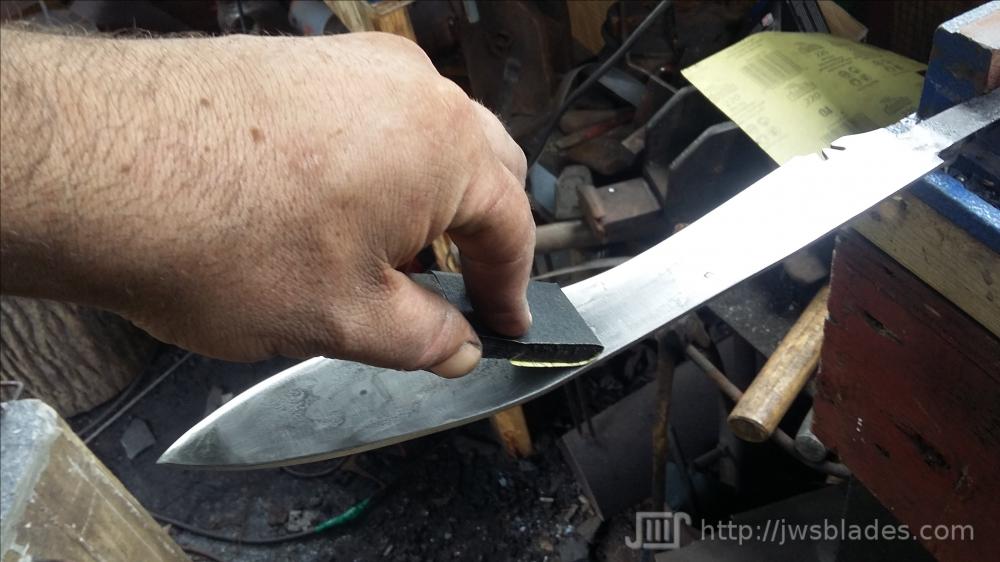

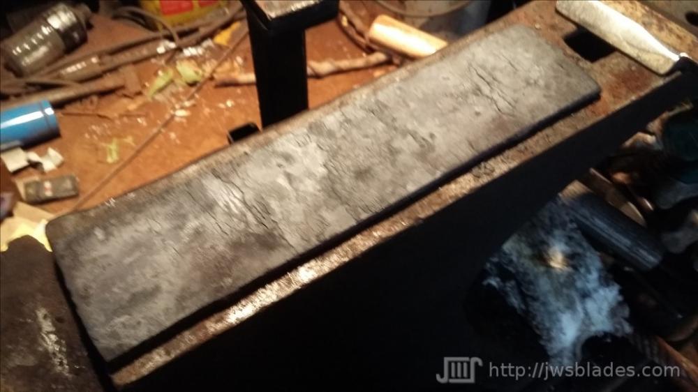

j.w.s. Posted July 13, 2015 Author Share Posted July 13, 2015 I was teaching a knife making class this weekend with two teenagers, one of which was my son, so I didn't have all the time in the world to work on it but there were a few moments when I got to demonstrate a few things and I took advantage of them. Struck while the iron was hot, as we say. Anyway, I got the heat treatments done, polish and the first etching. Also, not pictured, I got the handle roughed out and ready for attachment. I'm going to be casting some pewter for the bolsters and for the cap - hopefully tomorrow. Still lots of work and touch ups to be done, but it's coming together. Here's the new pictures, enjoy!-J Quote Link to comment Share on other sites More sharing options...
