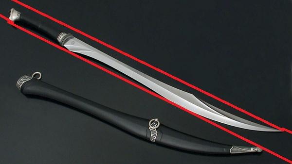

theboss1412 Posted June 27, 2015 Share Posted June 27, 2015 Hey Guys,So I finally attained the tools(bench grinder, belt sander) for crafting a sword(scimitar) using the stock removal method. Since I am just starting out, How long would it take for me to complete the blade, and, what correct measurement of steel should i get for the specific sword I will be attempting to make. If I have any other questions I will add on to this thread.Thanks Quote Link to comment Share on other sites More sharing options...

theboss1412 Posted June 28, 2015 Author Share Posted June 28, 2015 Would 36 inches x 2 inches x 1/8 inch of steel square stock work for my sword I am intending on creating?I plan on getting my metal from a hardware store. Quote Link to comment Share on other sites More sharing options...
tdaleh Posted June 28, 2015 Share Posted June 28, 2015 Go to the top of this page and read the stickies there . Than go to the knife making section and read it. Making a sword is not beginner project. Quote Link to comment Share on other sites More sharing options...
jmccustomknives Posted June 28, 2015 Share Posted June 28, 2015 First. Stop what you are doing. You are not ready for a large blade. You will be wasting your time and effort. First learn how to grind small blades. Learn how to heat treat the steel. It looks easy, but there are many pitfalls and it takes experience to do it. A blade that long is extremely difficult. Now as for how long it would take, on average a 6" blade will take me at least 30 min to grind. After heat treat another hour or so to finish it out. That simple little blade can easily have 10 hours to make. A sword will take much longer. Quote Link to comment Share on other sites More sharing options...
theboss1412 Posted June 28, 2015 Author Share Posted June 28, 2015 I honestly did not realize that. I guess crafting a sword from little experience is much harder than anticipated, at least for a good high quality one... I'll just start with smaller blades and progress from there...Is the stock removal method the best way to start knife making? Quote Link to comment Share on other sites More sharing options...
Michael Cochran Posted June 28, 2015 Share Posted June 28, 2015 I've made several knives of varying quality and still am not confident enough to try a sword. I would say 1/8" is much to thin to start with.i would suggest doing as mentioned above and doing some readin. Lots and lots of reading. Quote Link to comment Share on other sites More sharing options...
ThomasPowers Posted June 28, 2015 Share Posted June 28, 2015 (edited) what books on knifemaking have you read? If you live in the USA you should be able to ILL them at your local library. (Would you go to a Dr that had only looked at stuff on the internet and never went to Med School?)You can make knives with files and abrasive paper. It is a good place to start. You might want to hunt down The $50 Knife ShopBTH what kind of belt sander do you have? Ones designed for wood are not a good choice for metal. I worked with a swordmaker for a year as my "job" I don't recall we every used a bench grinder on a blade; but we did a lot with a US$1000 (early 1980's cost) Bader belt grinder.Note too that large blades are dangerous to work on as are the tools used to work on them. Comparing scars is a common thing between blademakers---like that seen in Jaws actually. Edited June 28, 2015 by ThomasPowers Quote Link to comment Share on other sites More sharing options...
jmccustomknives Posted June 28, 2015 Share Posted June 28, 2015 As far as it goes, yes stock removal is where we all tend to start. Even when forging a blade some, if not quite a bit of stock removal takes place. Quote Link to comment Share on other sites More sharing options...
Latticino Posted June 28, 2015 Share Posted June 28, 2015 Also the hardware store is an unlikely place to source the kind of steel you should be using for actual knife making (high carbon tool steel). As all others have said, you need to do a lot more research before safely attempting knife making, much less swords. Stock removal is a great way to start making knives. You can even start with some already profiled kits to focus on the finishing aspects of knife making.As far as time for a sword goes, I just completed a 5 day class where we learned something about rudimentary sword making. We all worked very hard, a minimum of 10 hours per day, on much simpler swords than you have pictured. Without an instructor helping us every step of the way I doubt anyone would have gotten done. Grinding is a challenge, but properly heat treating such a long blade without warping it is more like an art. Certainly could not have done that without a lot of hand holding (and most of us had been bladesmithing for at least a half dozen successful knives).If you want to learn sword making, take your time and don't skip steps. If you just want to own a sword, the cheapest way is to buy one already finished. You can do a lot with relatively simple tools, though a lot of extra time should be budgeted if you won't be using a quality belt grinder. The most critical tool you need is knowledge, and that one will save you a lot of time and grief in the end run. Quote Link to comment Share on other sites More sharing options...

Steve Sells Posted June 28, 2015 Share Posted June 28, 2015 If you cant take the time to read the posts that are tagged for "reading this first", then I expect a lot of hospital and Doctor visits in your future, and very few usable blades, Good luck. please keep small children away from the shop.P.S. you do not want to use most tool steels or high carbon for a sword, Quote Link to comment Share on other sites More sharing options...
theboss1412 Posted June 28, 2015 Author Share Posted June 28, 2015 Thank you everybody, I really appreciate the advice. Before Starting I will broaden my horizon on knife making What is usually the thickness of steel that is good for just starting out? Quote Link to comment Share on other sites More sharing options...
Michael Cochran Posted June 28, 2015 Share Posted June 28, 2015 Id imagine that's goin to depend on what type of blade you're makin. Quote Link to comment Share on other sites More sharing options...
ThomasPowers Posted June 29, 2015 Share Posted June 29, 2015 1/4" is a pretty good maximum for stout belt knives, down to 1/8" for folders. It depends on the blade.Perhaps "Custom Knifemaking, 10 projects from a Master Craftsman" would be a good start as it will work you through several different blades. Ask your local public library if they can ILL it for you. Quote Link to comment Share on other sites More sharing options...
