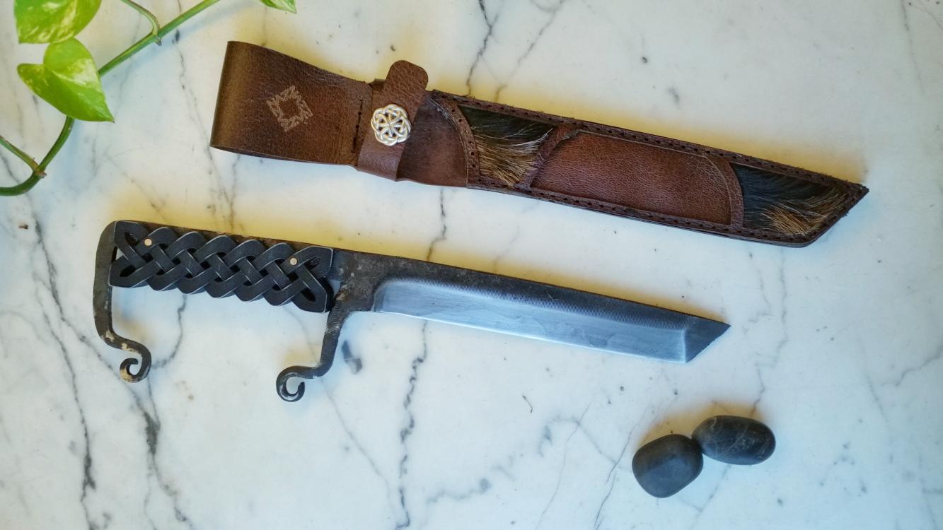

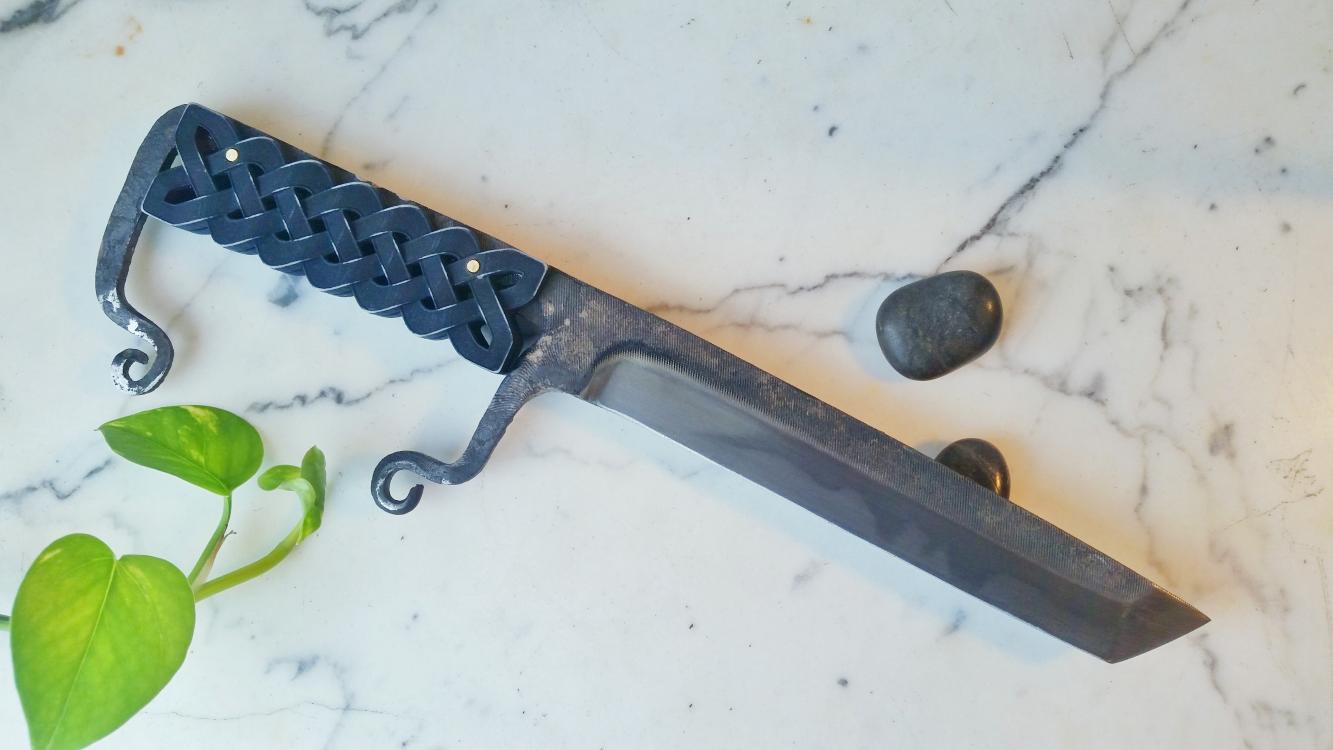

Some of y'all may know I tend not to repeat designs, however I had the extra handle left over from my previous, nearly identical, tanto from a couple months ago, and I couldn't help myself.
20150415_085614-01.thumb.jpeg.7929e7960f20150418_191234-01.thumb.jpeg.5fb48a0c5120150418_191627-01.thumb.jpeg.418d8f6fa520150415_085804-01.thumb.jpeg.c056e9eeef20150415_085706-01.thumb.jpeg.c02d3db944

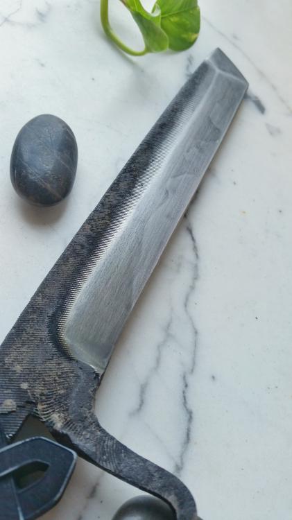

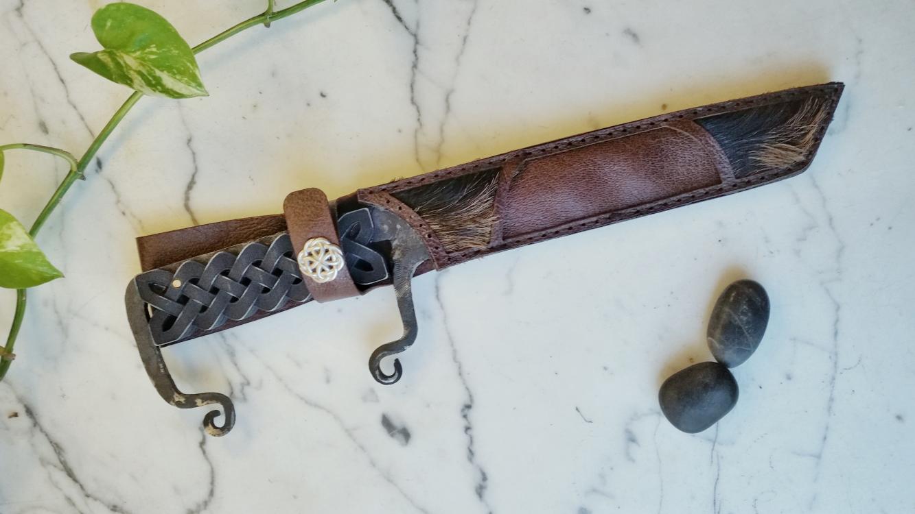

It's a century-old file I reforged and heat treated with APG-36 clay and Parks 50. 12.25" OAL, 4" handle. Sheath is goat leather I got from the only tannery in Cyprus while on vacation there.
Comments and critique encouraged,
Theo

is the handle on that metal as well, and if so, HOW THE HECK DID YOU DO THAT.....
Either way, that is an awesome piece,
Theo, REALLY digging this blade. From the guard and pommel, handle material, the clean American tanto shape, to the GOAT LEATHER? That's so cool!
​Getting to. You introduced us to your girlfriend and grin in your pictures of Sicily, Greece(?) I think it was. You're an addictively likable guy.
Haha, thank you. And Cyprus :)... is there a smiley for grinning?

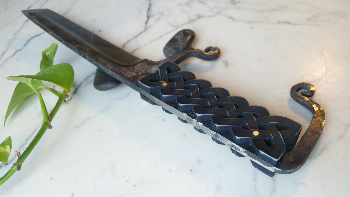

Malice, the grip is 3D printed high density polymer. Although I could have printed in wax, molded, and cast the whole deal too... would have been super heavy but I can design it with a hollow interior to reduce weight... if I wanted to or there was a commission for it.
And thank you Benten, the goat leather was a joy to work with
Either way, that is one slick knife. And an awesome use of a 3d Printer.
