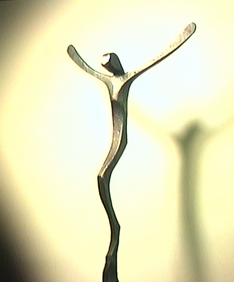

This little figure I forged on the end of a Ø16mm (5/8") bar, the arms were added. It was for use as a processional cross. I was trying to make it uplifting rather than slumped…though in this thread context I could see it as a diver or base jumper about to take the plunge! The second image I have rotated the figure forward by just 5˚ and the effect is closer to the actual stance of the finished piece, but you can see how a little thing like that makes a difference to the apparent stance/balance of the figure…shifting the weight away from the arms and onto the feet.

ALAN_EVANS_CHRIST-FIGURE.thumb.jpg.cd3f9ALAN_EVANS_CHRIST-FIGURE_5deg.thumb.jpg.
Edited by Alan Evans
added the adjusted image for comparison
I have just noticed that in the to-ings and fro-ings that the complimentary advice to balance looking up mannerism was lost...the second part should have read to look at how they animate and get recognisable human gestures from a rectangle like Sponge-Bob!
Alan

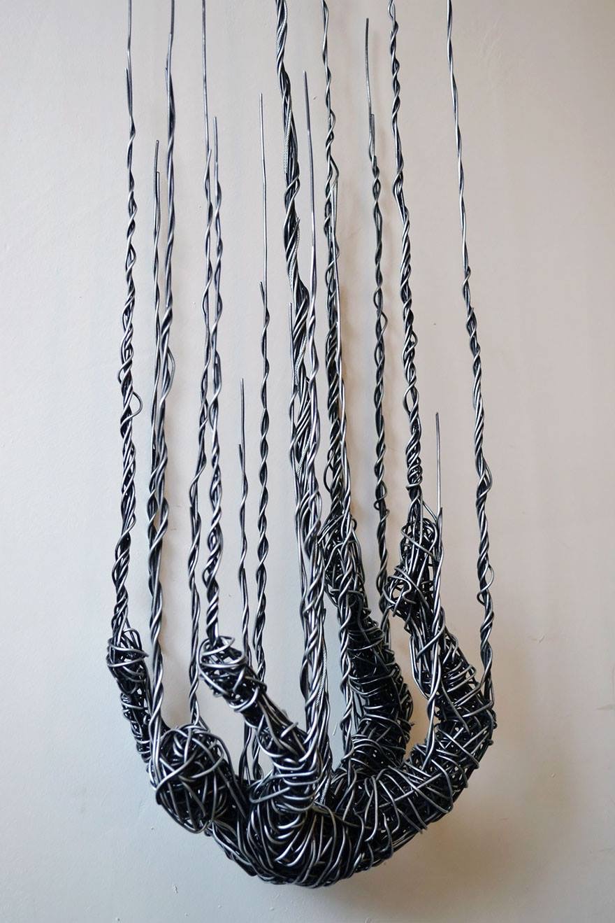

Saw this on a Facebook group I follow, thought about your request, it looks like skydiving to me.
skydiving for sure... or getting sucked into a black hole maybe?  I've had two ideas so far as how to approach. 1. fuller in the neck from sq stk, round above the fullering into head and treat the torso and limbs as a "split cross" below the fullering.  2. use a wire twist method like in your photo SS but probably not as complex.  thanks for the ideas so far

I really like the wire sculpture you posted Spanky, who made it? Do you know the size?

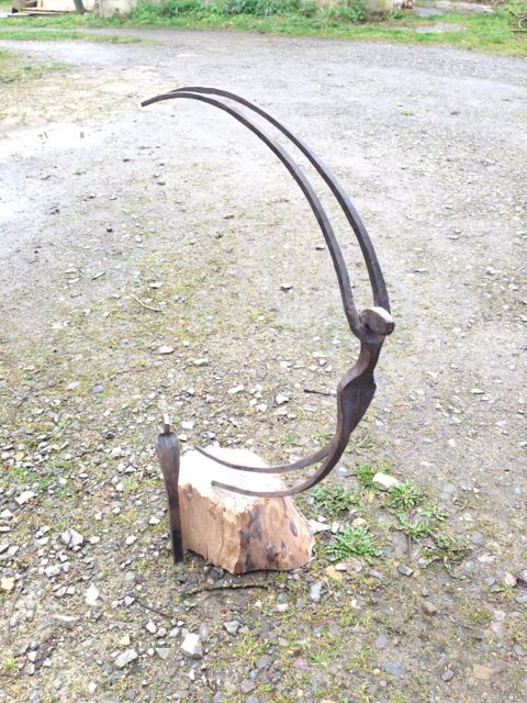

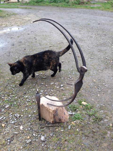

I have just taken a couple of photos for you of two of the figure pieces which were given to my partner Lesley by Heiner Zimmermann (standing figure) and Martin Breidenbach (dancer). She had fed and housed them while they were working with me when both were journeymen in the '90s. They were two of the smiths who designed panels and lead masterclasses for the BABA Pillar of Friendship in 2007. These figures were the example pieces for their masterclasses. If you do a google image search you will find a lot of images of the pillar. There are four panels on it which have figures in varying styles / stages of abstraction which may be useful for your deliberations…
It was posted by architecture and design magazine, I didn't see any notation of whose work it was
​Bummer, I won't be able to credit anyone if (when) I steal the idea. Deb's especially gifted at bent wire art, far better than I.

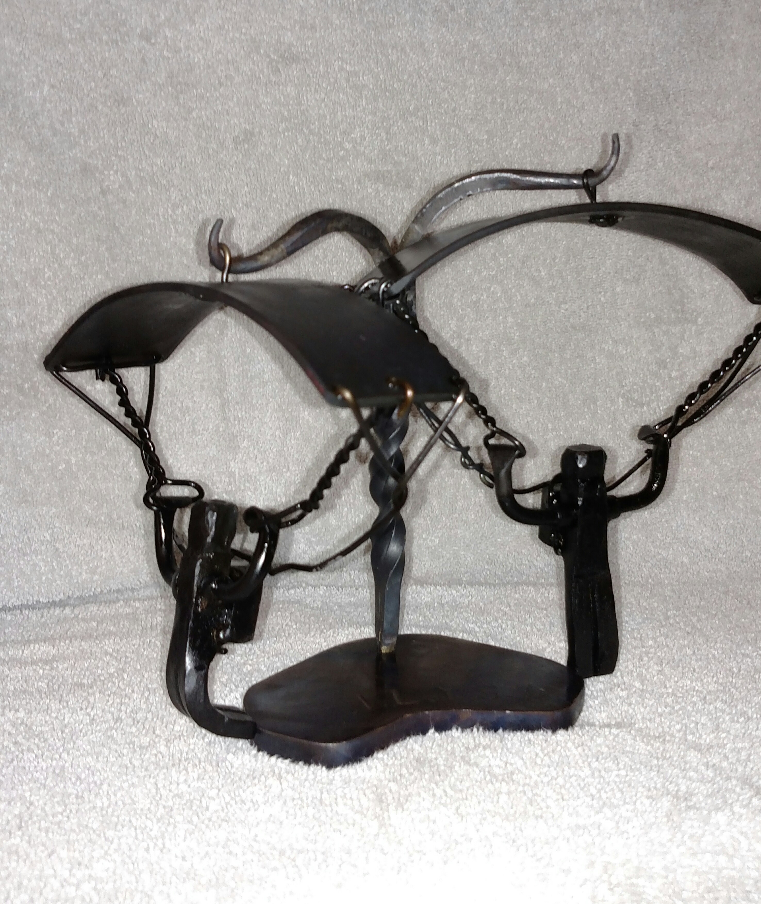

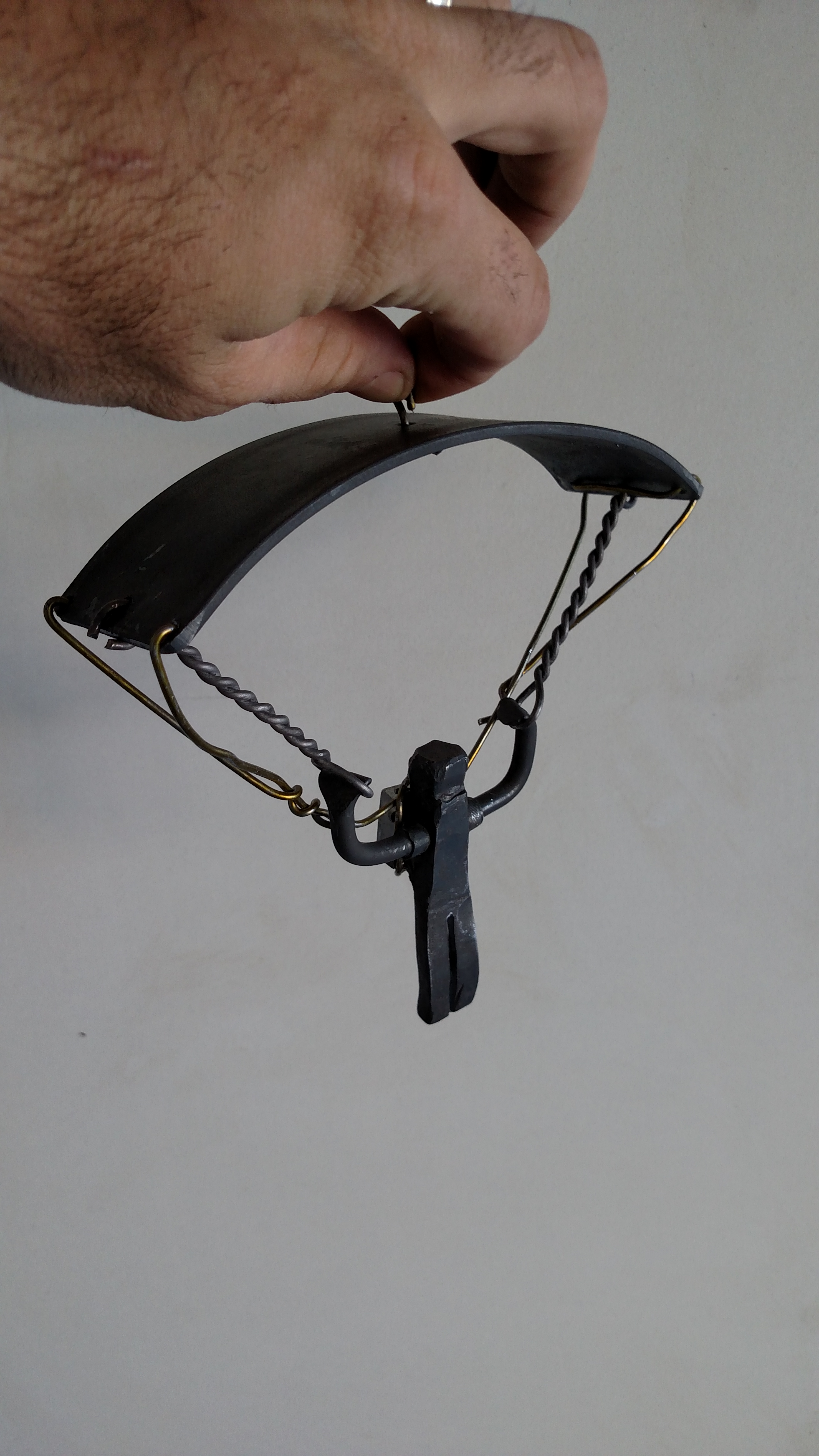

Finally got it done and this is what I came up with. Customer was very happy with it.
Sorry for the lousy camera photos.
I REALLY like that one! Well done.
Good work!
I just reread this topic yesterday and bam: today you send the pics. Kinda spooky :)
Bests:
Gergely
Thanks! Wish I would have done the connection to the parachute different but just being picky with myself.
