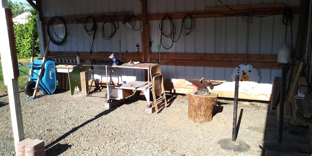

Ihaveahoover Posted August 18, 2019 Share Posted August 18, 2019 I also have one of these anvils . My dad Don Grant went to same farrier school . Just went and looked and his name is also stamped on it. Quote Link to comment Share on other sites More sharing options...
