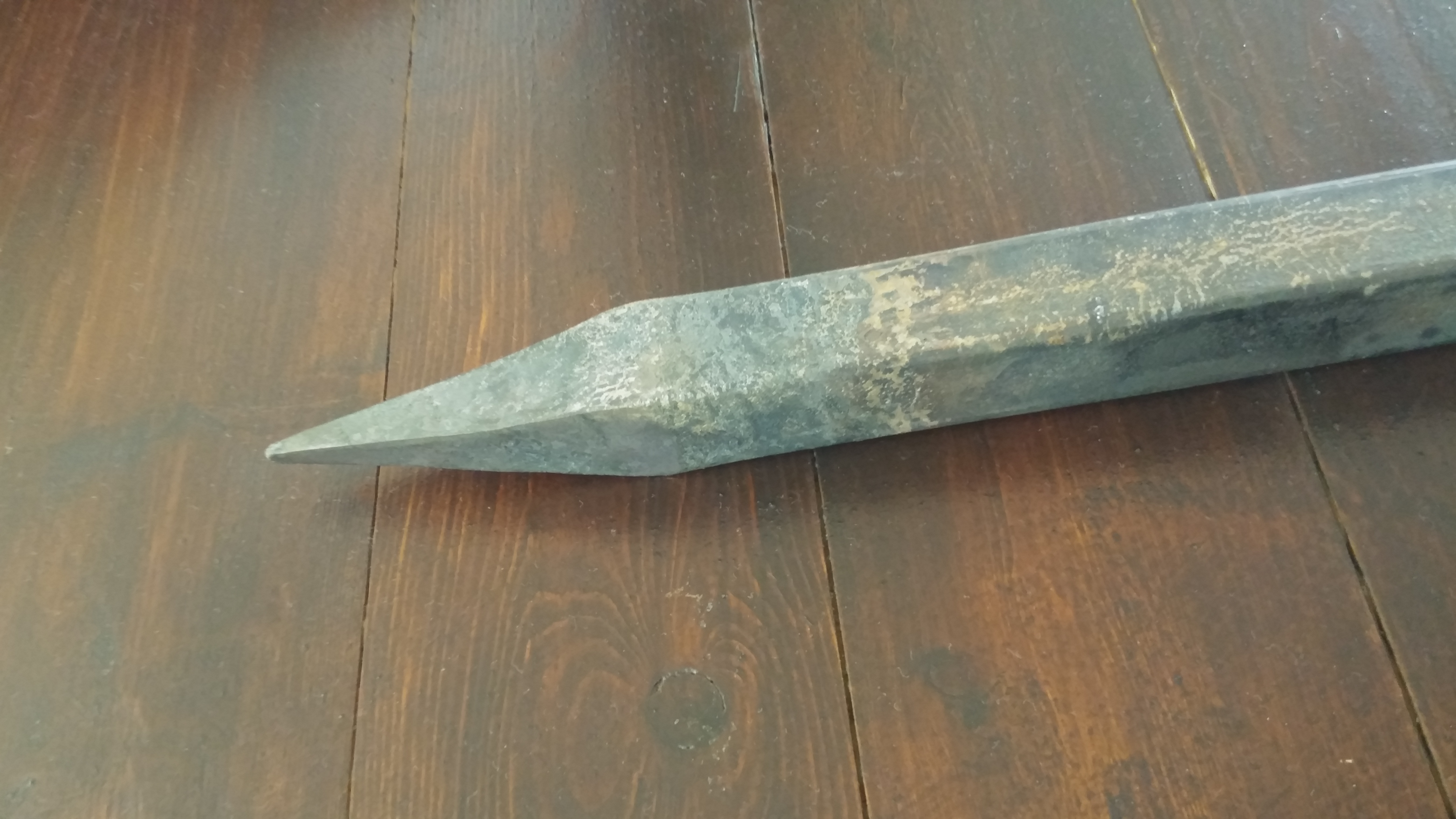

santisandreas Posted May 17, 2015 Share Posted May 17, 2015 hey everyone. since you have some more experience on the power hammer i want to ask you a question, especially timothy who has started this post. i got an order the other day to forge a lot of tapers for a fence which is 400 m long. and the welder who applied for the job want the tapers done by a blacksmith so that he doesn't need to grind a 25 mm steel rod into a short taper. but before i can accept the job i need to make sure that its doable. due to the large quantity and the size of the 25 mm square stock it will be too difficult to forge them by hand. is it possible that this taper can be forged on the power hammer? i am not familiar with the techniques of a power hammer and neither do i own one. but i will meet with a fellow blacksmith in Nicosia that owns one and probably do the job with him. see the taper below which was forged by hand. in particular my question is if it possible to forge such a steep taper on a pair of flat dies. I have seen in the past some tapers forged under the power hammer but they were too long compared to what i want to do. Quote Link to comment Share on other sites More sharing options...
HWooldridge Posted May 17, 2015 Share Posted May 17, 2015 Would be relatively easy to bolt a taper die to the bottom hammer die and get the angle.You can also make a "pinch" die for that taper. Top and bottom tools made to match desired angle; the heated bar is placed slightly past where the point will end then bang/turn, bang/turn. etc. until the small piece of scrap on the end breaks off. I usually do that for short tapers because I don't have to fight the material kicking back at me. Quote Link to comment Share on other sites More sharing options...
santisandreas Posted May 20, 2015 Share Posted May 20, 2015 i thought that if you bolt a taper die it would kick back the stock towards my body and maybe cause harm, so i was trying to think of a way if one can forge it with the flat dies.. but thanks for the advice. are you sure it is not dangerous to give an angle to the bottom die? i think it is safer to do the pinch die probably, so as to eliminate the kick back which will make it easier as well on the hands as i will be making a lot of them as well. Quote Link to comment Share on other sites More sharing options...
JNewman Posted May 20, 2015 Share Posted May 20, 2015 That is why you never stand behind the the work when you are forging on a power hammer especially with taper dies. But you can draw a taper that steep on a hammer safely. To consistently draw tapers the same especially short like you show you want a fixed taper die not a variable one like the others shown in this thread.If you don't use a pinch type die, one thing that will help are to use a "scissor cutter" to cut 2 bars out of 1 or just to cut a little off the end of the bar. The cutter is in effect a pinch die to preform. You will probably find roughing the taper out on the corners of flat dies before you use the taper dies will help as well as they will draw the bar out lengthwise unlike the Taper die which will spread as much as they lengthen. A bottom die only is cheaper and easier to make but if you need lots of these for an ongoing basis matching top and bottom taper dies are easier to use especially it the bars are really long and you need a stand to support the outboard end. Quote Link to comment Share on other sites More sharing options...
