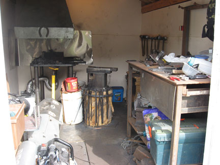

urnesBeast Posted November 11, 2010 Author Share Posted November 11, 2010 One of the goals, as someone who has burned a smithy to the ground, was to sleep well after forging. That has been achieved. The final construction ended up like this: Bare studs and clapboard add insulation add 5/8 fire code drywall 8 inches of air clearance and then cement board around side draft forge chimney (chimney supported in this area by metal studs) Heat shield on outer wall nearest the chimney (inspector's idea, not mine) Metal on all walls, 8 ft up. Cement floor in half Dirt floor in other half. Though I am building up coal dust and clinkers. From the floor discussions, this seems to be fine. Not sure how I feel about covering the floor with flammable material (though it will not really burn without much effort) ---- For the sound, not an issue. I wear earmuffs all the time I am in there anyways. Quote Link to comment Share on other sites More sharing options...
