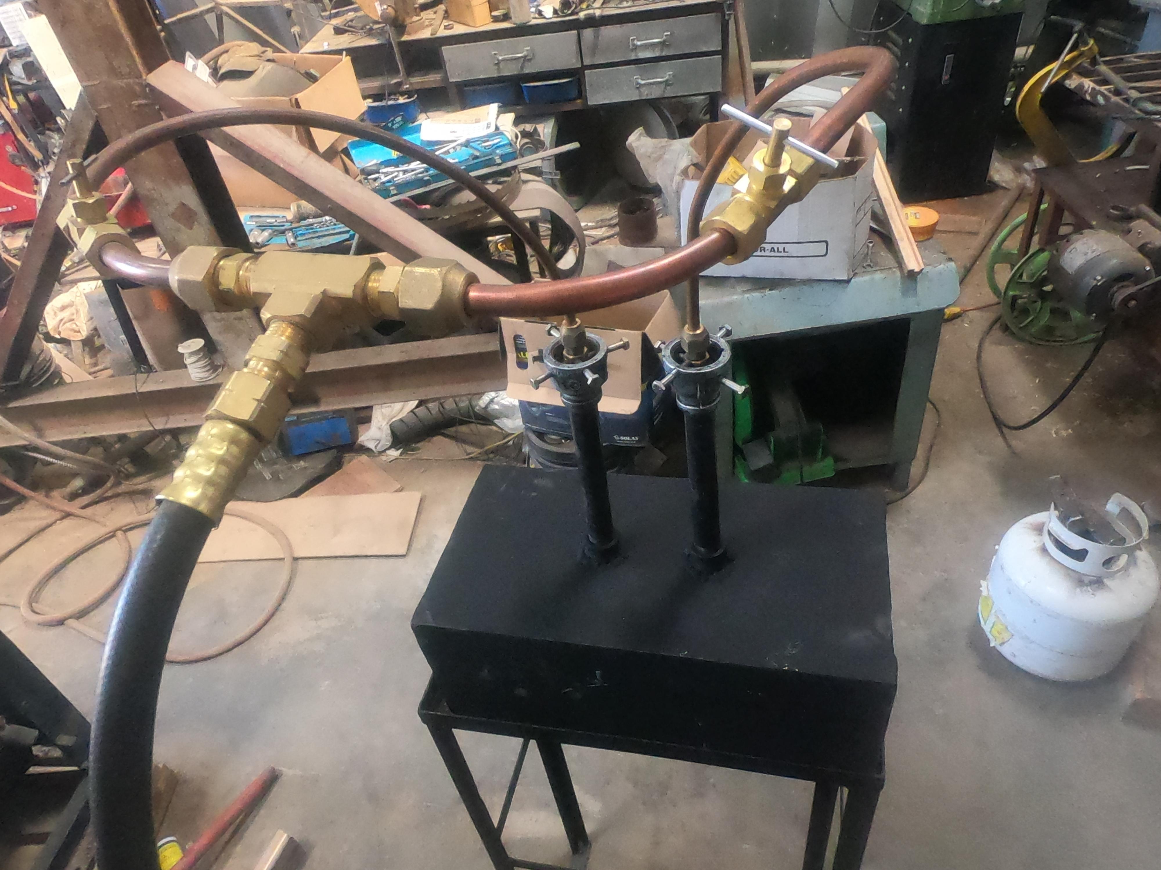

  3. I've run my home built for a few months without a regulator but like JHCC said I would be opening my needle valves more every 5-10 min to keep a steady flame so I went to amazon spent 30 $ on a 0-30 regulator it doesn't half to be fancy al it needs to do is give you a steady pressure to work with Marlyn born to smith forced to school

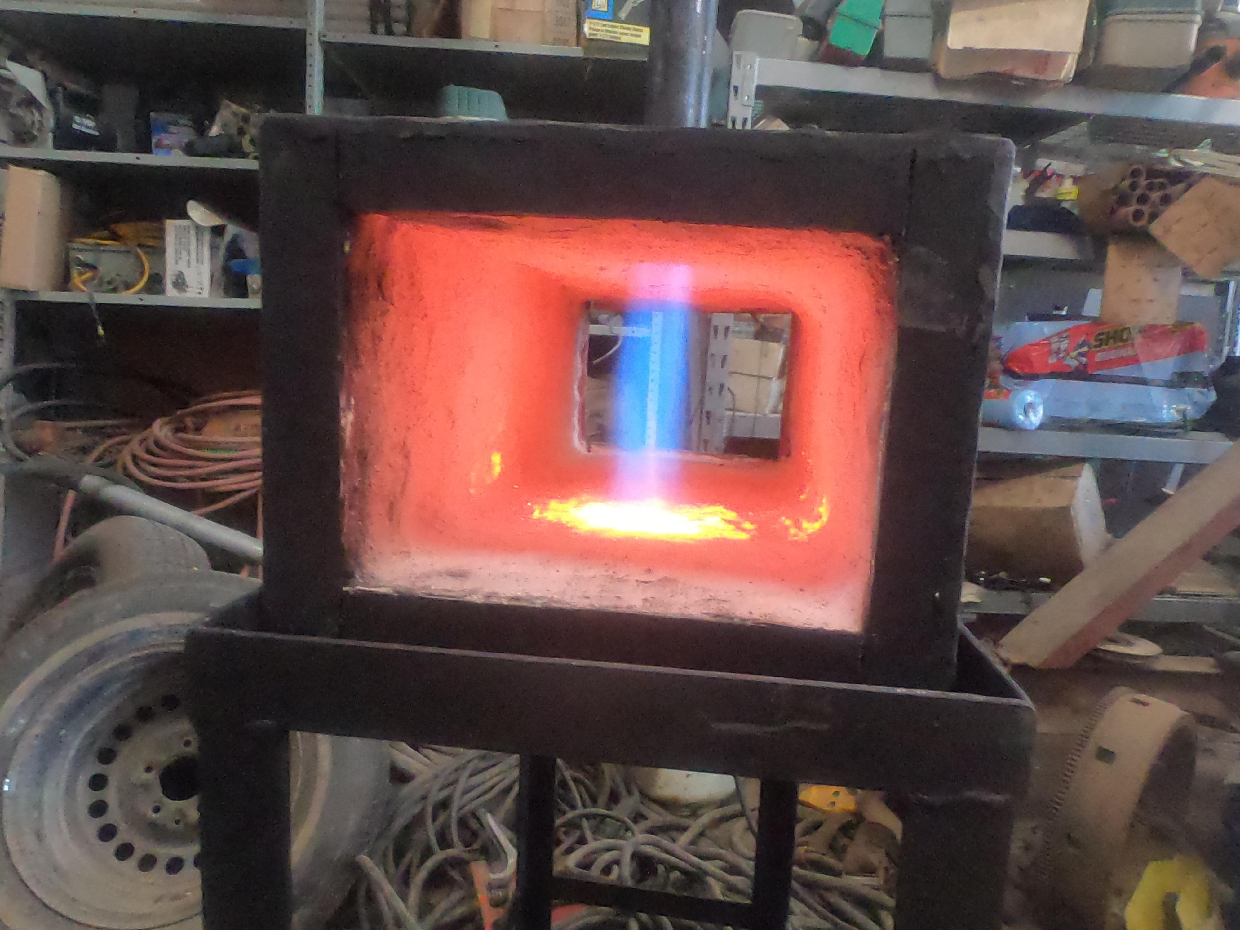

  6. heres the pic of it running. I have no regulator in the line so my flame slowly weakens till I swap to a full bottle again I tried with a regulator but didn't get enough pressure can you give me an idea to fix this im adjusting the t-valve every 5 min it seams to keep the flame the same

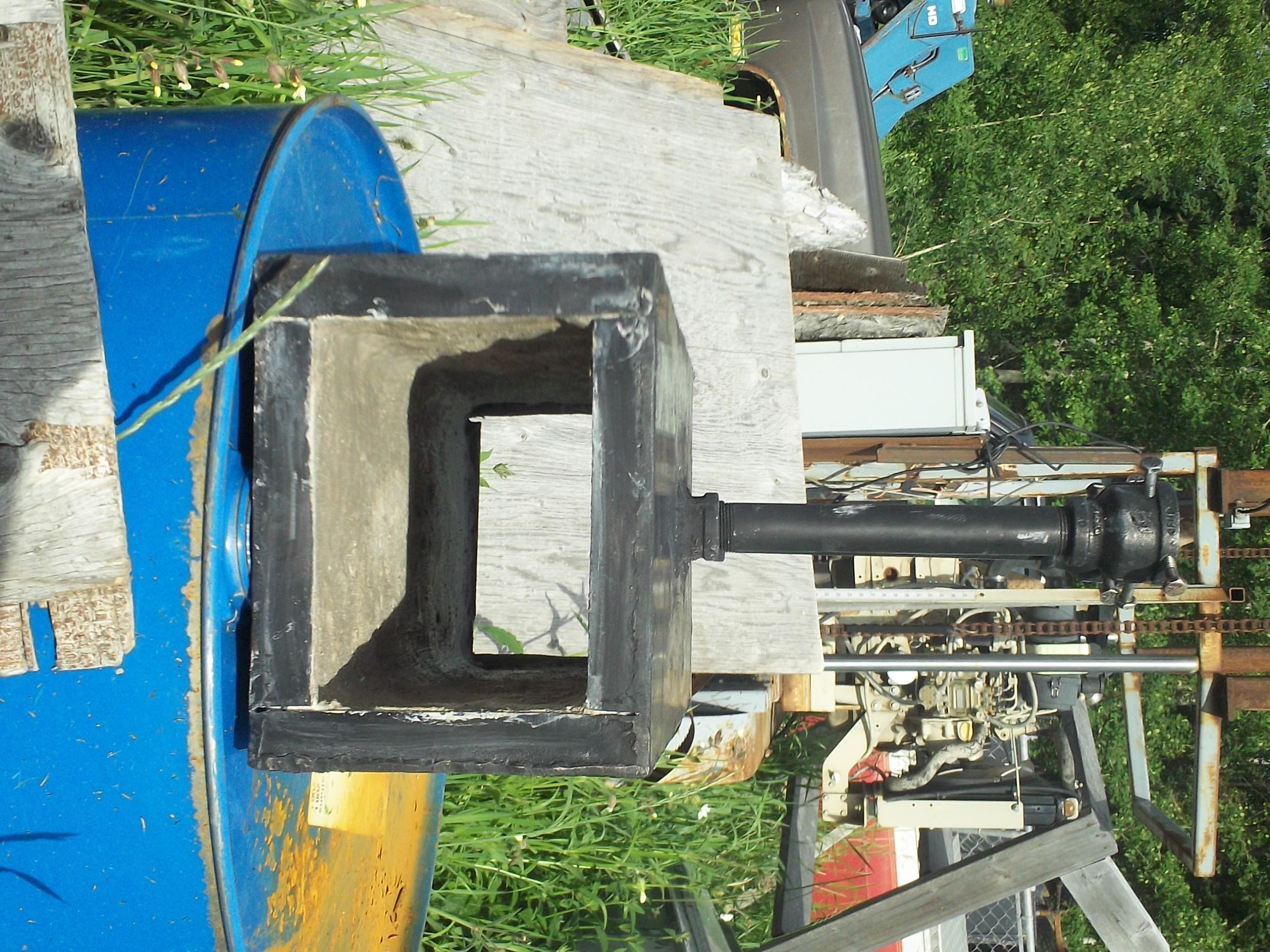

  7. sorry frosty I had to do some work so I wasn't able to finish posting every thing the forge proper= about 5x7x18" inside with 1" refractory wool and 3 layers of a 5000F rated refractory coating. on the outside is 1/8 sheet steel will try to post a pic later it dosent want to load right now
  8. So now 5 months, many hours of reaserch and 600 cad later i am ready to reveal my new forge to you guys. the burners = orfaces are .023 welding wire tips the top fitting is a 11/4-3/4" the tube is 3/4x8" pipe bottom fitting is 3/4 -1".

  11. frazer the ceramic wool is 1" 8# and the reason im asking is because if I put another layer of wool in I will only a space 3" tall and 5" wide so if possible I want to keep space open to make larger items ie. axe heads and hammers
  12. hello I'm building a forge with ceramic fiber blanket rated 2600F and coating it with a refractory paint rated 5000F. I am wondering if I should put 2 layers of blanket of if I can just put a third layer of coating thanks
