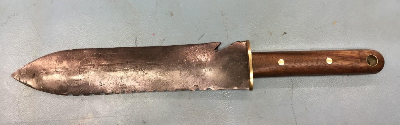

1. Metal stack was clamped, MIG welded across each end, and also once across each long side. All welds were then ground down to flat clean steel before welding on the tong stub, which was a short piece of 1/2" square HR. 2. Don't remember on the soak time. I turned it over just once, I think. I probably slapped it down on the anvil shortly after it was yellow-white and I was sure there were no shadows. 3. I would not recommend trying this with mystery or pitted/dirty steel involved. This stuff was all new and shiny, and I cleaned every layer very carefully. 4. Do not make the mistake of assuming I knew what I was doing. This was my first time, and it just happened to come out well. 5. You made a nice looking knife there! -

The billet was nothing special, I just was pretty careful in prepping it. The stack was made up of all new metal, alternating 1/2" x 4" wide strips of 0.035" 1095 shim stock and 0.049" 15N20, with a 1/16" strip of 1095 as the core. The first photo in the sequence above shows the billet (19 layers) after each strip was cleaned with acetone, stacked, tacked with a MIG welder, a stub added for the tongs, and after it was cleaned up on the belt grinder. I was really careful to keep the metal clean as I assembled the stack, and I ground the billet down to fresh metal on all sides after it was tacked together. After all that careful prep, the actual dry weld itself was kind of anti-climatic and was surprisingly easy to do. I had fooled around with borax on a couple of experimental billets and did not like using flux, mainly because it was messy as heck and cratered my forge's kiln shelf floor pretty badly. So I decided to go dry. I plan to try some more dry billets but have several knives for friends and family to finish up before I get back to experimenting. Also getting ready to add a VFD & 3-phase motor setup to my home built 2 x 72 grinder to replace the 1.5 hp single speed motor,which will give me some much needed speed control. Right now it's pedal to the metal at 3450 RPM or nothing. Thanks again for the hammer control advice, I'll work on it. -

Thanks for the nice comments. It is a beast of an implement, and should not be carelessly wielded, so I really should probably make a sheath. Never tried a wooden one, so what the heck, maybe I'll do that. Actually, the 1/2" brass tube lined hole in the handle is intended for hanging it on a nail in the potting shed or wherever, but it is pretty heavy and extremely sharp so should probably have something for a sheath. I'll also have to warn her that it's carbon steel, and like a horse should not be put up wet. Till now I'd never heard of one of these things, but they make a lot of sense, and apparently are very popular among the gardening set. However, some online research reveals a lot of QA problems with broken & bent blades, loose handle rivets, etc with the mass produced units. I already have my first order, the XYL (wife for non-ham radio folks) wants one!

Thanks, Les. And you're right, Frosty, if I was doing it again I'd make it into more of a Wharncliffe and put the edge on the other side. My wife and chief QA inspector already gave me one of those "why did you make an upside down knife?" looks about the handle when she picked it up. But, as I lamely explained, it was less intended as a real working knife as it was a dry-welding attempt. I tried welding a billet with borax and not only had delaminating problems, the danged flux ate a crater into my kiln shelf forge floor, which really torqued me off. So I'm going to try to stick with dry welds from now on. This one seemed easier to hammer out, I had no delams to speak of, and it left the forge floor in pristine condition. Heck, now that the idea has been planted, maybe I'll re-grind the profile and call it a semi-Wharncliffe. -

Thanks, Goat Lady! I had to work hard to get the image of the Hawaiian Islands into the pattern on the left side, but felt it was appropriate considering the Hawaiian Koa handle. -
Wow, nothing like following an artist like Templehound with a beginner project like this. Some of you may need to avert your eyes, lol. Anyway, this utility sort-of-tanto-shaped blade was not only my first try at pattern welding, to make it even more fun it was dry welded and hand hammered. 8-3/4" OA, 4-1/4" blade. 18 layers of thin gauge 1095 and 15N20, sandwiched around a 1/16" layer of 1095, for a 1" tall, 1/2" wide, 4" long stack. It was dry welded and not folded during welding. The handle is simple polished Koa from a small supply I brought with me when I moved here from Hawaii, and is pinned to a hidden tang with stainless pins. Several valuable lessons were learned in the process, such as don't heat directly in the flame path if possible - I think doing that created some scale/stains especially on the left side I could simply not get totally polished out (especially visible in the post-tempering photos). Tempering was 450F for an hour, and hardness seems fine, which leads me to believe the blue after-tempering color was probably caused by residual quench oil (another of many lessons learned). The biggest lesson, though, taught to me in no uncertain terms by my right wrist, is to start saving up for a small power hammer. 8 photos below, I resized them but hope I smashed them down enough.
