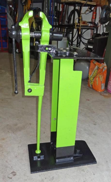

  3. Finally hit the local junkyard and built a stand for this little post vise. The floor plate is a very heavy section of 1" hardened wear plate from a large bulldozer blade (you can see one corner was worn down) bolted to 6x8 I-beam with a 3/8" plate on top. The vise & stand total a bit over 200#. I might have to eventually weld on a couple of "wings" of 1/2" or so plate on both sides of the dozer blade section for horizontal stability, but it is currently still a little bottom heavy, so is reasonably stable as is unless I REALLY get to jerking around on it, which is unlikely. I keep a cart dedicated to moving both the anvil and the post vise around, most other things in the shop are either bench mounted or are on wheels. Although I feel fortunate to have a decent-sized shop, it's still very crowded when I pack it all in and lock up for the night, thus my constant emphasis on equipment mobility. I'd love to build a new 40 x 60 metal shop building, but probably not gonna happen at my age. A shelter for the tractor and implements would be nice, though. I wouldn't mind leaving the truck and tractor out as long as they are under some type of weather shelter.

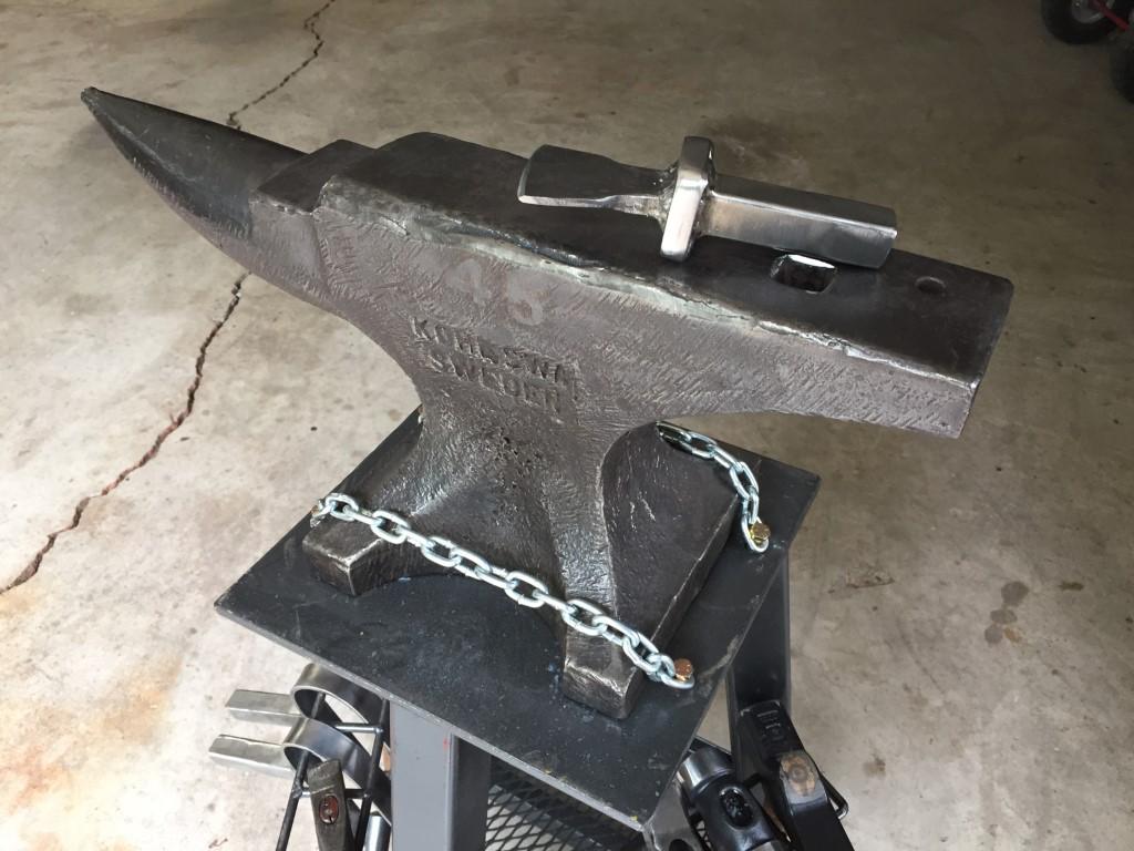

  12. Frosty might be right, maybe it's Sweden's native iron ore. Whatever it is, it works for me! Hard to explain that lively feeling of "springiness" when striking it, but it's there. Of course I haven't actually hammered on many anvils, so maybe they all feel that good, but for some reason I doubt it. I wonder if Kohlswa and Sodorfors are the only two Swedish cast anvils? CGL, it works both ways, Texas has handed us our rears a few times, too! That's what makes that annual game so much fun. It's a great rivalry, and the gloating and razzing is part of it. I really miss the old days when OU and Nebraska played on national TV every Thanksgiving Day. It was great to eat about 10 lb of turkey and then stagger into the den and turn on the OU-Nebraska game. A great tradition died when Nebraska moved to the Big 10.

  14. Looks great to me, MCB. Like you, I made my first hot cut tool today for my little 100 lb Kohlswa. It has a nice big collar (but it should, since it's welded up from 1/2" solid bar, lol). The blade was the business end of an old wide blade masonry/brick chisel. I shortened the cutting edge some, cut off most of the 8" shank, and welded the remaining blade a 7/8" hardy stub. I didn't bother to heat treat it afterwards, I was careful not to overheat it while cutting/grinding/welding and it's still pretty hard. If it proves too soft I'll torch it up and quench it later. Roll Tide (except vs my Sooners)!

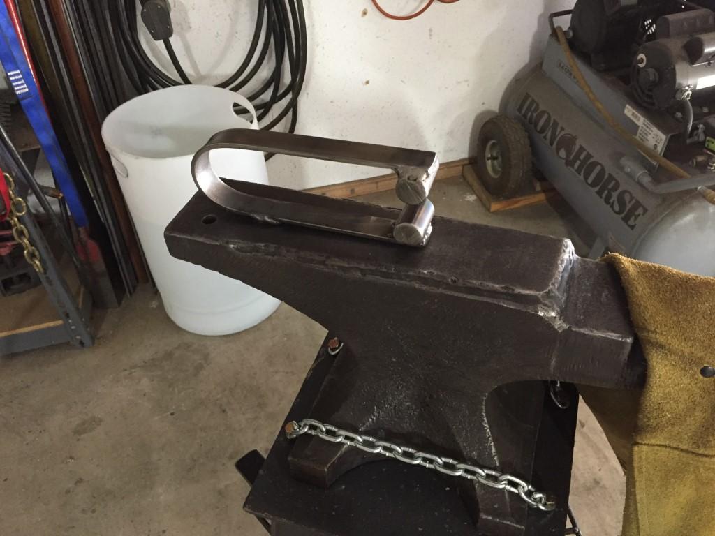

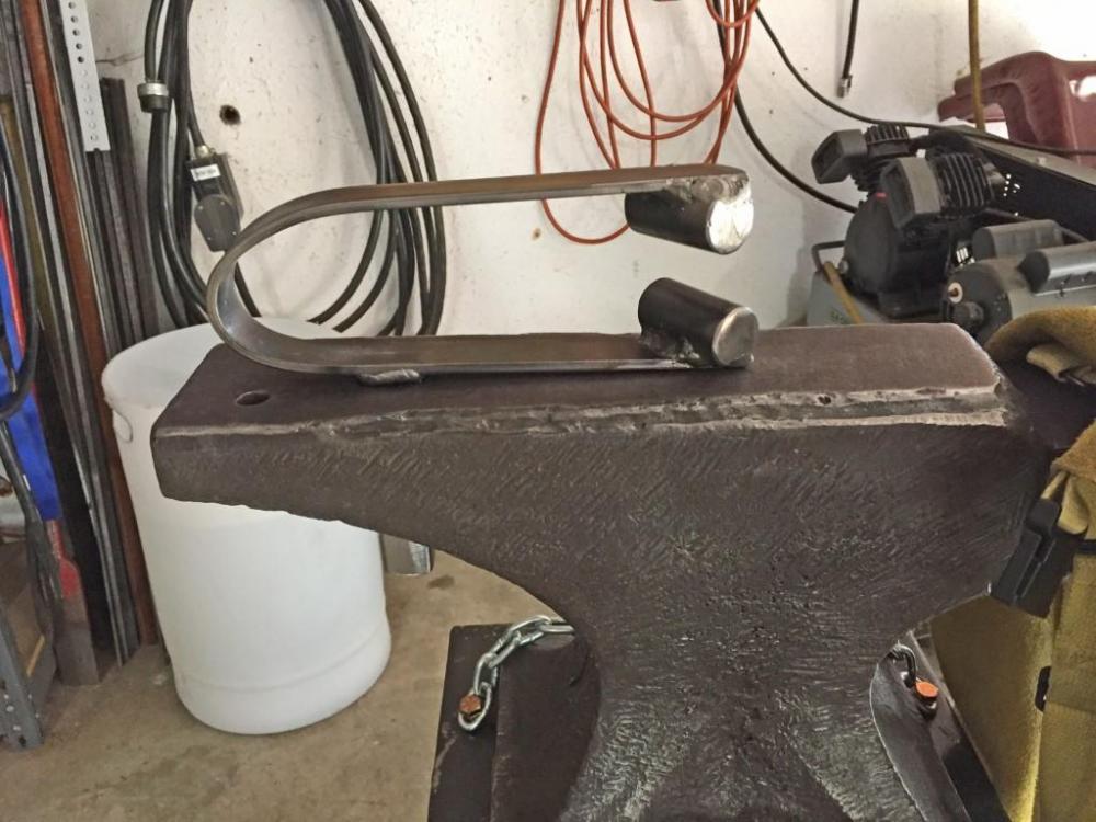

  15. Excellent thought, Mr. Powers. Thank you. That little light bulb had not glimmered in my mind yet, and I'll certainly remember it. Lord knows I'm not going to run out of tool/die material, ha. I was thinking also it might be possible to create a "spring hot cutter" along the same lines, similar to this second (angled) fuller. It would have a sharp chisel-shaped hardened upper die that would strike down on a partially flattened unhardened lower "anvil" die. The idea is to have an accurate hot cutter for small (1" and under) stock that would totally avoid risking damage to the face of a hammer or anvil. It was 102 inside the shop this afternoon about 4 PM. Even with two big fans running, it was no fun. I must have downed at least a gallon of water. That's why this second fuller was probably a bit less carefully built compared to the first. I'm ashamed to admit I got in a bit of a hurry to finish, clean up the shop, and get the heck back to the house for a shower, some A/C, and my favorite end-of-day brew, which is "Cave Dweller" from the Black Mesa Brewery in Chris The Curious' home town of Norman, OK. Rumor has it we have a cool front on the way, might even see some lower 90's later this week. I sure hope so.
  16. Just finished the 45 degree sister to the first one. Funny, I haven't seen any others like this with the angled dies... maybe it's a bad idea or something, ha. But I think I'll like using it more than the other one because it allows me to keep my tongs closer to my body in a more natural position, and the bonus is long stock will be easier to do. They both were sized lengthwise to place the dies in the anvil's sweet spot. Next I need to make a couple of different kinds of hot cut (regular and butcher), and maybe a bulletproof plate for the top of my poor victim anvil. And if anybody's wondering why my hardy base stubs are so long, it's to (a) knock it out from the bottom if ever needed; and (B) Someday I might get a bigger anvil.
