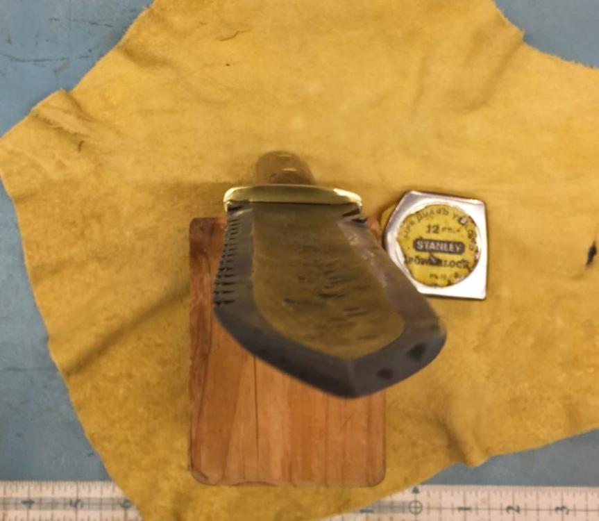

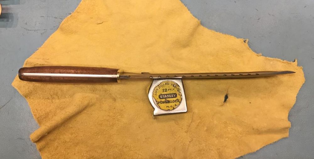

  8. Don't see a garden tool category, so I'll throw this in here, although maybe it should be in "What did you do in the shop today" instead. Mr. Moderator please move it if need be. Thanks. One of my sisters is a University-certified Master Gardener, who also teaches others. Her favorite all-around garden tool is the Japanese Hori Hori, but she uses her tools daily and hard, and has suffered a rash of broken/bent blades (from prying roots & stones) and poorly attached partial-tang handles that loosen up in use in the commercially available tools. Most popular variations appear to be rather cheaply made with blades stamped from stainless sheet metal, and they are infamous for having cheap and poorly attached partial tang handles. She asked me to make her a heavy use forged hori hori and forget making it pretty, just make it a bit oversized and make it tough. Making things that don't break and aren't pretty is right in my wheel house, so I finished this today. It's a full through-tang digging and prying tool, 15-3/4" long with a 10" blade, forged from 5/32" 1084 with scale left intact. It is about 2" longer and quite a lot thicker than the common versions. It's heavily front-weighted for chopping and digging, very sharp on both edges, and the serrations cut wood and roots quite well. The string/line cutter is also very sharp. Scales are riveted Koa. In keeping with the hori hori's evolution from a garden trowel, the blade curves slightly lengthwise, and is also forged concave in cross section for strength. I do not think she will break this one, and I hope she likes it.

  10. Thanks, Les. And you're right, Frosty, if I was doing it again I'd make it into more of a Wharncliffe and put the edge on the other side. My wife and chief QA inspector already gave me one of those "why did you make an upside down knife?" looks about the handle when she picked it up. But, as I lamely explained, it was less intended as a real working knife as it was a dry-welding attempt. I tried welding a billet with borax and not only had delaminating problems, the danged flux ate a crater into my kiln shelf forge floor, which really torqued me off. So I'm going to try to stick with dry welds from now on. This one seemed easier to hammer out, I had no delams to speak of, and it left the forge floor in pristine condition. Heck, now that the idea has been planted, maybe I'll re-grind the profile and call it a semi-Wharncliffe.

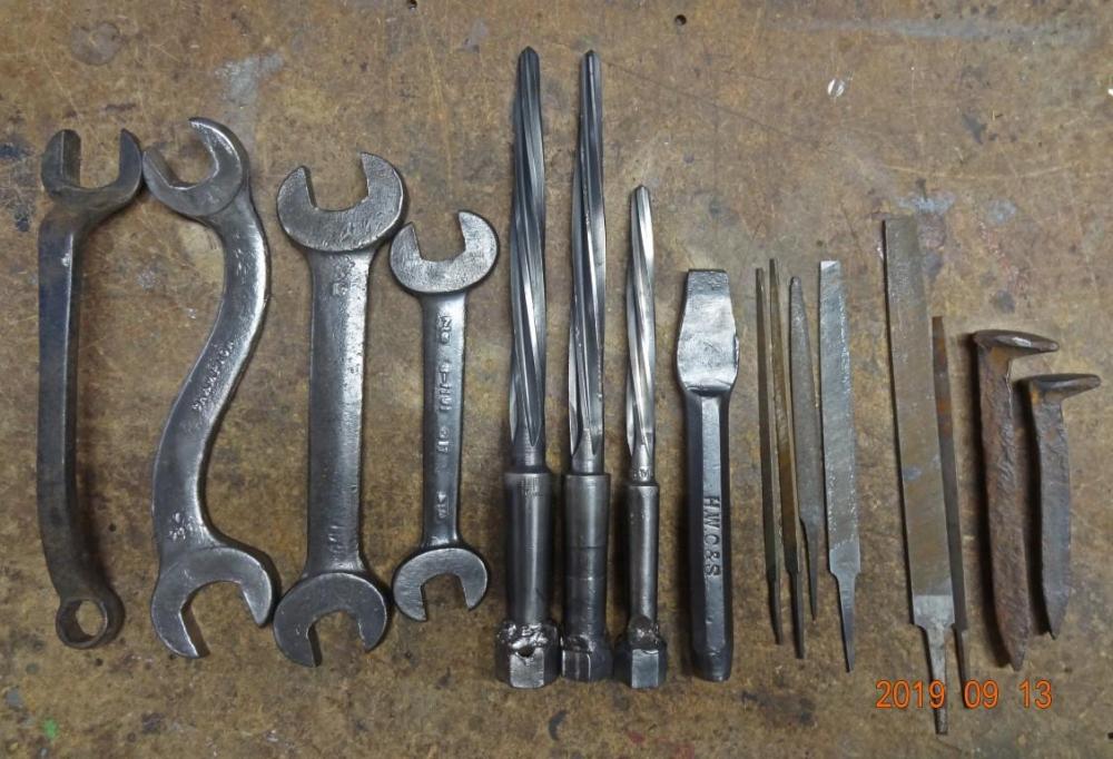

  21. Nothing very exciting for Show & Tell, but I did hit Goodwill for a bag of old tools. Left to right is a "special" combination wrench (sickle bar blade wrench?), 1-1/8 & 1" weird curved open end, 1" - 7/8" open end, 3/4" - 7/8" open end, a pair of 11/16" bridge reamers (one nice, the second one made in Brazil and pretty chipped up), a decent 9/16" bridge reamer, a masonry chisel from "H.W. C&S", four old Nicholson files, a pair of Japanese files, couple of RR spikes. There was also a rusty & frozen up 14" Stillson, and a small flat-jaw adjustable wrench (that one might be from a Model A took kit). I really wanted the lot just to get the bridge reamers and the two adjustable wrenches. The reamers have been crudely "converted" from taper chuck to hex drive, and whoever did it is one of those rare folks who is a worse welder than me, lol. I converted the Stillson and the monkey wrench into twist wrenches for my shop. Do old open end wrenches have any forging value, or is that stretching the "mystery steel" idea a bit too far?
