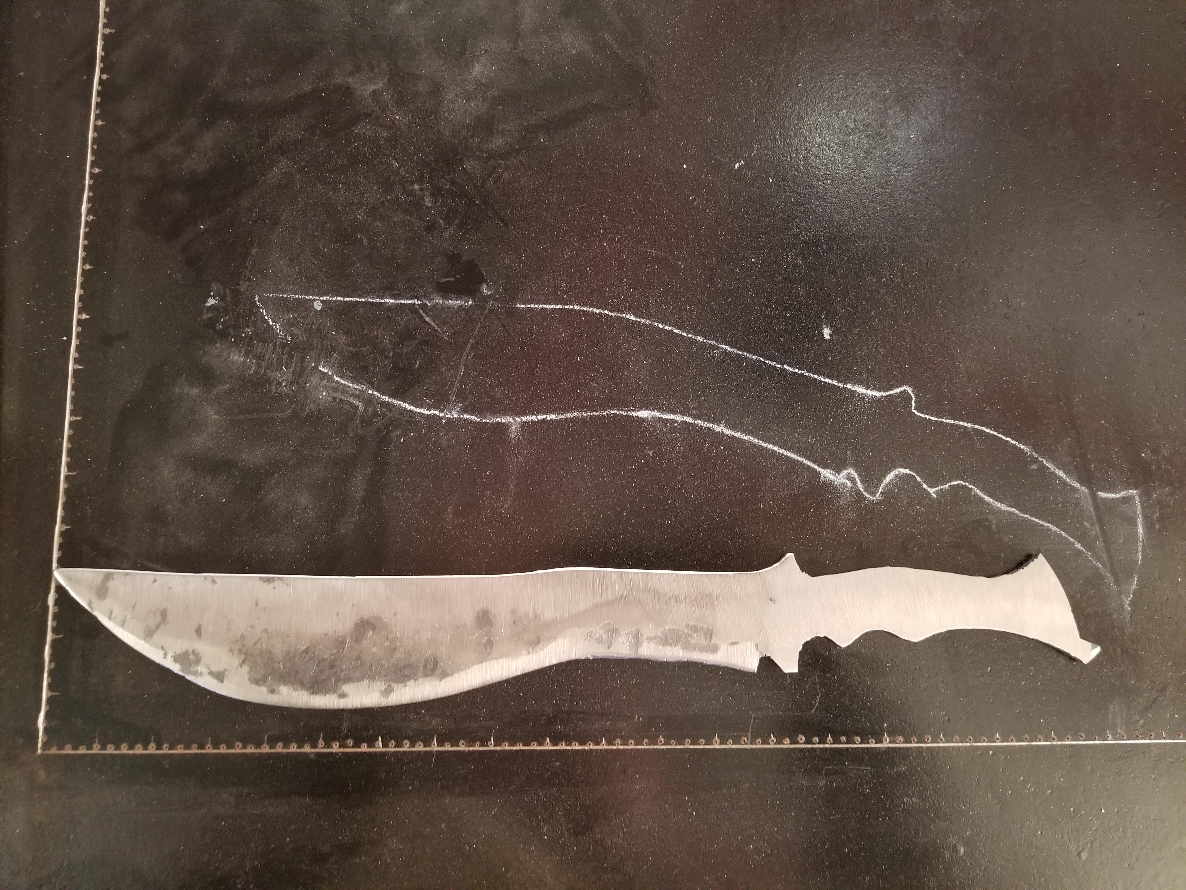

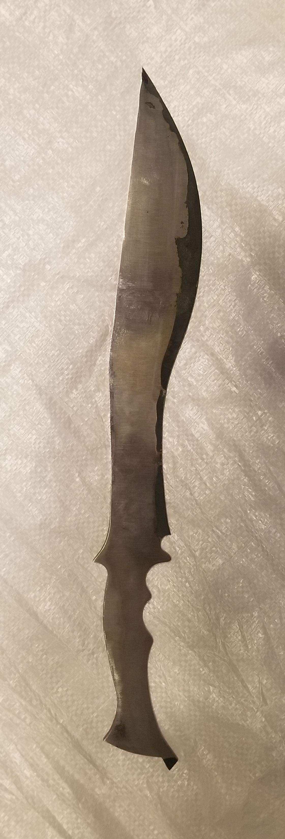

So instead of trying to grind the belly twist out, I bit the blade (har har) and got the metal hot again. It was relatively easy to get the belly of the blade properly straight (according to my eye at least), so I did some drawing on a 1in round for some tongs while I thought up a way to try and get the angle in the mid-blade without ruining it. I decided to make a little jig using two 1x3x12ish bars in a vise. I clamped the tang end of the blade between the bars just in front of where I wanted the bend. I then used a blowtorch to heat that spot in the blade before putting it in the forge, and I made sure the bars soaked up a good bit of heat to ease the leeching during clamping. This caused a hot spot where I wanted the bend, and with a little hammering, it finally broke over. The blade was straightened again using an idea from Buzzkill, profile ground, and scale removed. I am planning on starting bevels next weekend, and if I can get through the coarse belts to 200ish, I will normalize. The blade didn't take as drastic an angle as my pattern, and is closer to a real kukri I have in my display cabinet. All in all I am happy with where the blade is at, although I'm not as far along as I wanted to be today. Pictures below show the corrections.
Well I haven't done any heat treating yet. My concern was that grinding one side significantly more than the other would cause issues during hardening... going forward I am planning on grinding more this afternoon (finally on my weekend again) and seeing how it straightens out through the first few passes. I could put it in the vertical mill but that seems excessive. If I am not liking how it is looking I will just put it back in the fire. If the grinder does the trick, I might normalize tonight and harden tomorrow. Still up in the air on handle material.. I keep going back to bloodwood and gaboon ebony. I also like the idea of cratemurtle and gaboon ebony for the contrast. I will post pictures tonight for an update on my belly twist and how it gets fixed. I appreciate your reply/advise Scanlan, and will try it out.

I just got done making a multi-port gun forge, and I have been wanting to make a large kukri (sp?) to use at work. This is the largest knife I have made yet, and first attempt at a kukri. I started with a .250" x 2" flat bar of 1095 from NJ steel baron. I cut the opposite angle off for the tip and stretched it back down. I am not sure what that process is called, but I am a fan of Walter Sorrell's and emulated one of his knives in this regard. The overall length is 18 inches. The belly was drawn out, and I tried forging in the bevels some. These steps went fairly well. Two major failures.. First and most frustrating was the failed curve in the mid-blade. I tried and tried to get it to happen, and all I have to show for it is the slightest angle change. The second failure was a twist that developed while drawing out the belly. I thought I had it corrected, but found it to still exist when inspecting the blank today after grinding scale off. The handle was roughed in on a band saw. So I have some questions, first being how do yall get the blade to have that beautiful change of angle when making a kukri? I thought of using one of my solid fuel forges to make a small hot spot and hammer the spine to get the steel to expand there.. I just dont know how else to go about it from a flat bar.. Second question: will grinding the minor twist on the edge half of the belly cause a warp during hardening since one side will have seen so much more belt? I have tried thus far to hammer and grind both sides evenly. The pictures are from post-forging with most of the scale ground off so I could see a little better. Black table is pre-profile grind, brown table is post-profile grind. The edge picture is an attempt at capturing the belly twist.. not a good attempt as it turns out.
