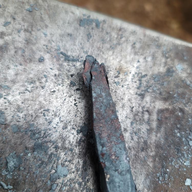

  15. Ta-da! One wrought iron S hook. Not perfect, but not bad since I haven't made one in forever and it was fun playing with the wrought iron. I learned with this particular bunch that I have anyway, that it can be forged at a lower heat. But you can't wail on it and you have to work it quick and then back in the heat. If it's not hot enough, as has been said many times, it wants to come apart. This started as a fairly big piece of material and this is what I ended up with, so it reduces in mass by quite a bit. Fun stuff. Ihighly recommend if you haven't tried forging WI, do it if you can

  17. Among other things, I was playing around with forging a little piece of the wrought iron wagon wheel I have. I started at a lower temperature and sure enough, it started splitting real quick. Just got it up to temp but had some technical difficulties so I'll get back at it after awhile and see about getting it good and hot and explore further. I've never forged WI before but it's a very cool experience
