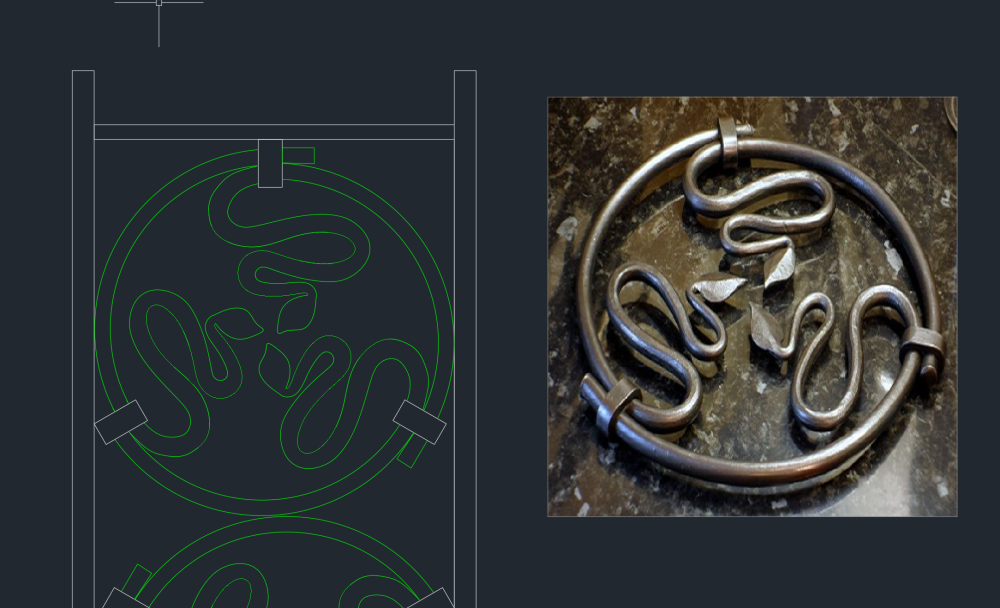

  1. Forced myself to go out to the forge on this cold, wet grey day and do a little work to move this project forward. Current situation as pictured. Still need to do the clips and then some cleanup and then finishing.
  2. Productive day in the forge, while the rain trickled down here in CLE. Current progress.

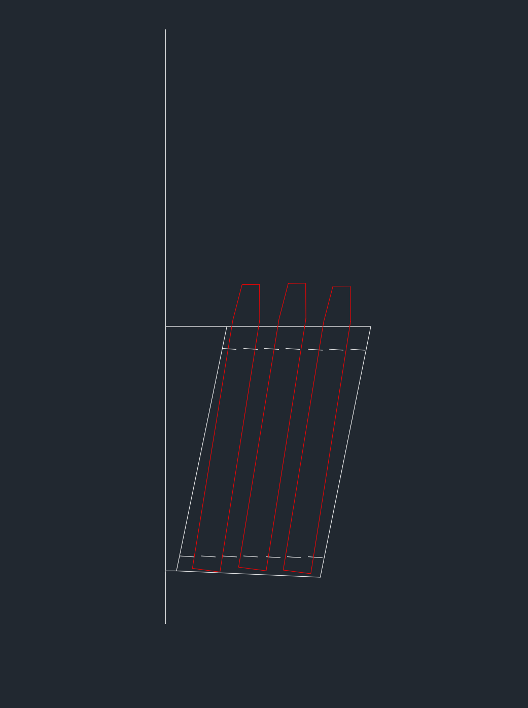

  3. I think some of you may be missing the point. The "4-digit" precision on my drawing is not to imply that I require that kind of precision. It's simply the thickness of the taper at that particular point, and AutoCAD defaults to 4-digits. I just didn't bother to adjust the precision before I created that screenshot. Nobody is going to be throwing a caliper (digital or not) on these pieces. Having said that, and since this thread has re-animated, I'll provide a status update. I've finished the tapering step of the piece. As stated above, I milled spacers to the dimensions shown on the drawing, and used them in the jaws of my forge press to ensure I didn't oversquish at those points on the taper. Here are the spacers: This obviously created a stairstep taper, starting at the original stock size of 1/2" and ending at 1/4". I left a chunk of metal at the ends for material to forge a leaf. The next step was to grab a hammer and smooth out the steps. Then go to octagon and finally round-ish. I wanted a rougher finish than the original design I'm copying, so I left some of the octagonal edges in place and then hit the tapers with a belt sander to provide a more hammered look. Here are the three pieces: The next step will be to forge the leaf on the end of each, and then bend the curves for the actual piece. If I haven't mentioned it previously, here is what I'm aiming for:

  5. I'm starting to amass more of these tools than I can easily store. Actually, that's a lie...I haven't even been attempting to store them, they're just laying (and rolling) around on my various workbenches and shelves, getting lost and interfering with my workflow. Please weigh in on how you store your drifts and punches. I saw that John at Black Bear Forge uses a large wooden cabinet with shallow drawers, and I guess that's an option, but I'm not looking for a cabinetry project at this stage. I'm considering building something that hangs on the wall with two layers of 1" chicken wire at this stage. Here's a side view of what I'm thinking, and it would be as wide as I need. I could also add another layer above/below it, if the tilt is correct:
  6. These will be a one-off. Trust me, if I had a lathe, this would already be a done deal. Thank you to everyone that's replied. It's interesting to see the two camps, the "Do the math" guys and the "Grab a hammer and smack it until it's right" guys. I appreciate the math involved in this work, but rarely has it ever worked out correctly for me, which is entirely due to my own mistakes, I'm sure. Here's my plan: I don't have access to a lathe, but I DO have access to a milling machine. And a hydraulic forge press. The press jaws are 3" deep and are obviously parallel. I re-drew my original CAD drawing with 3" long steps, each step reducing in height by the distance required to stay within the taper outline. I measured the height of each step every 3" and will mill a pair of spacers to constrain the press to that thickness. Hopefully, when I'm done I'll have something approaching this drawing. I'll then go back and smooth out the steps. Should this not work, I'll be attempting the BillyBones/Hefty approach, as I finally understand it (after reading it several times).
  7. I'm not understanding this statement. Can you explain? FYI, I plan to start with 1/2" square bar, since squaring the round stock would be the first step anyway.
  8. Been looking at YT at taper technique, and all say to start from the point and work back. But a 'long' taper on these videos is something like 4". I have a need to make a 30" continuous taper, eventually finishing as round, ending in a leaf. I threw it into CAD to get the numbers and it comes out to about 3/32" of a taper per foot. Suggestions for order of operations would be appreciated.
