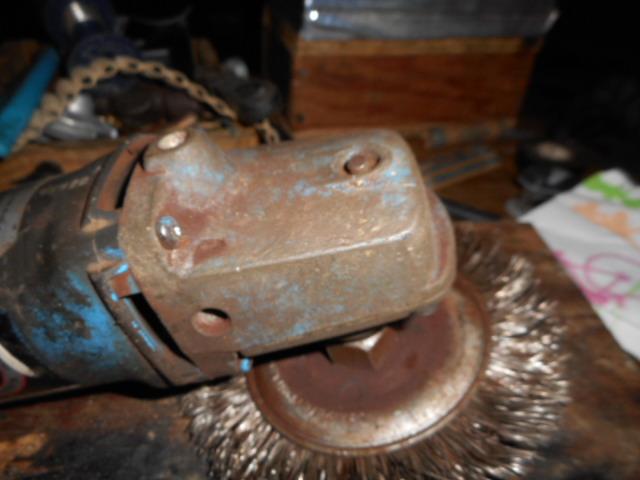

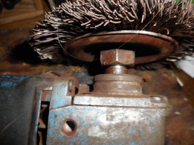

  13. i checked prices for a new housing, the lock button is not replaceable,,have to replace the housing http://screencast.com/t/5EoIeGtfvLv those parts new are more than the unit was new,,,, no way.... i think i will pack if full of grease,put the wire wheel on it. and use it scour the local pawn shop for a broke wore out one and get the housing,, off of one that i find,,glad i have 2,
  14. got the wheel off, took it apart, the pin is bent, metal shavings inside the head and chipped teeth

  20. darn,,,,me and this grinder go WAAAAAY back...i rescued it out on a tool box ful of water, tore it apart and hand sanded the armature it has been running with no problems for neigh on 15 years think i can grind the jaws of some vice grips thin enough to lock on between housing and nut? like DSW has suggested with plyers?

  22. I have a couple of black an decker 4 1/2'' grinders,, my oldest a model #2750 the lock button seems to be broke,,http://screencast.com/t/PLO3tRUD0 my question,,how do it get the wire brush off of the spindle to access the head to look at the broke button? with out going med-evil on it, any suggestions?
