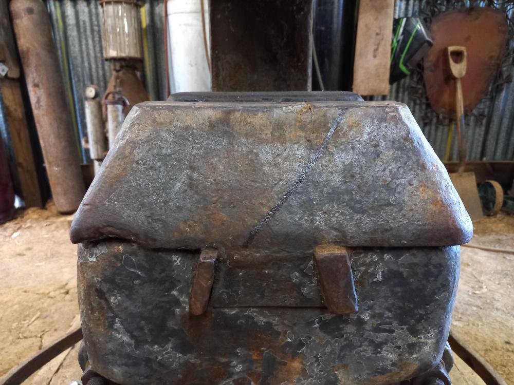

  2. I got the top block hardened but I had to bring it back a bit as it was too hard, if all goes to plan the hammer will be running tomorrow.

  7. Getting one new bottom sowplate key made and I had a chemical analysis done on top block witch turns out its mild steel, took that to to heat treatments to get some carbon put into the face, It has lasted a very long time not being hard, this might help it but it might not, I can always get a new block made.

  10. When I was driving the bottom block key out the side flaked off the hand hammer with such force it put a ding in the wall.
  11. Now the hammer can actually function as it should.

  17. Getting a new sowplate made in 1045 steel, I am getting it made 2" higher, also had to grind the top block flat on its face and I am making a new dovtail key as it had some hand forged rubbish. The new sow plate is costing over 3/4 of what I payed for the hammer

  19. The hammer has been set up for some kind of tooling, I suspect the sow plate has been lowered, the dovetail in the sow plate is damaged and beyond repair. Its actually worse than it looks, thats compacted scale and oil making it look solid, it just crumbles away, I am going to see about getting a new one made, is there a chart for dovetail sizes ? Would be good to give the info the shop doing the work,
