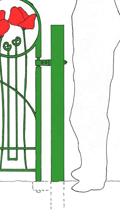

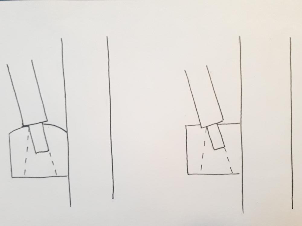

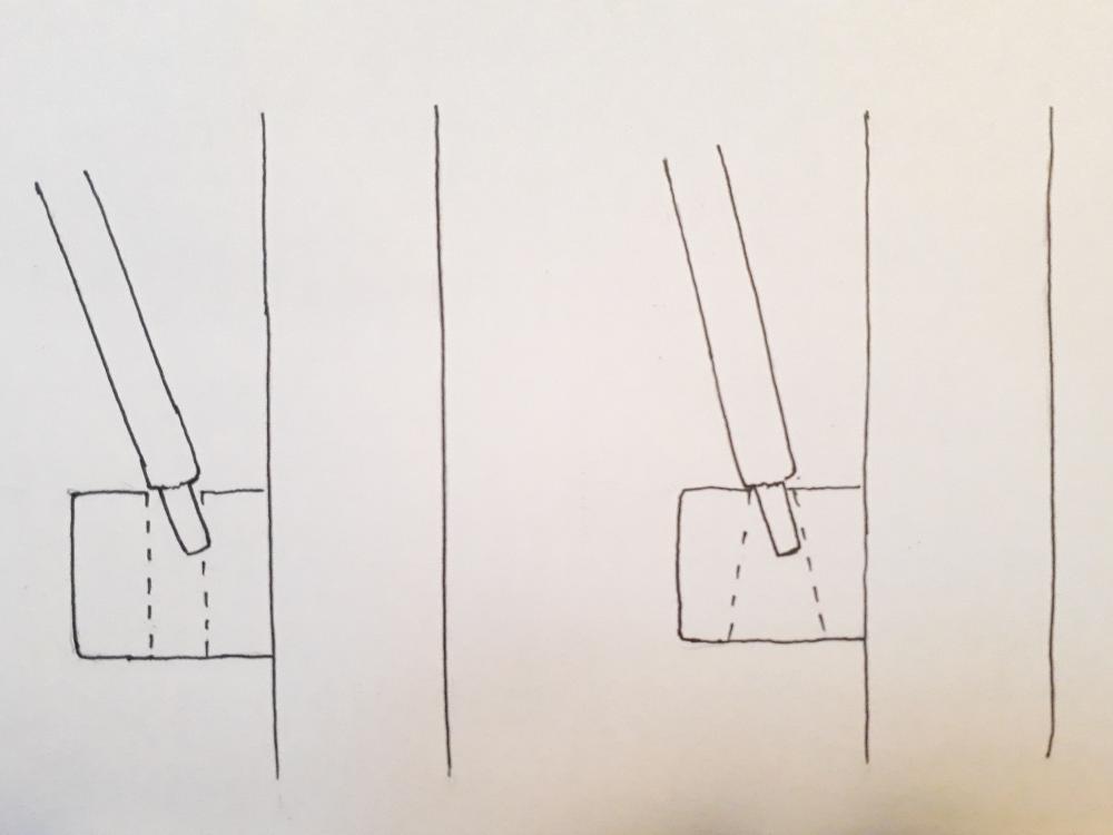

Thanks for the replies folks. The horizontal drilled U sounds like a neat trick Marc1 - and the tenon length VS socket depth info was golden billybodgeit - I had assumed the sockets were really a tunnel so that water would drain through. The socket being above ground level makes complete sense. The posts will have square plates welded to the bottom & they will get bolted to concrete pads. The plates can be shimmed to level up the post. I think the socket will just be welded to the 100mm round hollow post, 5mm wall. For the top hinge I'm going to weld in reinforcing SHS to prevent the post from crushing as the nut is tightened up. The first part of the journal shank will be square (to prevent rotating) before it's rounded up & threaded to allow for adjustment on the backside of the hanging post.
Pretty much, unless you shimmed between the tenon & socket to bump it up in height. For the gates' site it's the best hinge arrangement.
Hello folks, I have some questions relating to the ground level tenons & sockets on strap & journal gate hinges. I haven't used this type of hinge system before but am due to use it on some gates I'm making soon - close up from design attached. In the accompanying sketches I have exagerated the angle of the gate back stile for sake of explanation. Due to site circumstances the socket will not be independent & will be welded to the gate hanging post, meaning the only adjustibility will come from the top hinge. In the event of needing to adjust the gates angle it will cause the tenon in the socket to tilt. I want to avoid the tenon binding on the inside of the socket & also avoid the tenon shoulder binding on the top of the socket. Is it common practice for the holes in the sockets to be flared & the tops of the sockets to be rounded over? I could alternatively make the shoulders on the tenon rounded back & taper the tenon.

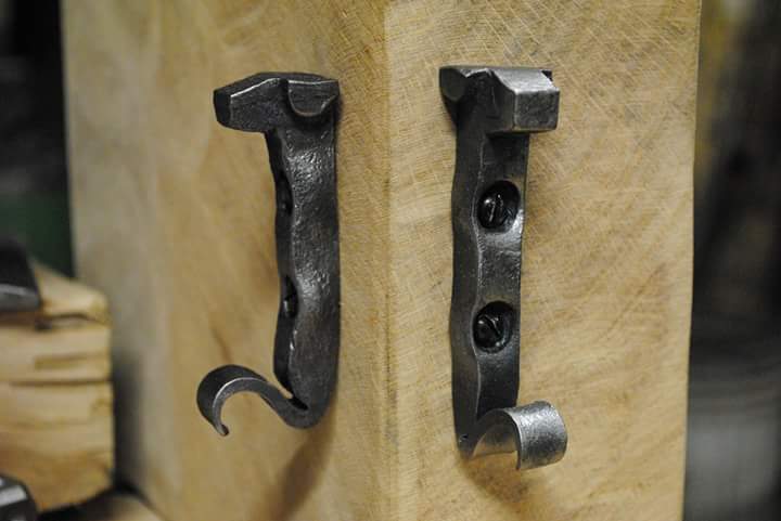

I have a local light gauge railway that I buy small size scrap track & spikes (dogs in the UK) from. At Christmas I made a few screw-to-the-wall bottle openers from some of the dogs. To my mind the dog heads have the defining character so my design keeps that intact. Bottle goes from angled to vertical in the opening process so no beer is spilled.
