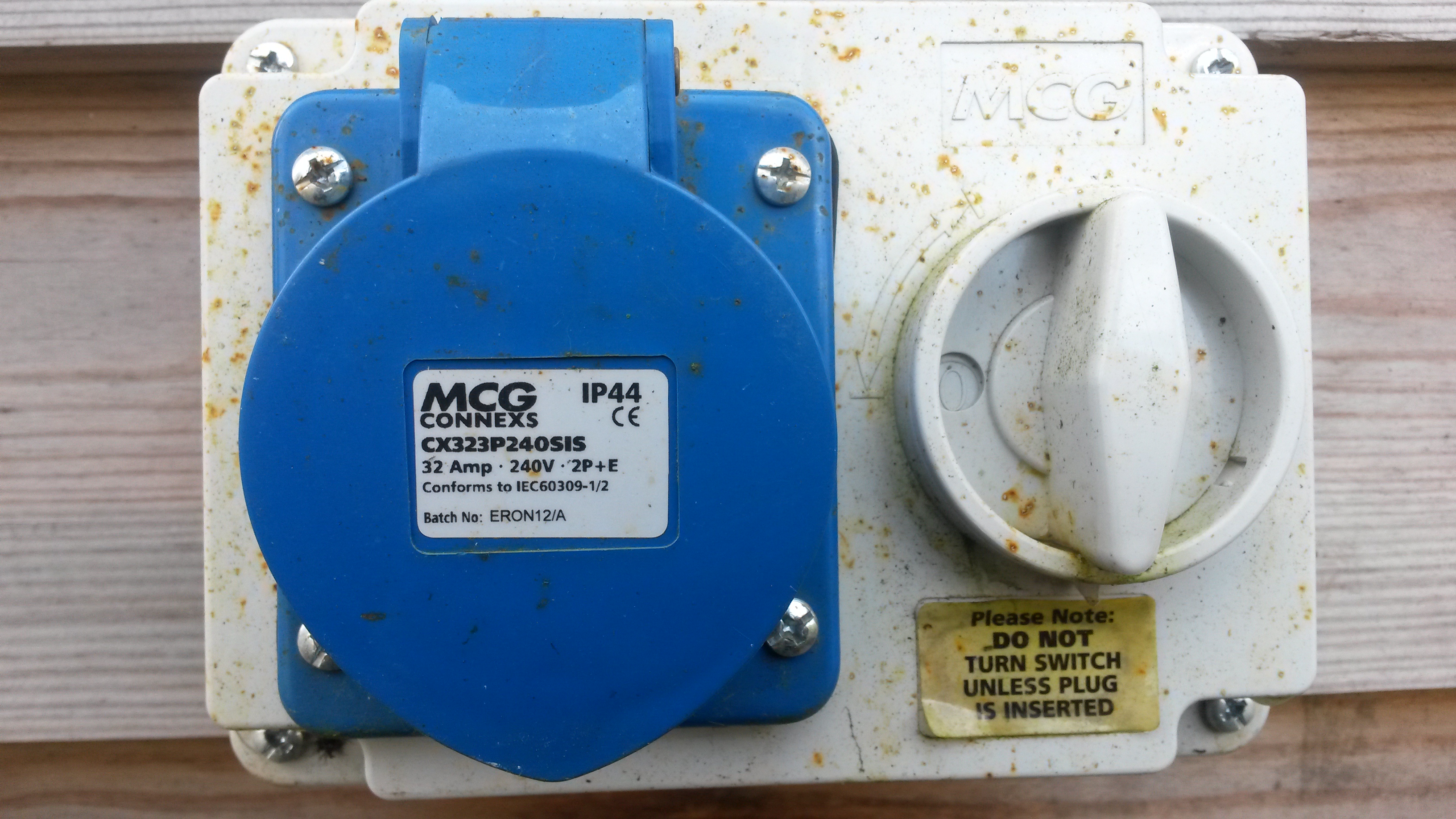

  20. Cheers. There will be 3 phase elsewhere on the estate but not nearby unfortunately. When I used to work out of a shack in my parents' garden I used to run my welder off one of these sockets we had an electrician fit to the exterior of an office that was nextdoor. Can these sockets be fit anywhere with single phase or do the planets need to align in a certain way to allow it?
  21. Hi folks, please excuse my ignorance and diverting the thread but this is a very relevant topic to my situation, so if I ask my question here it will save me clogging up the forums with a very similar thread... I've got my foot in the door at a new workshop but it's only single phase, I don't have a power hammer or compressor at the minute so am just running grinders, small inverter arc welder, drill press, forge blower, radio, lights...but can foresee myself wanting some a small power hammer and compressor at some point. What's actually involved in going from single phase to 3 phase? Is 3 phase actually needed for those things? I'm aware of single phase power hammers. I'm ashamed to say my knowledge of electrics is next to nothing. The workshop location will be fantastic for my business (in the grounds of a stately home that's open to the public, my workshop would be next to a successful green wood craftsman who regularly has visitors and the rent is cheap) so I'm really hoping the electrics situation isn't going to be a problem. The workshop is in poor repair at the minute and needs a few months of work to make it ready so the estate manager has asked me for a wish list to bring the spec of the workshop up to scratch for what I need (door sizes/floor/position of windows etc) but this won't include putting in a 3 phase supply so that cost would fall to me. Apologies blackleafforge.
