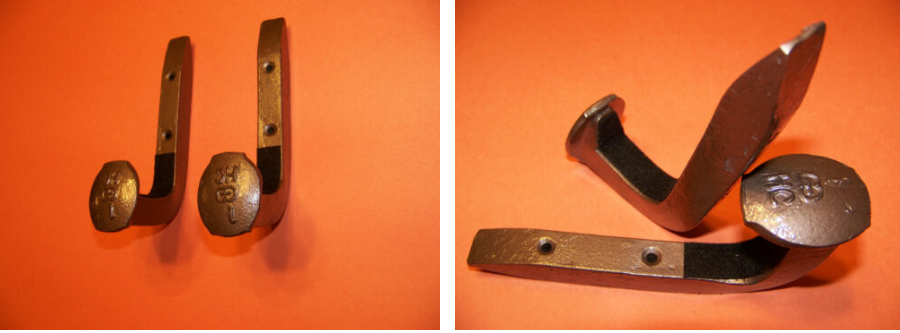

home_on_the_range Posted October 9, 2020 Share Posted October 9, 2020 (edited) I'm planning to bend a couple to use as a mount for a 1981 John Wayne Commemorative Winchester 94 rifle in my Man Cave, see example photo Edited October 9, 2020 by Mod30 Remove excessive quote. Quote Link to comment Share on other sites More sharing options...

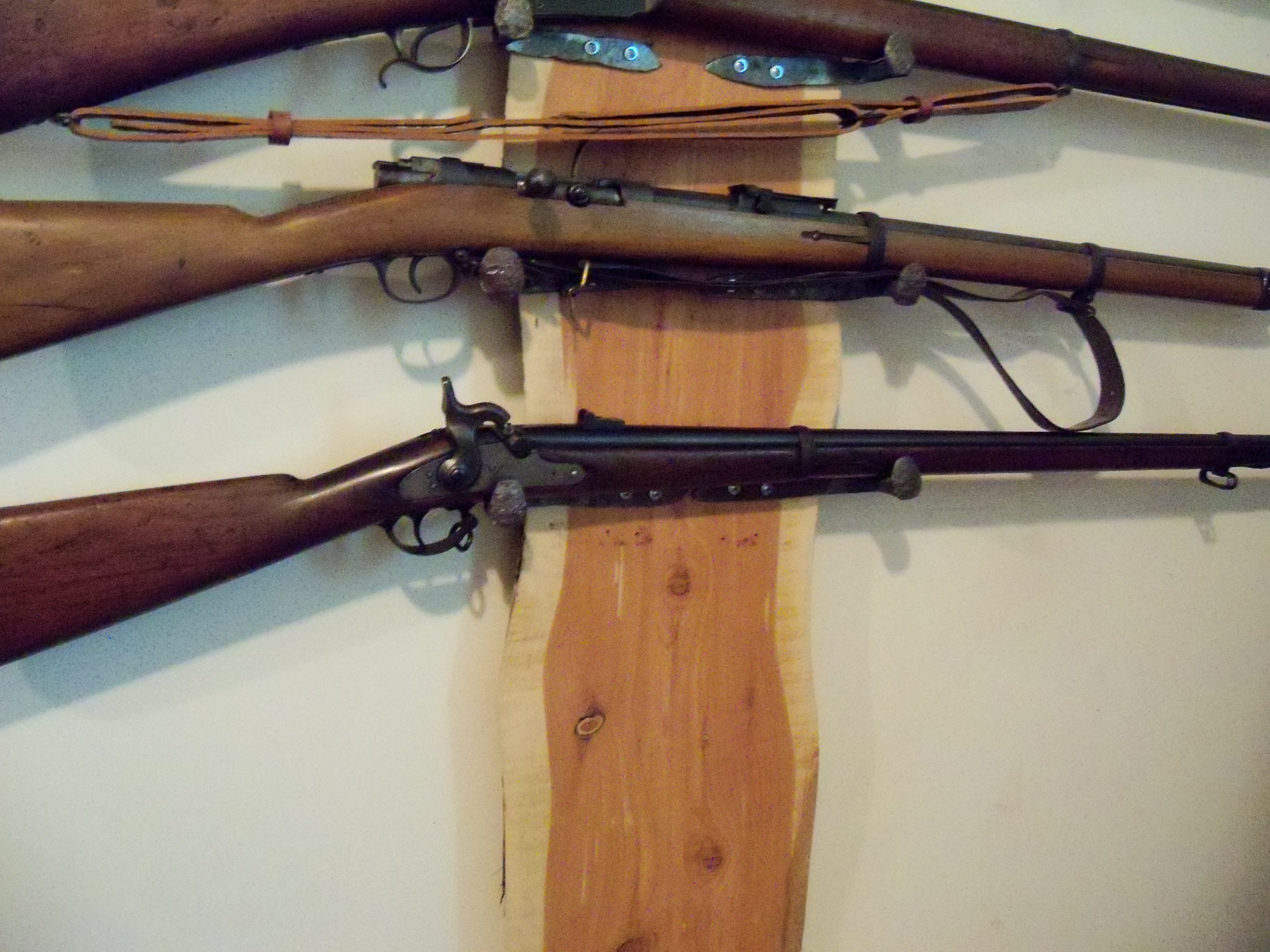

Irondragon Forge ClayWorks Posted October 9, 2020 Share Posted October 9, 2020 Kinda like this. Those spikes are a lot older and low carbon. the rifles are a lot heavier than a Model 94 and they haven't budged in a long time mounted to a rough sawn cedar slab. Quote Link to comment Share on other sites More sharing options...
ThomasPowers Posted October 9, 2020 Share Posted October 9, 2020 Good use; I just have a thing about folks making knives from mild steel. Quote Link to comment Share on other sites More sharing options...
