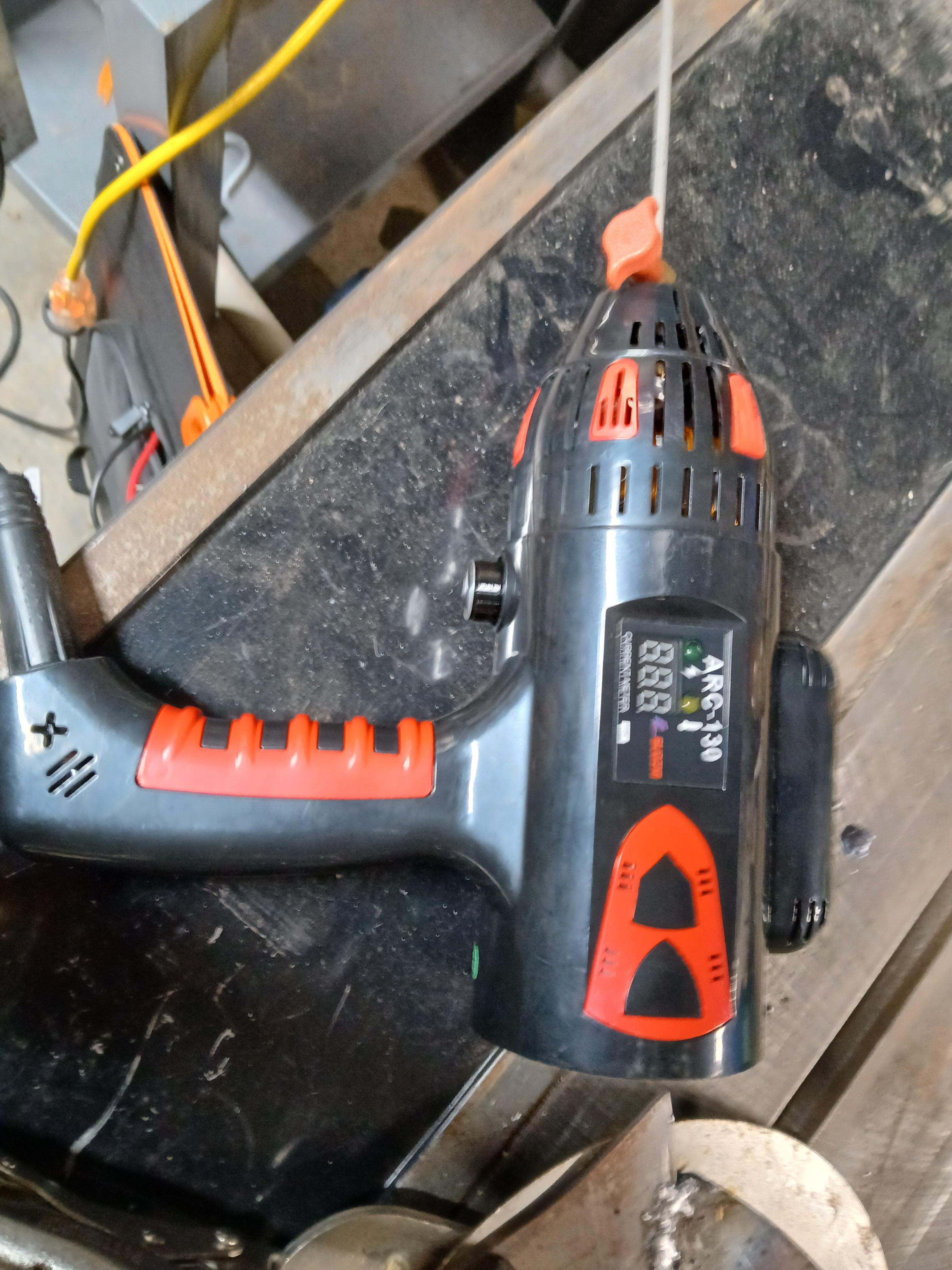

I saw an item on marketplace that intrigued me.  A handheld, portable stick welder.  I googled it, and found it on sale for 70 bucks at a popular online retailer.  I ante'd up my 70 bucks, betting it might just work.
image.thumb.jpeg.4a8d0277cdf8e0e4dbe7106f04c57372.jpeg20250330_070225.thumb.jpg.4a629667d41a63100ac0e81cacc1eae1.jpg

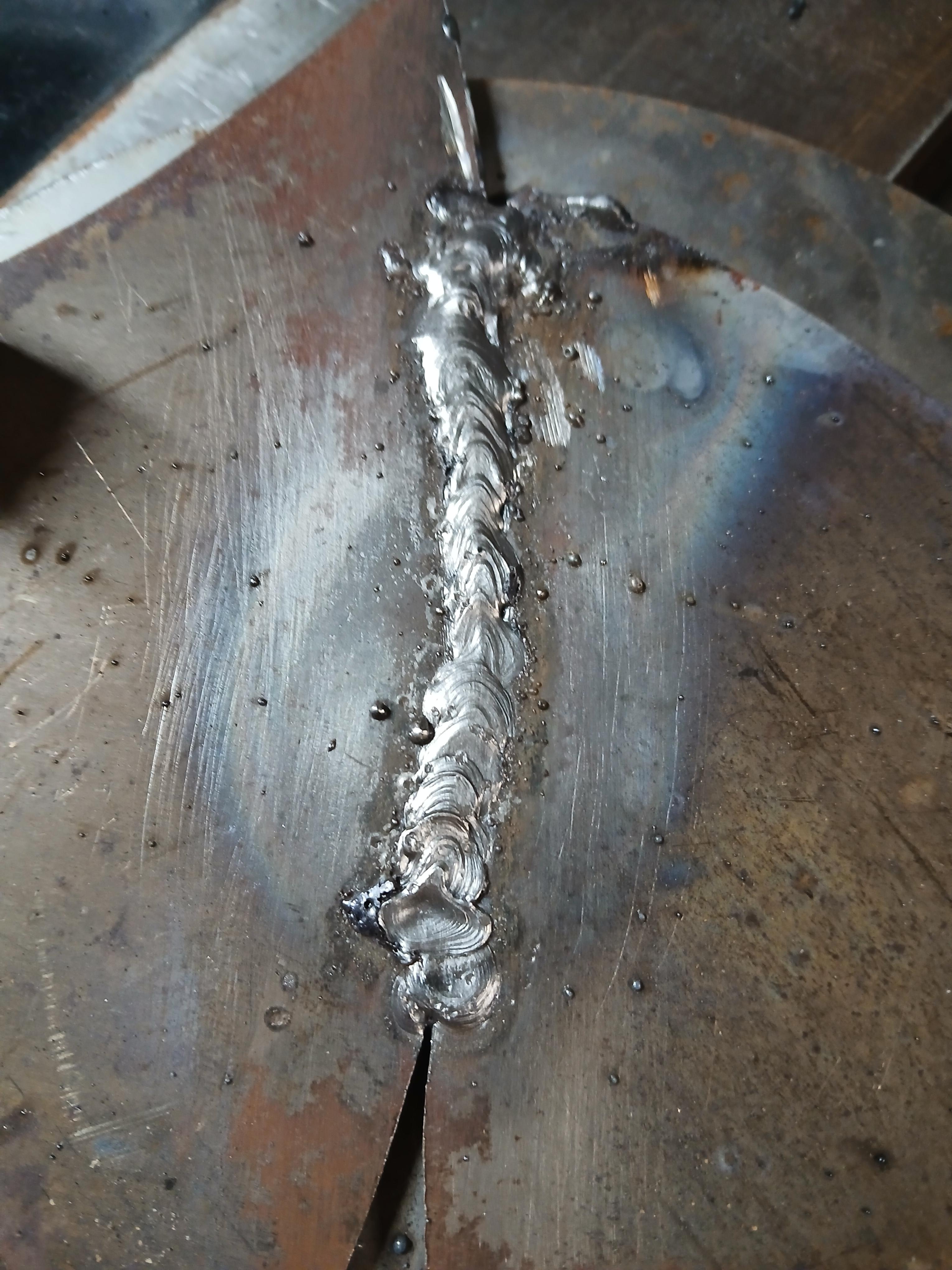

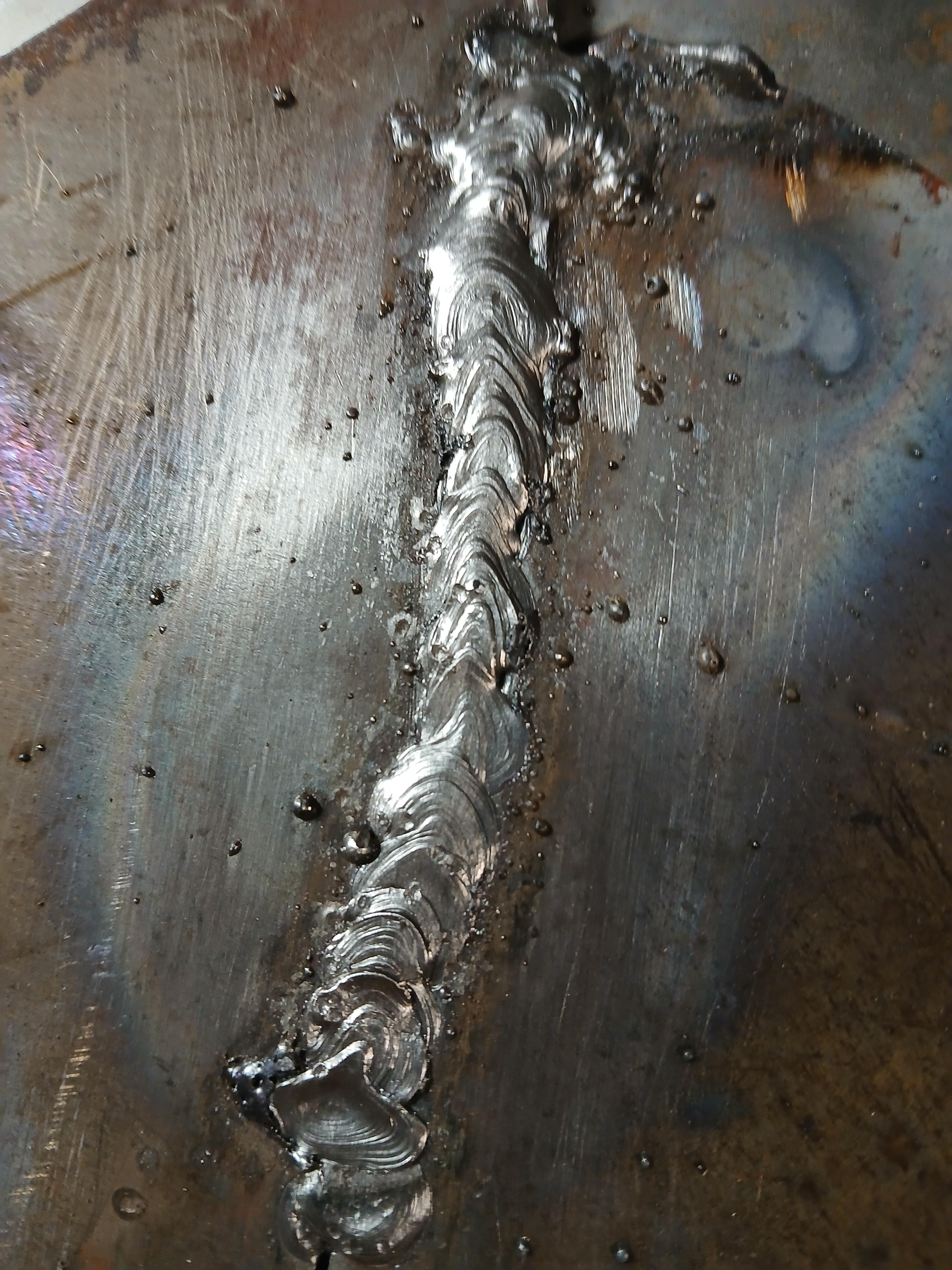

It plugs into a 110v outlet and is supposed to be capable of up to 130 amps, 1/8" rod or smaller.  It really does sound like a hair dryer on low when it turns on.  The unit has cooling fans in it, drawing air from the rear, through it to the front.  I cleaned up the edges of a couple pieces of 1/8" scrap steel.  Then I gave it a shot at a butt weld.  Mind you, I have not tried to stick weld in 35 years or more, and I was pretty bad at it then.

Tell us about it. Is it DC, straight/reverse. AC, both . . . or?
Discussing this sort of tool is one of the things we do here. If someone gives you crap, let me know I'll glare at them.
The large river in South America, as it is sometimes referred to here.  It is a straight DC welder.  So far, I like it.  The other day I started welding a half finished plant holder project.  Opening a whole new world of joining possibilities for me.  The model is simply Arc 130, easy to find.

What is the "duty cycle" of this welder? That's how long you can lay a bead without letting it cool down. It's "usually" expressed as a % of a given time, minute, hour, or?
It says that it has a 60% duty cycle, 6 minutes of 10.  Has high temp warning and overtemp shutdown.

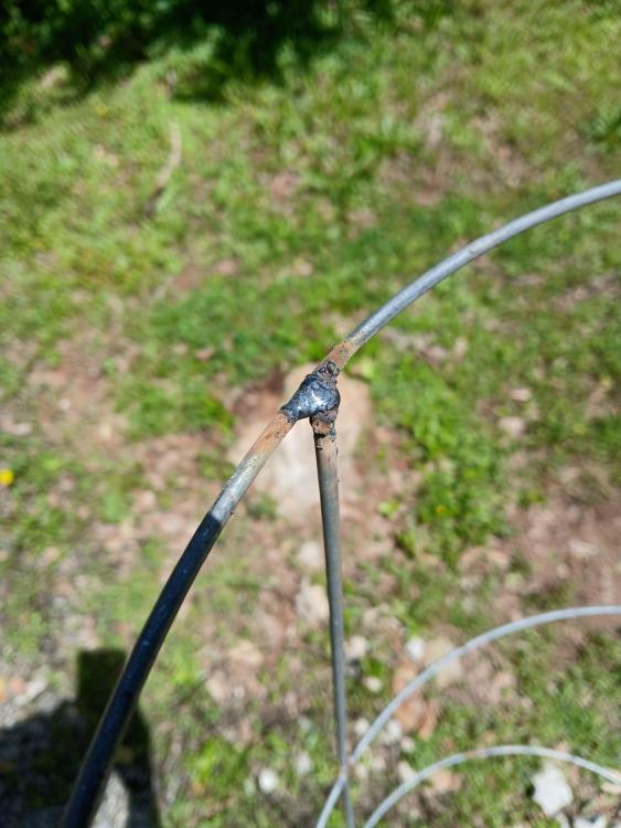

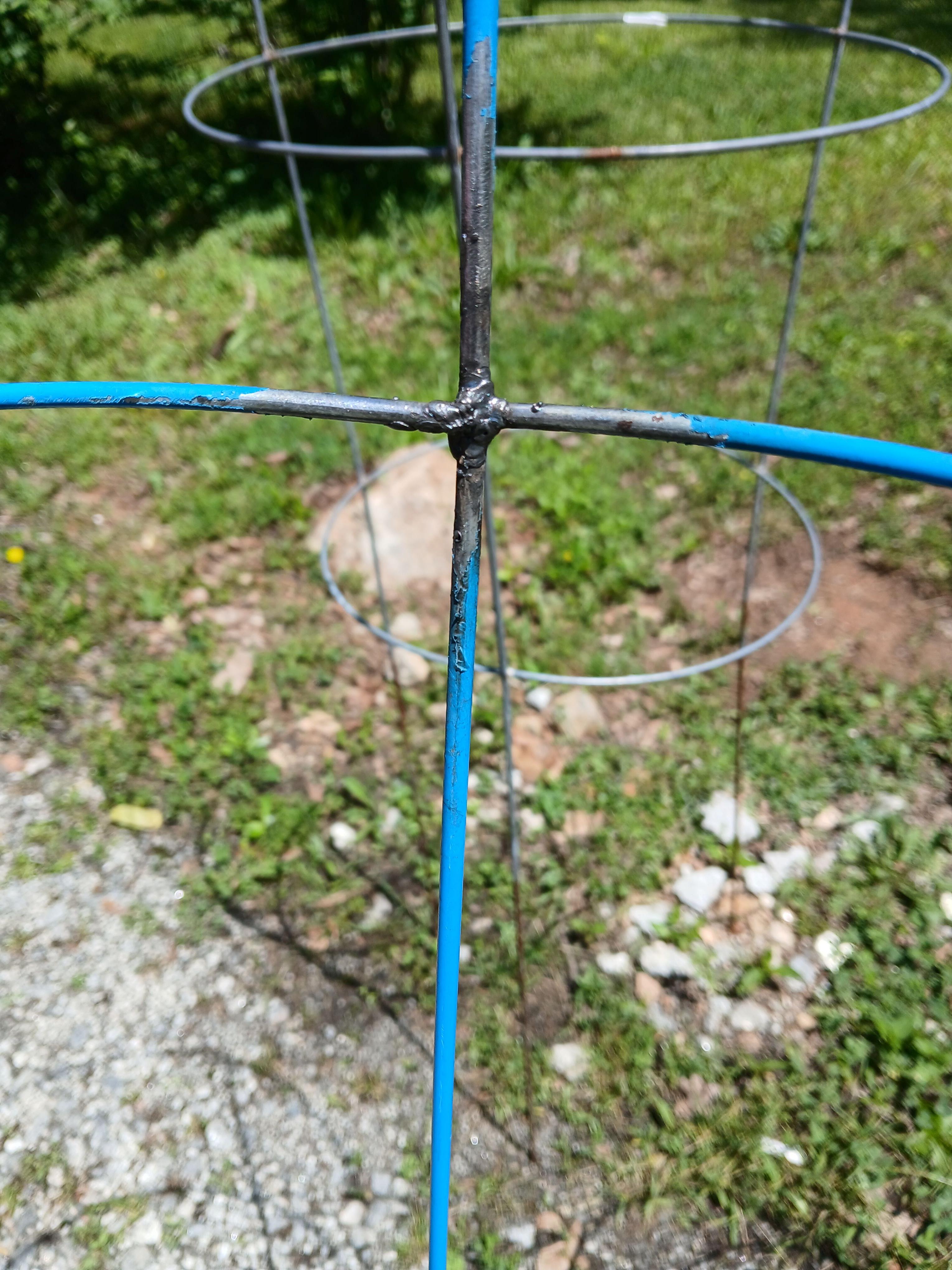

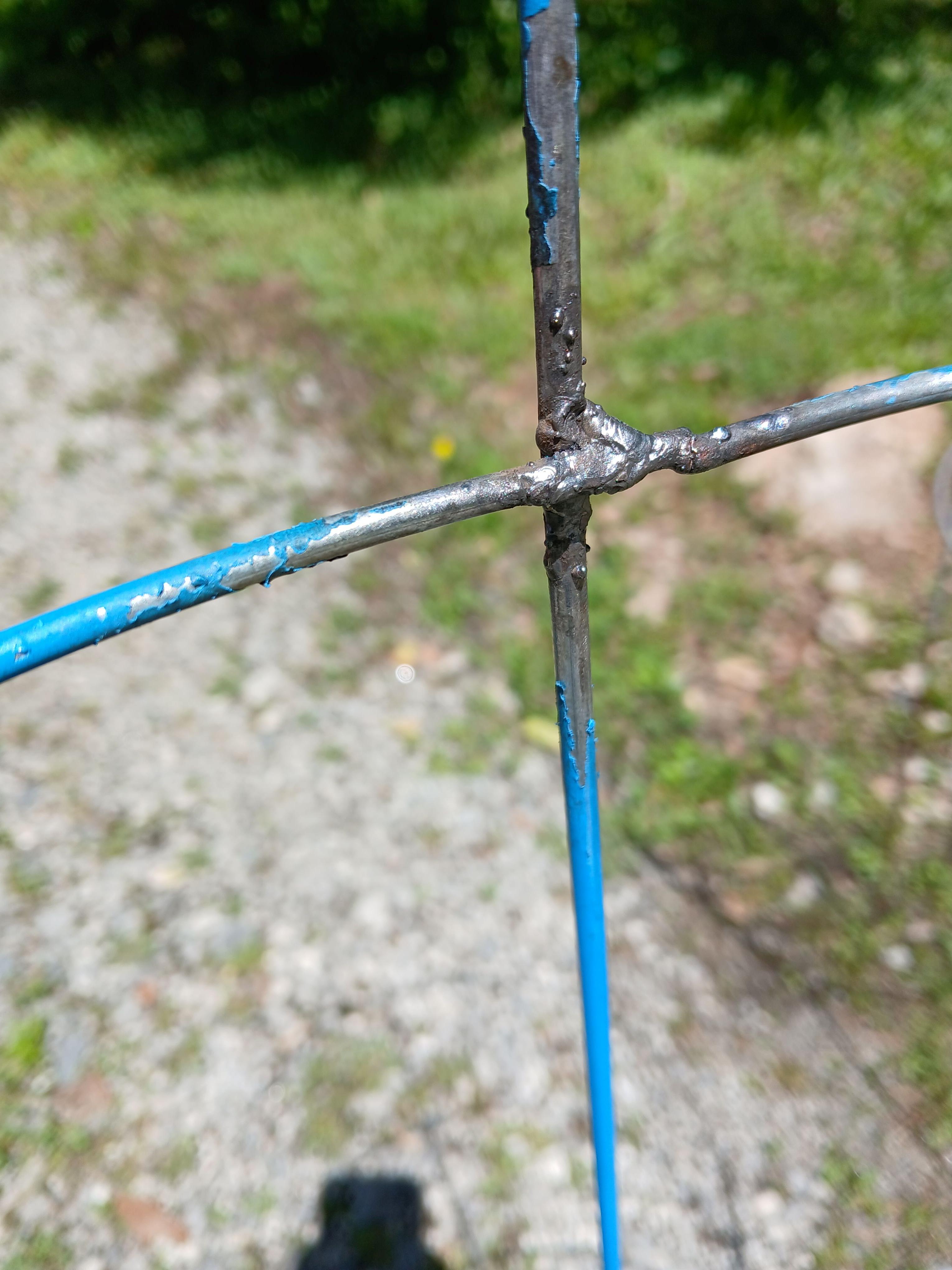

Sunday I fixed a couple of tomato cages that had defective welds from the factory.  I think that this welder is capable, more so than I am.  I used 1/16" 7014 rod to weld them up, set it to 50-60 amps..  The thinner gauge really gave me some trouble, no pics of that mess.

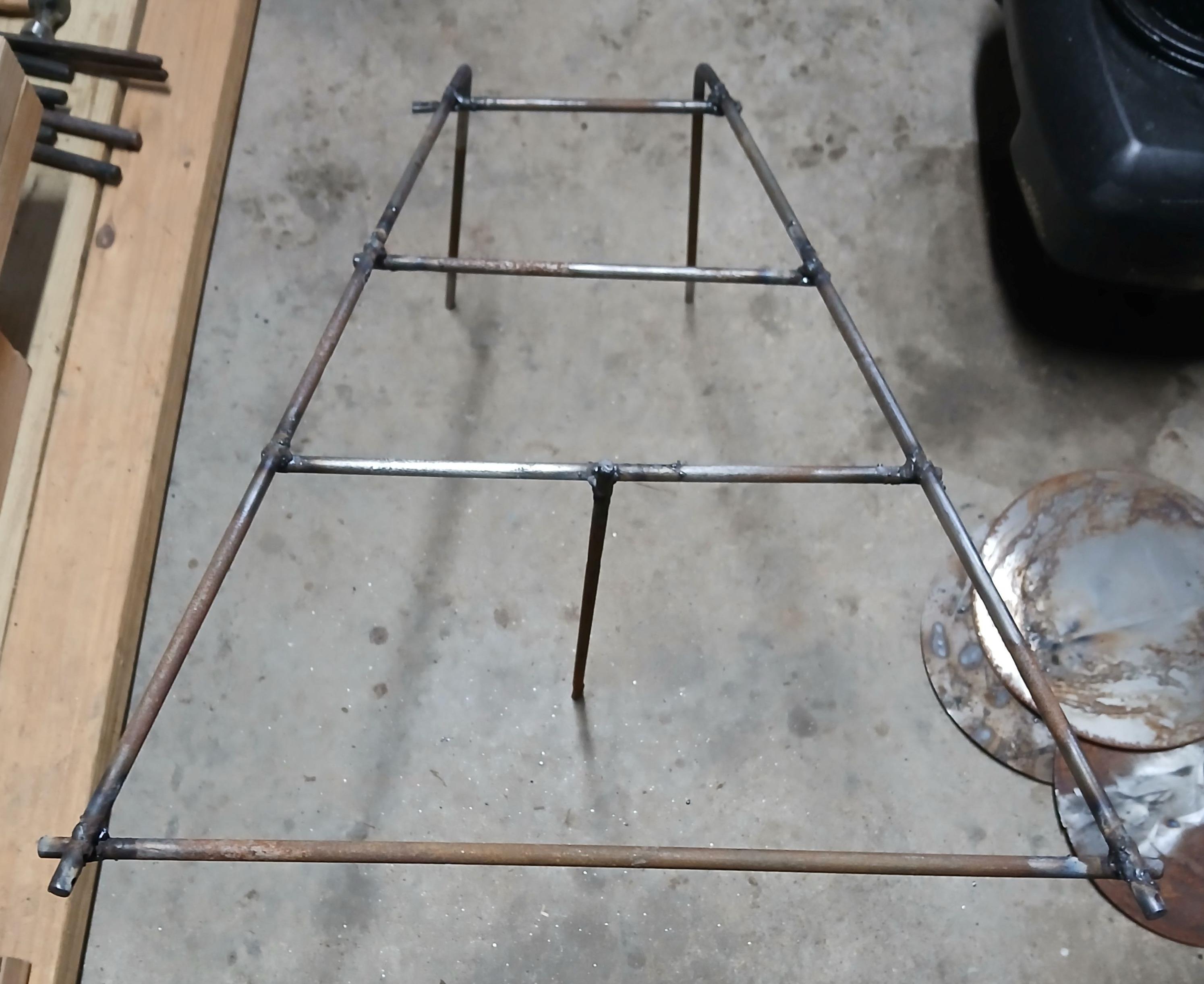

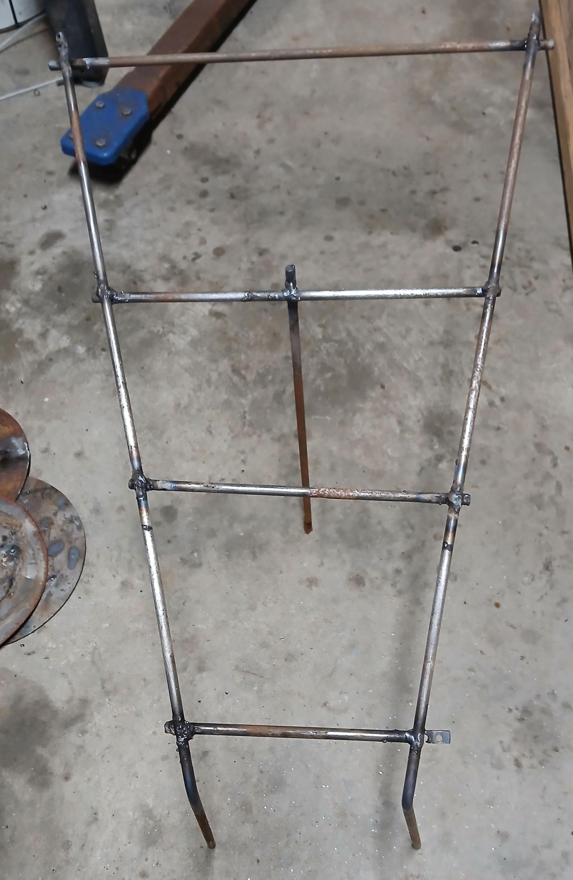

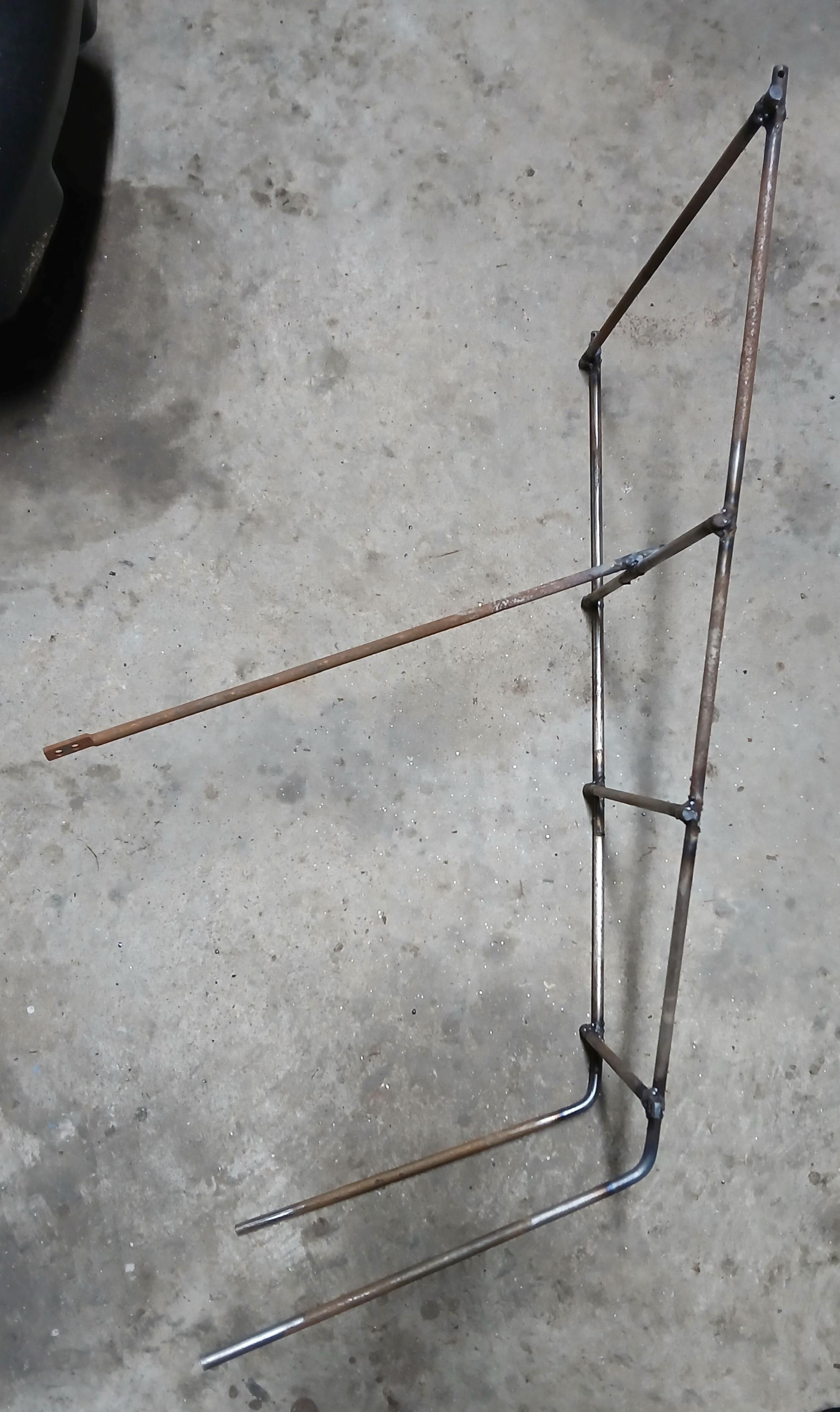

Behold the Zucchini ladder!  I don't like my Zucchini plants lying on the ground, and the option of tying them to a stake seems too sketchy for me.  I dreamed up this angled ladder for the plant to grow onto.  For size reference, the longest crossmember measures 16 inches.  This post is here because I used that welder to make this.  The steel is 1/4", maybe 5/16" dia.

Do zukes like climbing? I have some old bent up ranch panel fencing that would work for that sort of thing.
Looks welded to me, from here. You'll let us know how it works when you harvest? Sure beats slitting drifting and tenoning the joints.
I don't know that they like it, but I don't like them on the ground.  It should benefit them from getting more air circulation and keep them drier, so that they don't get some kind of mildew or rot.  I expect I will have to train or encourage them to grow onto it.  I have plenty of places to tie off.  Yes, I will give an update.
