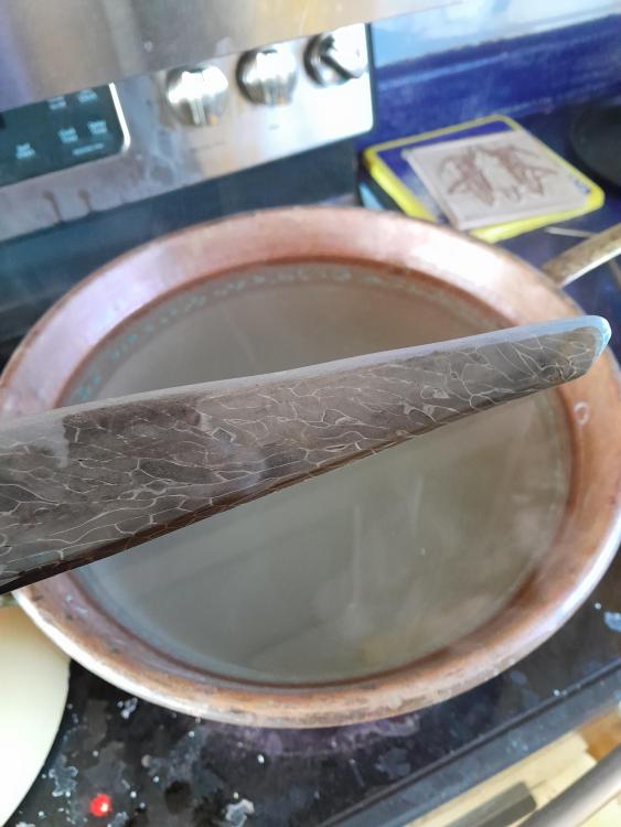

I'm trying to etch and failing miserably. No matter what  the magnificent damascus design is gone by finish. I've done over 10 etched on same blade and getting frustrated. I used fc, but I don't understand and will not buy or use it again. I started using vinegar and boiled the metal in it about 6 hours total. This didn't work several times. I heard to add salt and soap, but nothing. Finally I saw something that said hydrogen peroxide.  This was the first stuff I could see bubbling. When do you stop toothbrushing oxides because it can20240412_102051.thumb.jpg.e78bb8285f33c8fd0fbbd9f7663cc358.jpg erase the lines. It starts a nice darker color with white cracks but then it all disappears. I have have tried many many combinations  of the order of brush in etch, spray windex and then a dip of water. After I'm done I boil finished etch for 30 min in soda, but there is still fine oxide that disappears with my lines when I barely touch it. Should I toothbrush it hard and soak longer, if it's deeper it won't disappear. Can you sand through raised lines so damascus isn't visible.

The look in the pic would be fine to finish with
I etch AFTER all sanding. just neutralize and oil after etching, Else you are sanding away the etch
You need to give us more info, what steels are being used? what chemical strength for etching
Thank you. I use "about" a half gallon of white vinegar and about 1 small bottle of hp. It can go 10 minutes and look good or overnite. Other than a lot of pitting, the same. Looks good til after boiling in baking soda, then it wipes off. Does my Pic look right? I let the knife cool and rinse in water and then let it dry all the way before coating it in mineral oil, which is where I've used toothbrush, 1500 grit on hard block, a flat sharpening rods and several sharpening stones. I know it's 1080, pretty sure it's 1084.

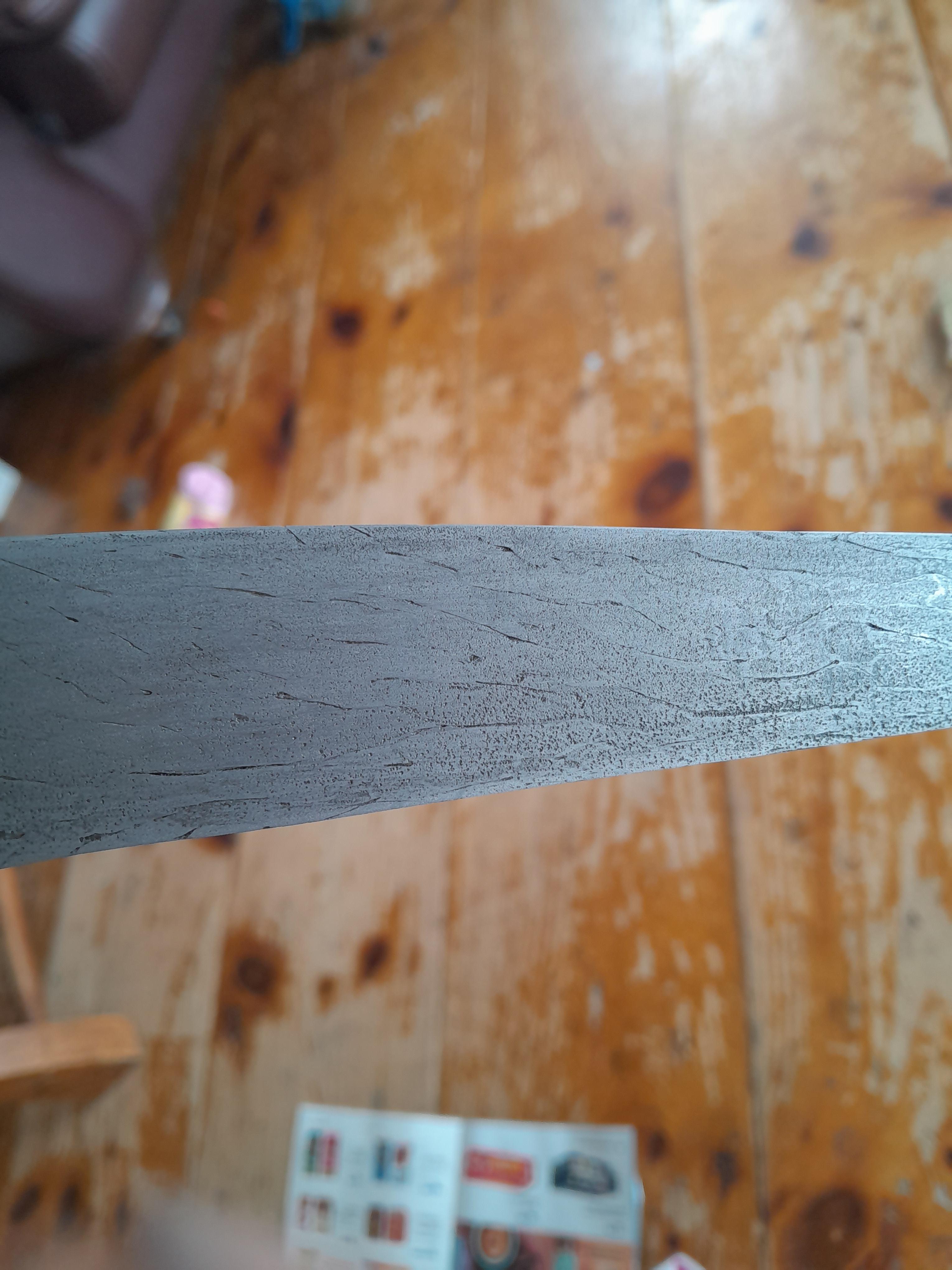

17145066456396198572157583554355.thumb.jpg.fbc12da39ca82373d15c961d82cf28e1.jpgThis is the look I get if I take sticky black sruffoff gently

Do you let the oxide go if it's smooth. It's that final cleaning I'm failing
Do you rewash w acetone after that. Do you use enchant to keep damp for wipedown or some soap enhanced dipping bowl
My lines will disappear under normal strength pinches. I got some beautiful dark finishes last night but I ground them away trying to expose my shiny lines I think I ground smooth

Consider what you are doing with etching.  With multi layer steels of different types, e.g. high and low carbon steels, the different compositions are differently reactive with an acid.  So, part of the more reactive steel is oxidized away leaving a valley (usually the higher carbon layers).  That topography is what gives the pattern.  So, if you grind or do anything more than a light polish after etching you wear away the high points and make the pattern disappear.  With pattern welded steel of the same composition, e.g. cable,  The layer boundaries and slightly different in composition and will show up in an acid but they are much thinner and less pronounced than the different alloy layers.  So, it is much easier to make the disappear if you grind or polish after the etch.

Thanks, I thought I might be sanding through the grain. How do I know when I've reduced enough oxide. My judgement isn't working. Should I toothbrush the face after my last etch, the residue comes out sticky if I've left it. What is the order of the final cleaning,boiling and gentle toothbrush scrub? I've read many suggestions to oil the last toothbrush scrub but I'd also read to do it unlubricated. Is peroxide and vinegar ok it works near instantly

My suggestion is the same as how to harden and temper mystery steel:  experiment.  Take some samples ("coupons") and treat them differently to see how different techniques work out.  And, TAKE NOTES.  You will not be able to remember all the variables and results.

  2. Cable Damascus is a very subtle pattern.  As I understand it, you don't really have two different types of steel, so you aren't really etching for topography that you can later emphasize by polishing the high points with a hard backed 2,000 grit sandpaper.  I believe that the white lines between the darker areas are just showing the decarbonization at the welded interface between cable wires.
  3. I recommend that you complete your etch, neutralize, and clean off oxides  with soap and a soft cloth.   During the etch, if you must remove oxides, also use a soft brush.
  4. Some folks recommend going with a slow, light etching solution (white vinegar or ferric diluted at least 1:4 with distilled water) and letting it etch for a long time.
  5. I haven't been very successful getting a cable damascus etch to really stand out (which is why I switched to pattern welded 1084 and 15N20 even though I love the traditional cable look), so can't give good advice on that, but you might want to try a final soak in highly concentrated instant coffee.  In pattern welded steel it can really punch up those blacks.

Polishing thenjigh point w 1500 is erasing all lines. I can do it with lines a little, only by hand, but if I push for clear lines, it starts to disappear.

How do people smooth sand to 1500 grit before etching and then stll have enough left to etch the contours?
You appear to be misreading my note.  You will likely NOT GET ANY SIGNIFICANT TOPOGRAPHY etching cable, so polishing afterwards is NOT RECOMMENDED.

OK latticino,I was misreading. You're saying the type of damascus won't ever be one I can just skim for shine I think
