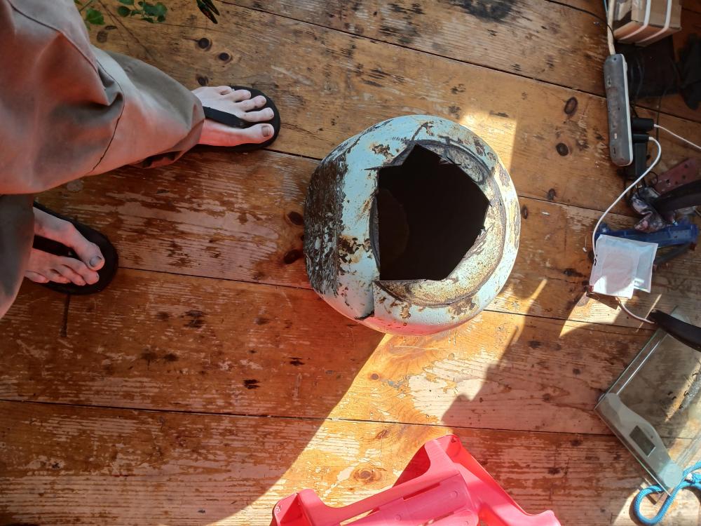

  1. Oh, my wife eats my snacks and drank my mountain dew or I'd study harder. (I still got my Little Debbie treats, they're hidden w hammers in basement). You were the original suggestor of metrakote but it was years back. I found plistex near free compared to metrakote so I switched to it. Not as insulative but seems to make heat better heat bounce around forge.
  2. Many on internet have advised plistex directly on kaowool. What kind of damage would I see inx̌ the plistex/kaowool if safety is disappearing ?I'm 85% still covered in kol, but I had a bad drop and lost a few chunks. Thanks Thanks How many times can you recoat in plistex and over what conditions? If the plistex is cheap enough could I repaint after each usage? Why with blanket, kol and plistex did i burn myself so thoroughly on outside of forge. If insulated to 2700-3000, should shell be touchable? It seems that way if temp should be 60-80 degrees. Thanks a lot
  3. Many thanks. I see I got my floor of forge kinda chasmed in areas. It should have been there ahead of pre plistexing so it should have 2-3 coats. It looks liìke it could hold pounds under the surface layer and that just has to be bad Should I not worry,, add 1 more layer or coat it thick? Thanks again Do people clean out Lil propane forges with alot of plistex
  4. Does plistex glow hot orange for a second when it is cooked in.i think i remember metrakote having to turn bright orange yellow to completely cure. Thanks all and take care too. It over kol. Can I burn this plistexn on my propane burners or do i need to wait til tomorrow for my 2 firebricks?
  5. That's a fire! Mine only has orange breath. That looks like an ai drawing
  6. One of the things I was looking forward to was having the ends start to get smaller to keep more heat it. And everytime I use kol over the outside lip it's broken quickly. My op was an exaggeration, I usually get about only 6-8 months with stock to big to be comfortably fit. Kol isn't disappearing, it falls out In chunks. Sorry for misleading anyone. Tx
  7. Kastolite 30 isn't cheap and I did guesstimate about 6 '10 bs to fill it minimum. Plus , I thought kastolite only worked if it had kaowool under it and i dont wznt that.. The old forge only had about a 9x6 openings( pre wool kol and plis, I can't keep gloves usable, get torn up or lubed up (from cable), so I've been trying long pieces but a few inches off doesn't fit and hot metal rushes my accuracy You've gotta be really exact with 18" x 2" going in a small toaster. And sliding piece over floor. My castolite breaks out in chunks. It was rigidized, buttered, high humidity period Burn in, followed by full plistexand burned. The kol was very sticky in a good way but applied w texture I didn't smooth out. I can't be the first yahoo to try this Thanks
  8. sorry for delayed response. Thank yal. My weight is often only 15-20 lbs but it can be up to about 18". Honestly. I have trouble with13" pieces if they're hot. It has to be pretty perfect in and out to not hit plistex kastolite and eventually the evil kaowool. I'm pretty darn sure my chamber could be 11wide at bottom, 9" tall and 13" long. I don't want to use kaowool. It's literally my only fear in this life. I guess this will also cause problems w edges. The longer length of 13" will make heat stay in longer, thus being hotter. I can cut the tank however I need to. Like the handle on it design for easy carrying. Wanted to show an illustrative picture. I wouldn't be near as offended to occasionally scratch plistex on soft brick on the sides and roof as long as it's not gonna go through to a kaowool layer. Thanks again And why unpaint in something if your gonna bring it up to 2200 degrees ? And shouldn't forge be room temp to touch if it's got 3000 degree insulation. I'm know it get alot hotter. Poorly sealed intervals?
  9. Is there set plans to put bricks in a propane tank so I can skip kaowool? I know you can make one out of angle iron and bricks but like the durability of it closed in a shell. The "bottom" of the tanke has been smashed flat to an 8," bottom. I will use a venturi and am tired of replacing lining after every two forgings because the heavy weight makes my cable bend, making it scrape top or bottom everytime. In two years I've kastolited, kaowooled and buttered about 9 times. I need no info on kaowool, I will not use it. I'd hoped to soft brick. Then hard brick bottom and coat it all with plastic. Will the exposed opening around the entry and exit melt? Thanks all, hope yal are all OK. Forges was colored blue so I couldn't get it to add this question there. NO KAOWOOL. Take care **This is for any poster/advisor who knows. It is not limited to any 1 poster
