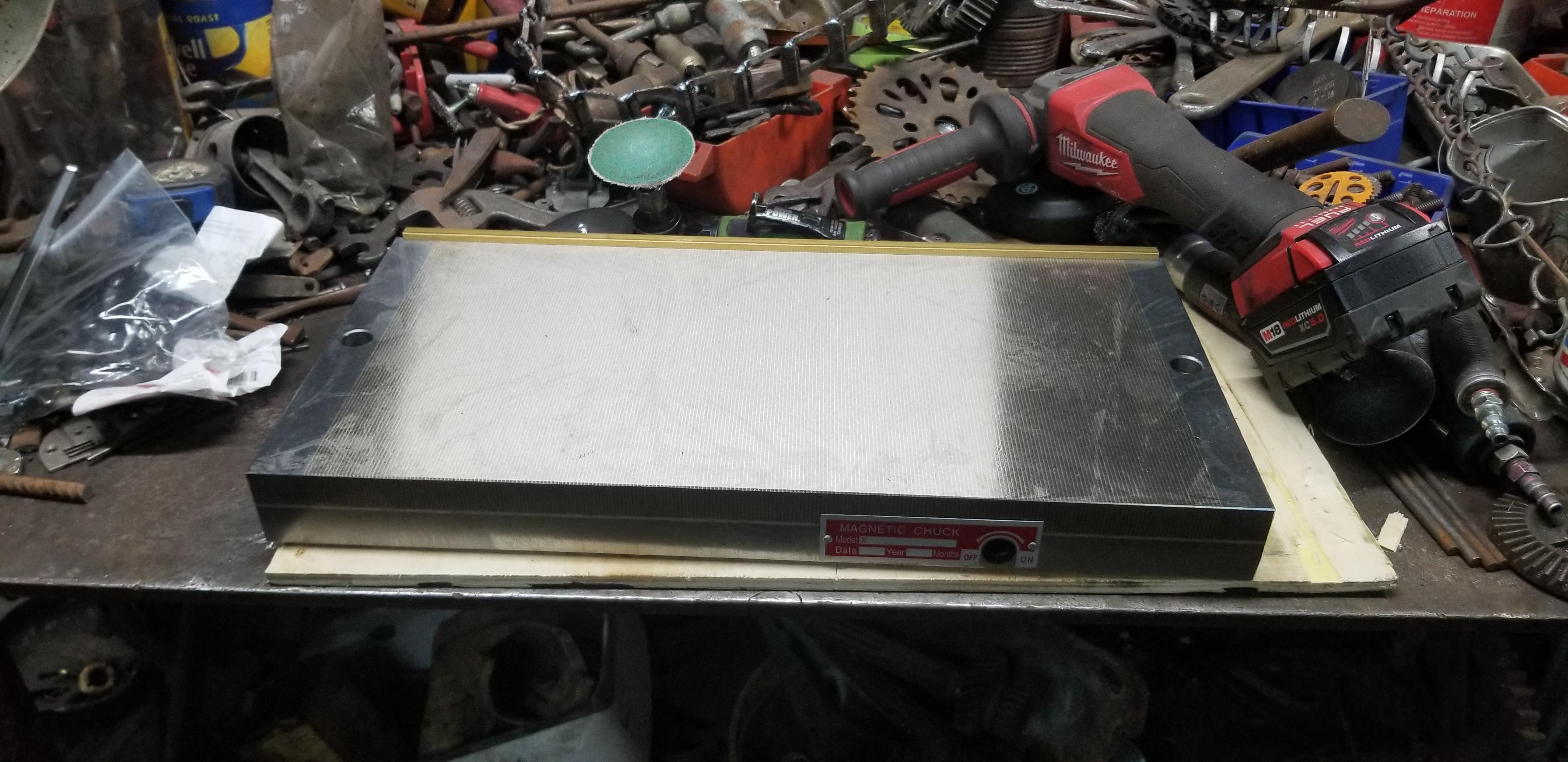

Daswulf Posted February 27 Author Share Posted February 27 Oh man... Please let it not be damaged... ! Kids can't get baths and to bed soon enough. It surely is 100#. Came boxed in light plywood with metal straps and corner straps. There is a depression in one half of the top. I hope that is just negative space. Quote Link to comment Share on other sites More sharing options...

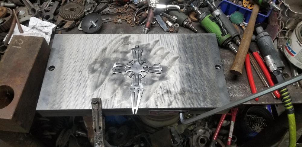

Daswulf Posted February 27 Author Share Posted February 27 Finally got to unbox this thing. Fortunately it made it undamaged. First opinions. It came with a big honking allen wrench. Good thing because as new the lever is stiff. I'm sure it will lap in over time. Looking at the tag, it is blank with no manufacturer or model or anything. Guess I will customize some stamping on there for fun and might as well put todays date and year so I remember how long it lasts or when I got it. Now the big one. How strong is it. Well, not as strong as I hoped but strong enough for my intended purpose and not weak enough to return it. Here is how it seems to me. The more flat area the better it holds. A bicycle sproket flat, can't move it. The plier handles i can pick right up and adjust but it will hold them enough for tack welding without jumping. The 1/8"x1" flat is harder to pick up on edge than flat but probably because it flexes on the flat lifting it. Meanwhile a rusty 2"x3/8" piece of steel will lift the end up but pulls freely on edge. Anyway, this will work fine for my intended purpose if tack welding heat doesn't harm it. I believe these are more intended to hold large already flat pieces for other kinds of machine work. But i am not let down other than I had thought it might be a wee bit stronger. You can tell the separate magnets with a ball bearing but it does hold two together just fine. In a way after putting some cut nails on, I can adjust them a bit with the magnet engauged but in place they hold well. Also, total loss of magnetism in off, so yeah, it will be easy to clean. Was it everything I hoped? Eh, no. Is it what I can use to tack stuff together without jumping? I think so, Yes. Next will be some welding tests. Quote Link to comment Share on other sites More sharing options...
