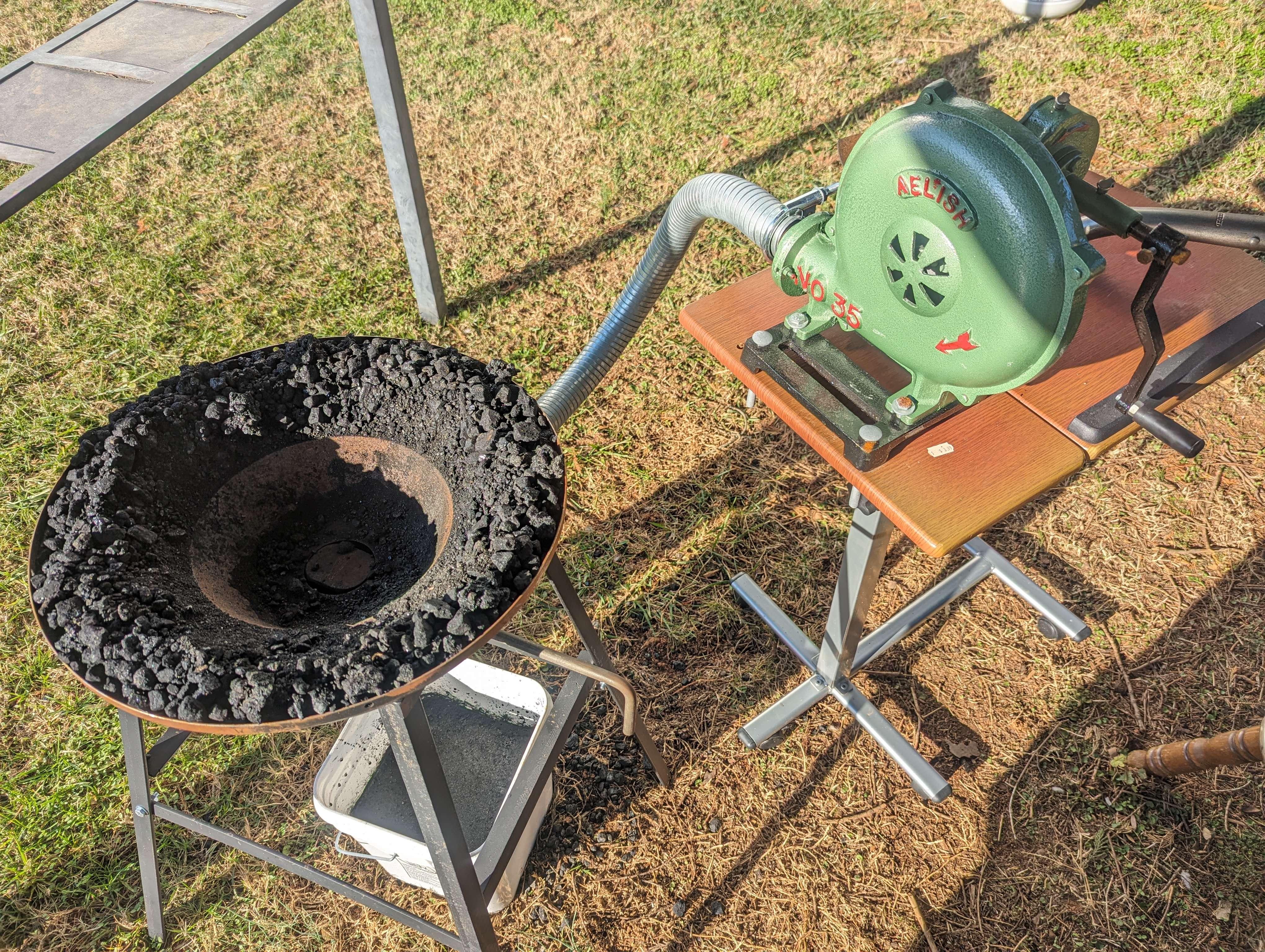

Looking for advice on how I can improve my setup.  Last time I tried starting up the coal forge, I smoked up the entire backyard somehow.  Not sure if that was an issue with coal quality, technique, or the heavy wind that day.  Going to try charcoal next time, and then add bituminous little by little until I have plenty of coke.  The plastic bag covering the forge was intended to stop or slow down rusting since I can't get out every single day and don't feel like lugging it in and out of the shed.  I can't get out even on days I have time but that's a mental thing and not really relevant here.  It doesn't appear to have slowed down any rusting, especially since I sprinkled some water on the coal in the forge because I have seen a lot of people say it helps it coke up.  But it never got fully lit, so I guess the water never got burned off and just rusted it all up.  Not sure if a rusted firepot is fine to use, but that's a question for a different post.

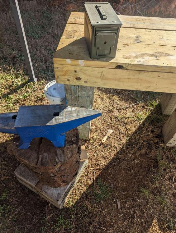

My anvil is under the yellow apron.  Trying to prevent it from getting too rusty as well.  It's one of those blue harbor freight anvils that people say aren't the best.  But it, like most of my setup, was a generous gift from well meaning parents who are excited to see me interested in a craft.  Along with a vevor propane forge but that thing honestly kinda scares me.

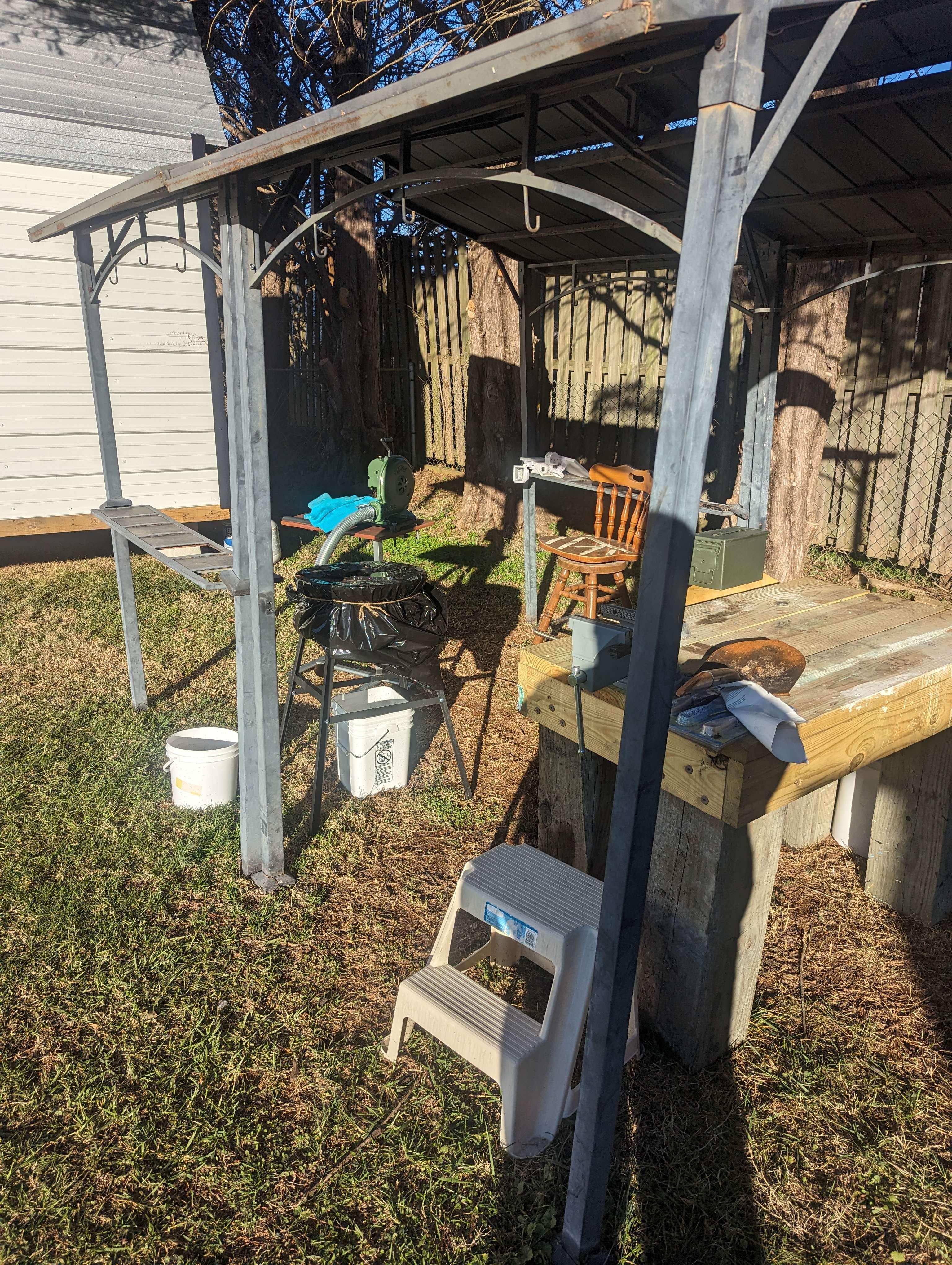

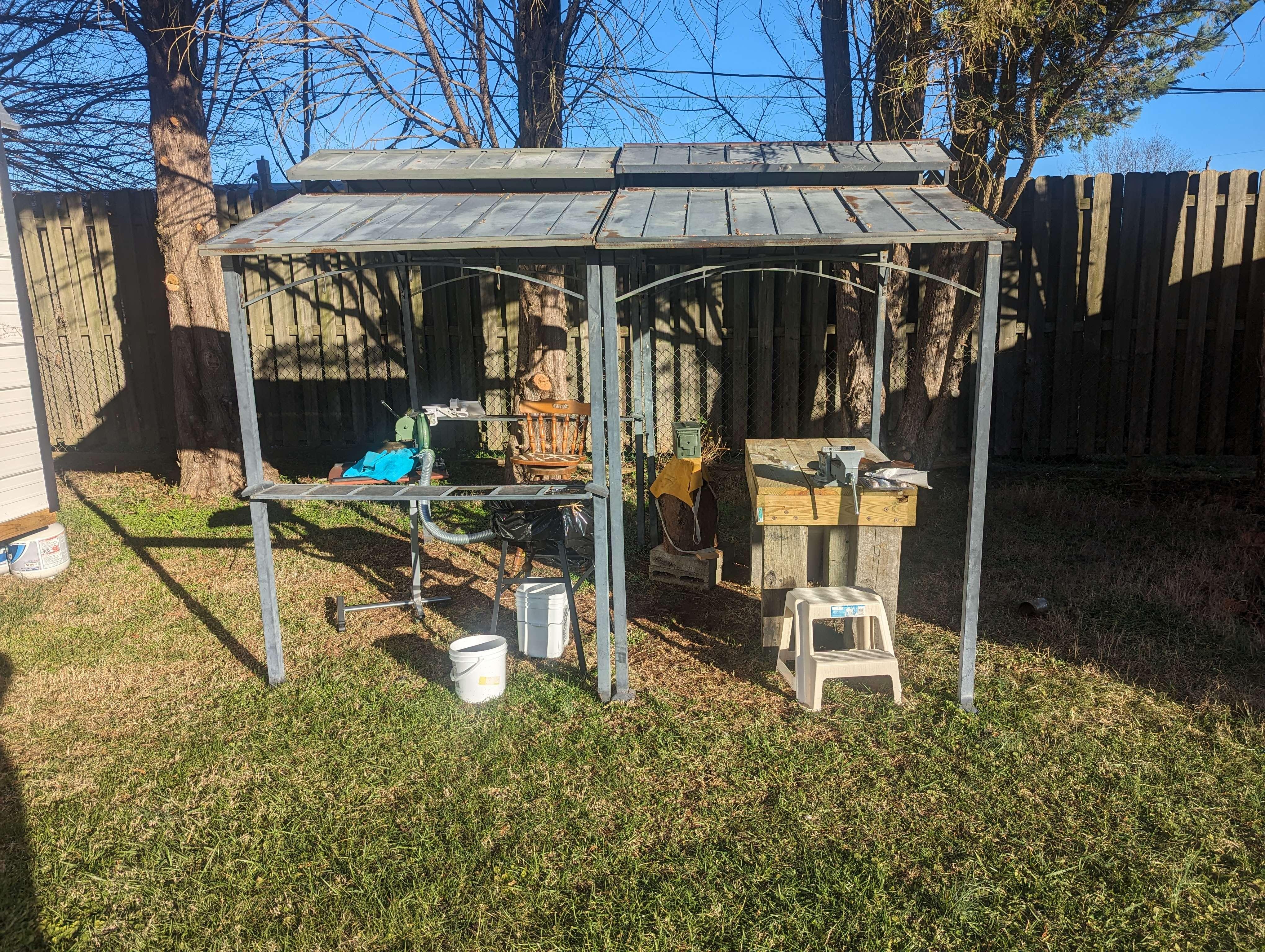

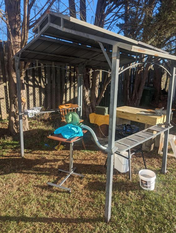

My main concern with this setup is ventilation.  I know it looks like it should have a ton of ventilation.  More than enough, really.  But somehow when I tried starting a coal fire, I got smoked out.  Even with the wind, it was producing smoke faster than it was clearing out.  I had to run out of the shelter and up to the house.
I've done my due diligence with a google search with the "site:iforgeiron.com" tag, but didn't come up with a lot.  As usual, I've found unique ways to screw things up.
I've over-explained enough, for now, any thoughts?  Hints, tips?  Admonitions?

OK, some thoughts on starting a coal forge fire with minimum smoke:  The way I do it is smilar to starting a campfire, start with small and more flammable things and work up to larger and harder to start things.  I usually start with a sheet or 2 of wadded up newspaper (not wadded too tightly) and then stack kindling wood (dry and around the size of your finger or a pencil) around and on top of the newspaper.  You can use the "teepee" style of arrangine the kindling or the "log cabin" style.  I prefer the latter. Then, stack bits of thumb sized coal around and on the kindling.  Once the coal is in place you can light it from the bottom but if you want to over compensate or are unsure of your fire starting abilities you can add charcoal starting fluid to the paper, wood, and coal.  Once lit gradually apply air from the blower.  You want enough to make the fire hot but not so much pressure that it blows bits of burning material into the air.  As the coal bakes around the fire the volatiles are driven off and burned and the coal is converted to coke which looks puffier and lighter than the "green" coal and burns without smoke.  Properly done, you will get some wood and coal smoke at first but it quickly clears out and the coke burns with a clean flame and no smoke.
As the fire continues rake coke in from the edges of the fire, do not add green coal from the top.
Or, you can start with coke as your fuel and eliminate any smoke problems.  I started doing this years ago to avoid issues with my neighbors.  I live in a semi rural area now and could go back to coal but I have continued to use coke because it is what I am used to now.  I get mine at a farrier supply place.  Coke has some different problems in use than coal, basically that it is harder to light and keep lit.  You have to keep some air blast to it at all times or, at least, at frequent intervals.  You can't leave a coke fire for extended periods like you can a coal fire.  It will go out if left un attended and without any air blast.
I hope this helps.
For me, the way to start a fresh fire without coal is building a good wood fire. I get the wood fire to burn well (use really dry stuff, so it will be smokeless), make it a lot bigger and start to put fresh coal at the edge. Because the wooden fire is burning, the smoke from the coal burns too. Then you put more coal on the edge and push the coal, that you put on first, more in the middle. If there is a gap in the middle where the flames from the wood can come up, it will eliminate the smoke.
Does that make sense? I could make a short video if it is too difficult to wrap the head around it :)
Thanks for the thorough description, George!  From what you're saying, I think part of my problem is that I piled green coal on top rather than let it bake on the sides.  Got impatient, I think.  I'm ready to start working and be done with trying to figure out how to start.  Would another method be starting a pile of charcoal and then baking the bituminous coal around that?  I don't really have kindling available, but I have natural lump charcoal and a chimney starter.
Rusted forge is fine to use. Rusted out takes longer but would not be fine, and is not likely to be a problem for you any time too soon.  Then again I have not seen the details of your solid fuel forge. Is it home made from plans or just sort of like a design you saw? Or is it a purchased one?
You mention bituminous coal so that is what I assume you are using. Yes it can get smokey starting out but once you get a good forging fire going and you have banked coal being raked in from the sides it usually isn't bad. I do tend to get sootier using my out door demo forge than I do my home forge with a hood and stack. A hood and stack can be added to an outdoor forge.
Watering down the coal isnt just something you do. There is a reason. That is if your banked coal is dry and it is burning instead of coking. Just dowsing water over your coal fire is pointless and bad unless you are trying to put it out quick for some odd reason. To normally put it out, just cut the air supply and spread out the coals and it will be out and cold quicker than you might think.
No problem with starting a charcoal fire and adding coal. But, the coal Will still smoke as it cokes down.  Maybe a little at a time. No water In the fire pot. In fact leave it alone unless you see the coal outside the fire pot catching fire. Then just a sprinkle around the outside of the fire pot.
I think you may have been smoking yourself out with the water.
You do need to maintain a solid fuel fire. With coal when it has been burning, watch out for clinker buildup and poke it out and rake in the coal as needed from the edge of the pot where the coal has been heating and coking.

I would move the blower closer to the forge. Seems a bit far away.
I use coal. I also use charcoal to start my fire. I will soak a couple handfuls of lump charcoal with a bit of lighter fluid, not in my fire pot, it may be on the far side of caution but i do not think it a good idea to put lighter fluid down the tuyere. Light the charcoal and start pulling the coal around the fire so that it makes a "volcano". I like the charcoal also becuase it makes fire fleas, to many is to much air, none is not enough. The hole in the volcano makes a heat "jet" so to say, that heat will make the smoke from the coal get pulled towards it and burnt in the flame. Smoke is the unburned volatiles from the coal. The trick is to keep enough heat on top of the fire to combust the smoke. With that in mind it may help to put up some sort of wind block either walls or just around the forge itself. It will be easier to control the fire if you can control the wind direction.
When i am done forging for the day i will also pile up some more coal and keep cranking my blower for a few minutes. That will make coke so that the next time i light my fire i have more coke to start with which will also reduce the amount of smoke put off.
One winter i had a freind come over and he was surprised i had a torpedo heater to heat my shop. He figured that since i had a fire that was hot enough to melt steel that my shop would be nice and toasty. I told him i did not want to heat the shop i wanted to heat the steel, so i wanted all the heat to stay in the fire not spread around the shop. Which is the reason i use a watering can. Coal fire will spread across your forge, i use the watering can to keep the fire in the fire pot and not burning 6" outside of it. That is just wasted fuel.
Another tip on the water thing. When you are done never ever dump water on top of your fire in the fire pot. Scrape off the top and quench it yes but not in the fire pot. When water hits burning coal it turns to steam, that steam will bring out coal gas. That is the same gas that used to light houses and streets when gas lighting was a thing. That gas is heavier than air. It will build up in your ash dump till it reaches the bottom of your fire and then ignite. I have had flames shoot out of my blower before. That was in my early days of using coal and part of my learning curve, be wise learn from my mistake.

And to answer Dawsulf's question, the forge is a rivet forge from Centaur Forge.  Also got the hose and blower from them.  A lot of other stuff was thrifted or purchased locally.  Even the stump came from someone local.  I tried to purchase locally as much as possible when figuring out my setup.  It just feels right for this sort of project.  I went with the rivet forge so I would have more budget for material.  I don't plan on working on anything large for a long time, so it made the most sense to me.
Everyone has solid advice for starting/maintaining your fire with less smoke but I just wanted to pipe in on advice for clearing the smoke should it happen again. Because this happened to me a lot when I started as well (I still to this day get impatient and throw green coal on there, lol) - except my forge was just outside the shed door and the smoke would fill up in the shed where my anvil was. While your enclosure isn't closed on the sides, it does still have a roof that can trap the smoke.
If you have a way to run an extension cord to run a small fan - or if you have a battery operated fan - set that at the base of your forge pointing up/out of the enclosure - away from the forge. You can also try mounting the fan in the rafters/frame of the roof and blow out. That might work by sucking the smoke up away from you and blowing out from the enclosure.
If possible, also move your forge just outside the overhang when forging. Or get/make a hood with smoke stack that can carry the smoke outside the enclosure.
In my case, I started with the fan. I set it just in front of the doorway pointing up. Made for a nice breeze to cool me off as well, lol. Eventually I got around to making the hood and then I was able to get rid of the fan and was crazy impressed with how much it reduced the amount of smoke!
I would get a bigger bucket for the water than an ammo can. I use a 30gal. barrel for a slack tank. I got mine from the local transmission shop for free. Not only can you use it to cool your work and tools but if you have a fire, tipping it over can help. Which also brings me to ask where is your fire extinguisher?
Get rid of that plastic bucket under your forge. You can pick up metal buckets from the local hardware store pretty cheap. Or if you can still find one, tar, paint, and grease used to come in 5gal metal buckets. Plastic and hot ash/coals do not mix well.
Your water is fine for use until your start forging high carbon. If you go with a larger container such as the 30gal barrel, you will want to leave it in place and not refill it everytie you use it. If you do drop a piece of copper pipe or bar, what ever into it. The copper will keep algae and the like from growing. A bit of veg oil in the water will make a film on top that will keep mosquitos from breeding in it.
It looks as if you also have a couple pavers of cinder brick under you anvil stand. Take this from my own experience, get rid of them. Eventually, and a lot sooner than you may think, the continued hammering on your anvil will cause them to break. You would be much better off with a couple pieces of 4x4 or 2x4 under it.

While your enclosure isn't closed on the sides, it does still have a roof that can trap the smoke.!
This is exactly what happened!  I had to bail out because the entire enclosure filled up really fast!  I actually haven't been out there since because of that experience.  I have multiple fans and the enclosure has a bunch of hooks I could hang one on.  So I'll give that a try.
From what everyone's saying, I have a few tweaks to make but overall it's a solid start.  I have plenty of all the PPE listed.  I even got several sets of all-cotton outfits for the dangers that George listed.  I just need to remember to take the extinguisher out with me.  Really just need to purchase one to dedicate to it.
And about the pavers under the stump, I put them there so that the stump wouldn't be resting on the ground to prevent rot.  Would 2x4's accomplish the same thing?  I guess they would if they were treated lumber, right?
I'll have to look into metal buckets.  Apparently a nearby auto shop is selling barrels.  Drove past and the missus said she thought that's what the sign said.  Wasn't a good spot to turn around and we were ready to get home, though.  So I'll probably look them up and call for more info.
