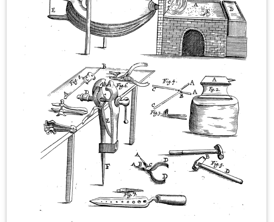

Well, I've just had a look at my copy of Joseph Moxon's 'Mechanick Exercises' (relevant volume 1677), this has a section on smithing in which he illustrates and explains the tools used. The diagram shows no hardy or pritchel hole in the anvil and he makes no mention of holes in the text describing the anvil. He was a careful observer and a is precise in his descriptive language; I doubt that there is any oversight in this instance so, most probably, a hardy hole was not something he was familiar with - or maybe even knew of. Either would indicate that such things were not in use on anvils from either Yorkshire, where he was brought up, or London where he was a reside as Hydrographer to the King. He traveled in Northern Europe, and would most probably have noted something so 'revolutionary' as a hardy.
In passing, I think his illustrations show a very modern-looking leg-vice and, of course, almost any tool that could be used in a hardy hole could be held in a vice. Later in the text he mentions a bolster for use during punching...
