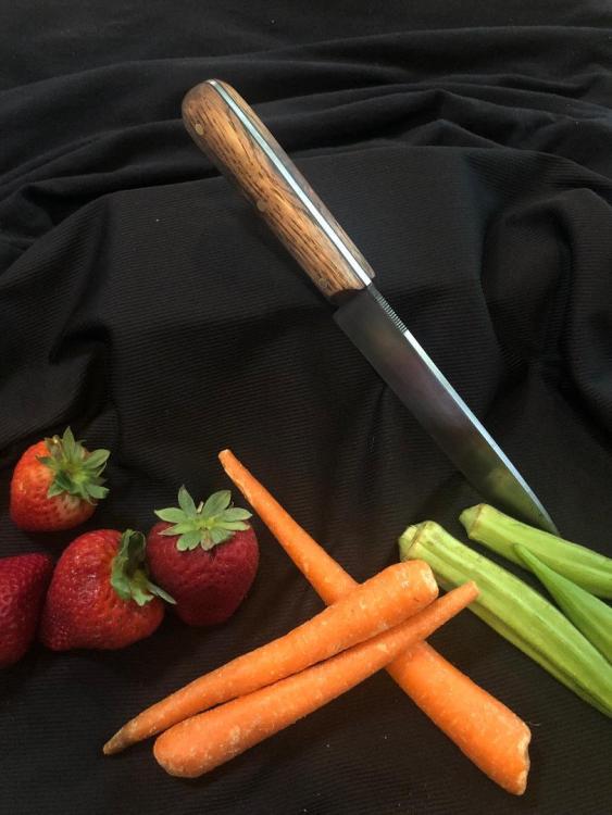

Hi,
         Built a new Propane Forge to get back into making a few knives.
This was made from an old Johnsons File.
Thermo Cycled 3 times to refine the grain.
My idea of a Kitchen Knife, farm cut Red Oak scales and Loveless Bolts for handles.

Knife looks nice from what i see. Lighting could be better to show the blade more clearly.
No need to get upset. It is a wonderful forum to people with patience to learn. Not everything gets lots of oohs and ahhs here sometimes. patience and persistence.
What feedback were you wanting?
Okay, one comment coming up. Looks like a decent kitchen knife. Though you might want to cut the carrot instead of break it next time you take pics. It's not the best commentary on a blade.
You might want to clean up your language, it's a family friendly site and the mods are zero tolerance.
I have an Ontario Old Hickory chef's knife that could be it's mate. Very good style for most kitchen task's. Yours is just a little sweeter.

OK, as you appear to be fishing for constructive criticism, here goes:
Things I like:
  1. General fit and finish (Liners, pins, handle surface finish...)
  2. Well blended grind with no plunge line or riccasso (my aesthetic preference for kitchen knives, but can be a challenge to execute well)
  3. Material selection for blade and handle
  4. Bevel at front of handle
  5. Knife profile (but see below)
Things I think could use further refinement (hard to tell from photos in some cases, but I'm making assumptions):
  1. Brut de Forge section at top of blade is irregular and doesn't look intentional
  2. Jimping on spine is well executed, but I can't see the purpose it serves on a blade of this type.  The balance of the design is aggressively functional, so all elements should match IMHO
  3. Handle could be a slight bit more ovoid for improved indexing
  4. I think adding distal taper for the tang is a nice touch for both aesthetics and balance in hand. YMMV
  5. Hard to tell from photos, but could be a "knuckle-bumper" when using to cut on a board.
Hi,
         Thank you, just what I was looking for, all good suggestions!
This is not a Chefs Knife but more a Kitchen Utility Knife, (maybe little difference on that, admittedly?)
A LOT of little things to work on and your suggestion help!
Still working on the handle part!
Thanks again!
