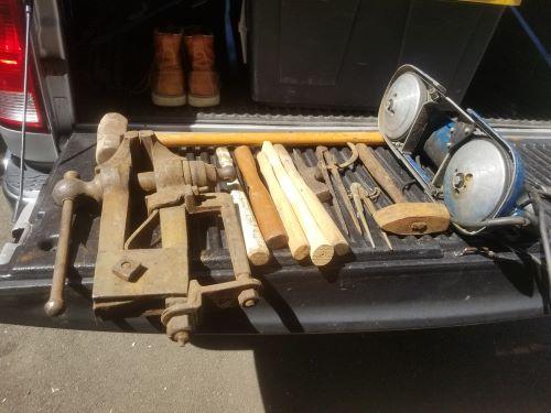

So, i picked up this vise at a yard sale along with other items in the picture for 35 bucks.
i have googled and it seems its a wagon vise? maybe?
my question after cleaning it up is there a standard way of mounting it so i can use it for blacksmithing or did i waste  my money and just scrap it for the metal weight

Dang!!! 35 bucks!?!? What a steal!
I have never seen a vise like that before, so whatever you do DONT SCRAP IT!!!! That is history right there!!!!
I wonder if you slide a board(s) through the upside down L shaped bracket and that is how the vise is mounted?
The man it belonged to was a pipe fitter /welder, the family was selling all his stuff. i was expecting him to say 100 bucks for the vise and when he said everything on my tailgate  35 bucks i just got out of there .
As far as how its mounted yes it looks like something could slide thru that area and then get "clamped" down by the 2 bolts on the bottom
I believe there are complete instructions for mounting and using a "wagon tongue blacksmith's vise" in the US Calvary blacksmith manual. That's pretty close to the name and I'm sure someone here has a copy or can link you.
You didn't waste your money for sure. Those wagon tongue vises are really collectable and usually go for over a hundred dollars U.S. at auction. There are several threads here on IFI. If you do a search like this using your favorite search engine

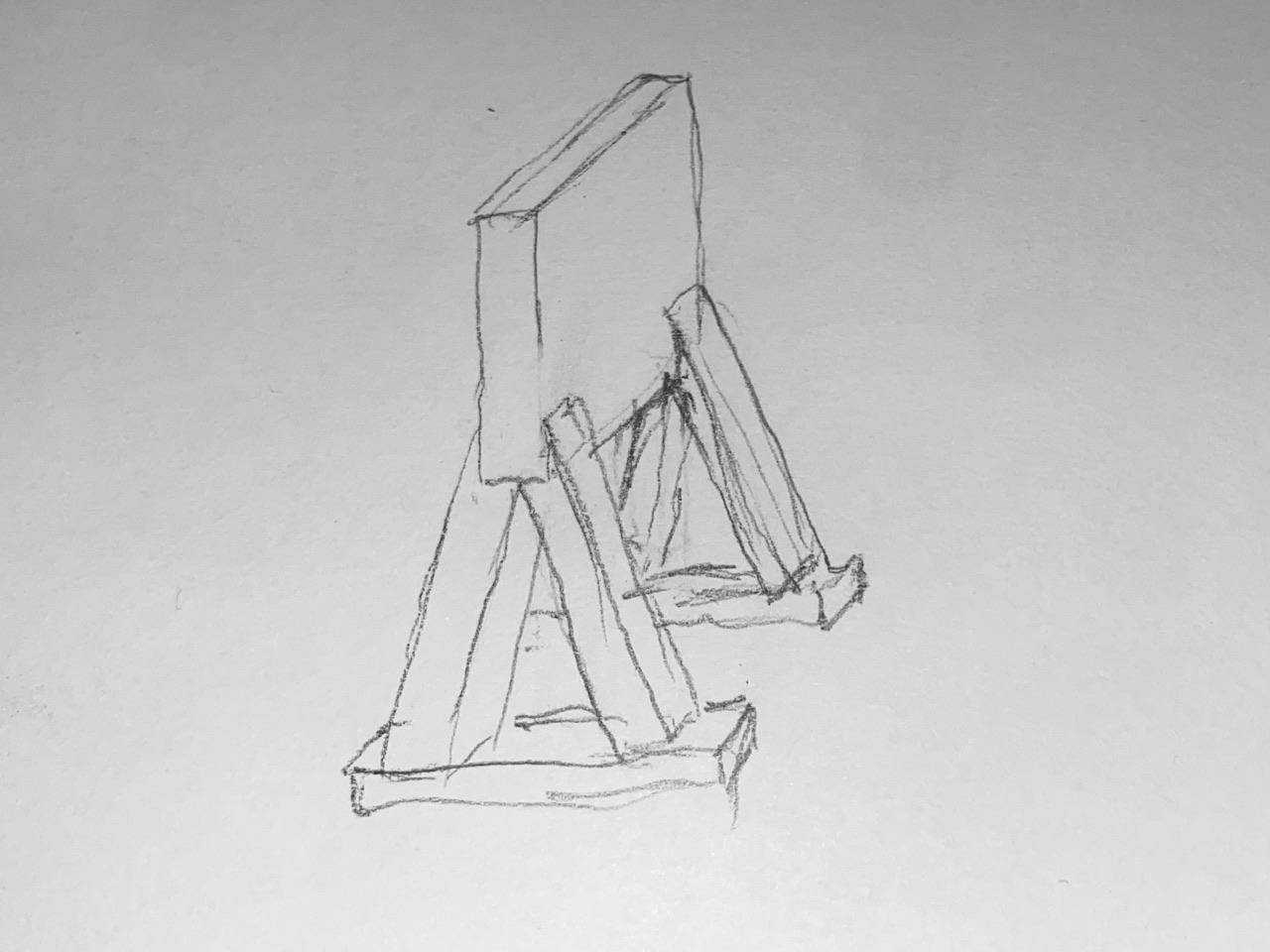

If this is your only vise, mounting it as shown is just fine.
If you already have (or later acquire) another post vise, I would seriously recommend making a mounting for this one that is (A) freestanding and (B) much lower. One of the problems with hammering on things in vises is that they are often uncomfortably high, so some kind of mounting that would put the top of the jaws at about the height of your anvil could be very useful. I'd suggest something like a heavy sawhorse, thus:
I've been keeping my eye out for a vise with a broken leg that I could similarly mount at a lower height; sadly, the only ones I found have crossed my path when I didn't have the spare cash!

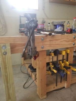

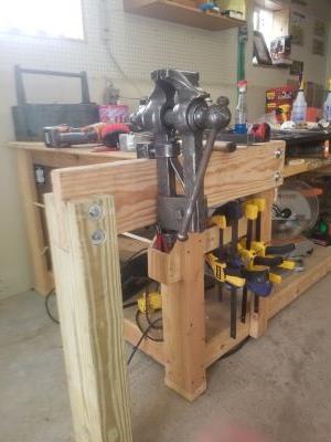

Thanks for this post David. As you see I have it mounted on a 2x attached to my work bench. Did they continue to make these after that time period (if you are familiar) or is my vise from that time period.
I am happy with my set up other than needing to get a thinker piece of wood or a spacer as it is set up for what I am guessing a true 2" not the nominal 1-1/2 " 2x
Thanks for the info and pictures
