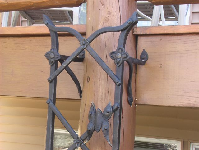

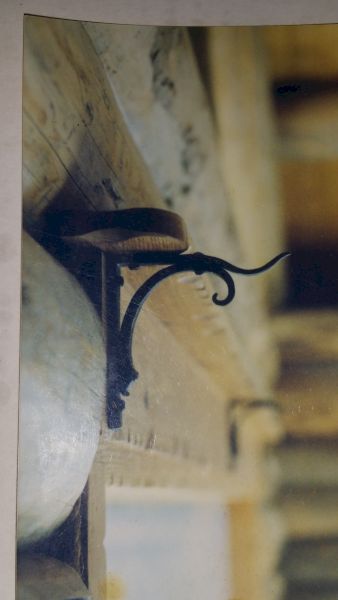

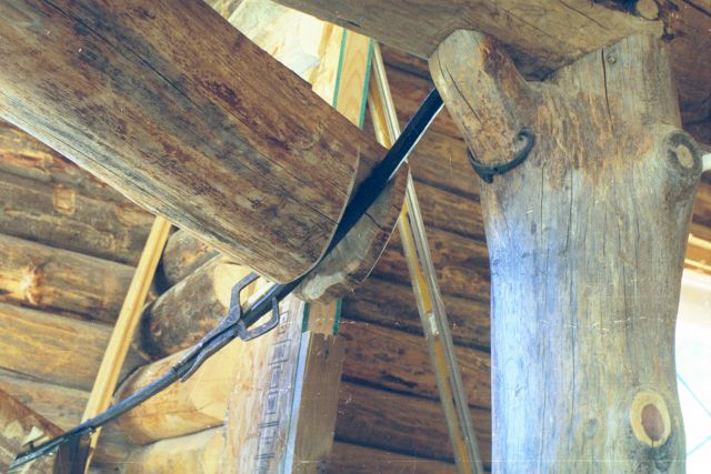

February 27, 20233 yr Great vid! Thanks. What it doesn't show is how many years it took him to be able to do those scrolls and, most important, to match them to each other. It is a great example of architectural iron done as a fabricator. Pretty rare. The tools you use are a personal choice and there is no "best" way. It all depends on you. Many come into blacksmithing with a desire to use our traditional and very simple tools,,, forge, anvil, hammer and post vice. Many discover right quick that there is a huge difference between fantasy and reality when it comes down to both learning and using these tools. With experience you can make anything you want in iron with the toolset of a fabricator, a blacksmith, or any combination you choose. My choice is to use the tools and joinery of our craft. I don't cut my tapers with a grinder, nor do I bend my finials cold, but literally every blow he made on the finials and the rest of the scrolling could be a mirror image of me at the same task. I do most of my curves as he did with bending forks and a scrolling wrench. These tools are made as a set and the sets are made to fit different size iron. The bigger the steel, the bigger the tools and the longer the handle(for leverage) will amaze you as to what you can bend hot or cold. Heres some examples. The first three are the bottom stringer on a curved rail. It started out as 1-1/4" square stock forged on the diamond, then bent hot and cold. The finial was forged hot, then cold fitted to the log. On the 3rd pic(i hope) you can see how the stringer attaches to the treads.The next is a truss, 10'x4'. The frame is 1/2"x2" and was bent with forks and wrench cold. I also did the brackets. A forged right angle and hot cut and filed detail. You mentioned a garden trellis. The last 3 are just that. The final is a small bracket. Forged right angle, hot forged finial and all other scrolling done cold over the hardy hole of my anvil. All work is done "by hammer in hand", no grinder, torch, welder etc.

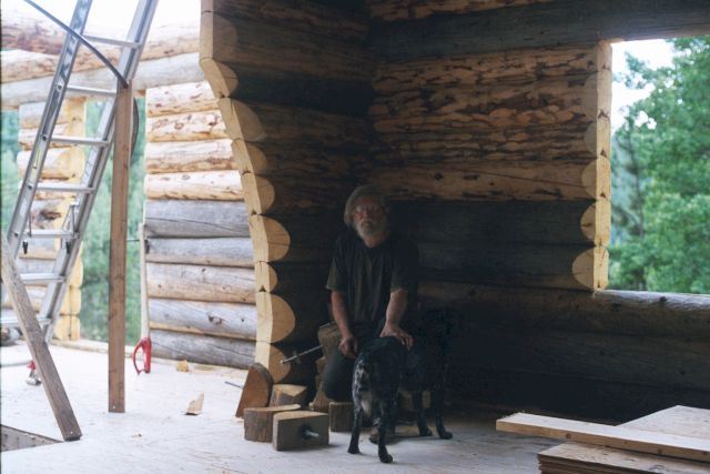

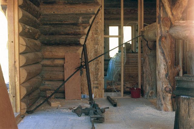

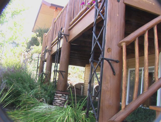

March 1, 20233 yr Author Anvil -- glad you liked the vid! He stood apart (in my eyes) even from many of the professional iron workers with huge workshops that I saw on Youtube, just for his sense of design. I am sure he is making it look easy. Yes, I imagine there is quite the learning curve. I suppose I'll start with a couple of books and try to sketch some designs and go on from there. Thanks for showing me into your world a bit. inspiring to see your work. and looks like a beautiful cabin! I imagine those rails were a bit tricky to measure out and get right. We also need a rail made for some porch steps. Perhaps if I get into it... I especially like the truss and the bracket, beautiful designs. I was imagining something like short perimeter fencing, maybe only 1.5' high, to surround a desert garden I am designing. And then possibly work up to bigger things. I'd like to first learn how to do scrolls and piece them together. Ever work with copper? Nice to hear you did all of that by hammer in hand. My feeling is to want to keep things fairly simple along these lines, at least at first.

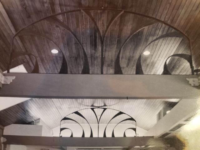

March 1, 20233 yr Since shop size and heavy equipment is part of your question, my shop was 16'x20' and I have a 25# lil giant hammer, a large post drill and a pedestal grinder for powered tools. Thanks for your comments. The truss was for an order of Nun's and the center detail is a chalice.
