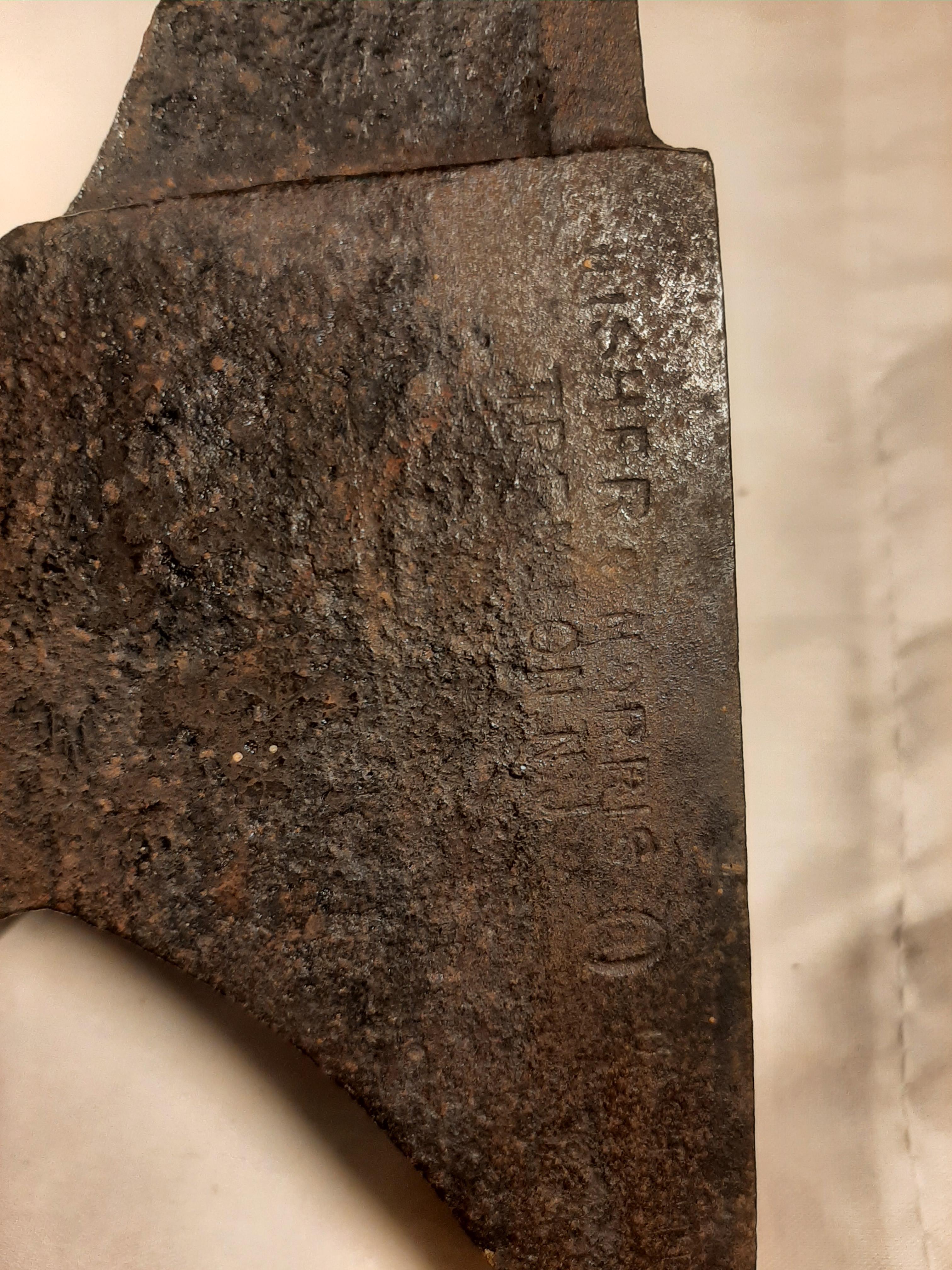

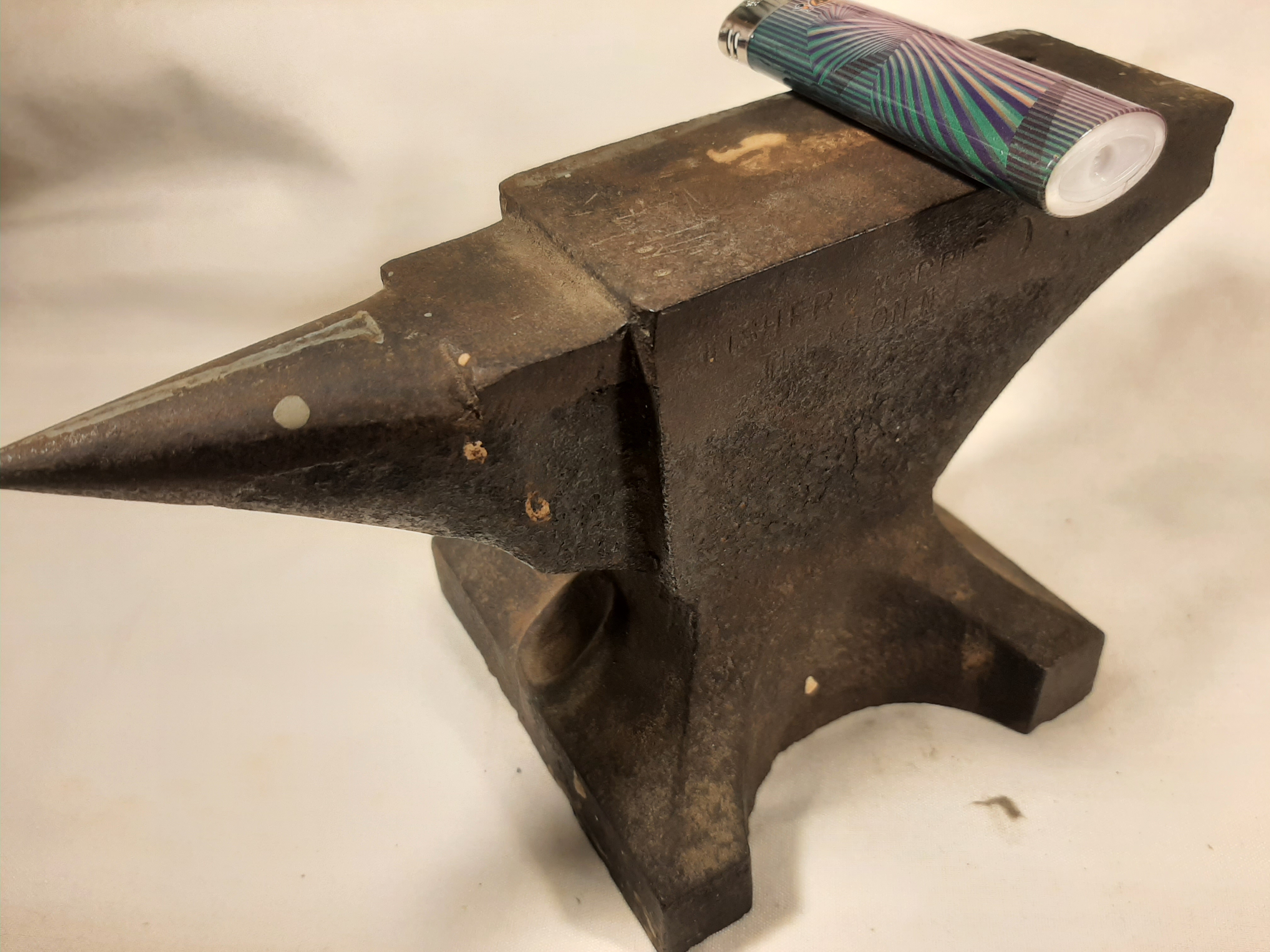

So I'm wondering if anyone can help me out with any information about this further than what I've been able to gather that this is what would be referred to as a 10 pound anvil made by fisher and norris in Trenton Nj. Any kind of dating information or value would be very much appreciated!
I believe those were a traveling salesman's sample anvil.
Referred to as 10lb. anvil? What does it weight? It's not like it's a functional anvil it won't have lost much due to the corrosion. It's value is what you're willing to pay for it.
It weighs around seven and a half pounds. I don't really know anything about it to be honest, just what I could gather in an hour or so researching online. This just seemed like the community to ask from what I found. I've also been able to make out the words "CAST STEEL" on the right hand side after the "0" in the stampings.
And here I am.  Your 0 size anvil was made as a functional piece.  Not as a sample.  The "Cast Steel" refers to the horn steel plate...they were cast steel.  The anvil has steel faces on the horn and body, welded to the cast iron body during the casting process.  Mark Fisher figured out how to do this in the 1840s.  F&N went on to make over 600,000 or more anvils using this process.
The markings of the size sometimes were multiple of 10, but in your anvil it was made as an 8 lb +/- anvil.  Your anvil was probably made in the 1870s, or a bit later.
