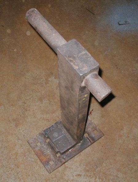

In your situation I'd probably opt for a literal hunk of steel to start with.   You should be able to obtain something between free and junk prices that will fit the bill, save you a bunch of money, and let you get started beating on hot steel.
Here's some examples of improvised anvils:
https://www.iforgeiron.com/topic/52308-a-collection-of-improvised-anvils/
It looks like a good and useful steel anvil.  Personally I have been bringing an 80# rectangular solid of steel to demo's and classes that I paid US$16 for at the scrapyard just to show that the style of anvil that has been used for 10 times as long as the London Pattern  has, still works!

Let your improvised anvil pay for the one you want!  Of course I would argue that a type of anvil that has been in continuous use for 3000 years over most of the "ferrous" world is decent---Japanese swordmakers use them and they are considered to do decent work!  I've a stack of London pattern anvils and use them often; but I've also made my own stake anvils and used "cube" anvils.  If I had to make a living at ornamental ironwork I probably would go for a southern german double horned anvil and if I was making tools and doing heavy forging something like a Nimba.
But I'm cheap and so use the ones that the TPAAAT brought in and am happy I anviled up before FinF came on tv...been forging 41 years now; it's my primary hobby.
TPAAAT also works for power hammers; I found 3 for sale 2 blocks from where I worked in this small rural town.  I was able to buy a blacksmithing "hoard" and sell off what I already had or didn't want and pay for all I kept; so my 25# LG and cone mandrel and coal forge for billet welding were *free*. (NM is tool poor as it had a very small population in the latter 19th and early 20th century. Florida had about 2.5 times the population of NM in 1900 and NM is almost twice as large.)
If you read a lot here you will probably run across me saying over and over again: 1000 hours forging on a US$100 anvil will make you a better smith than 100 hours forging on a US$1000 anvil. It's skill, stamina, muscle memory that counts the most!
