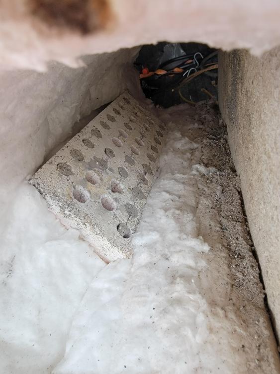

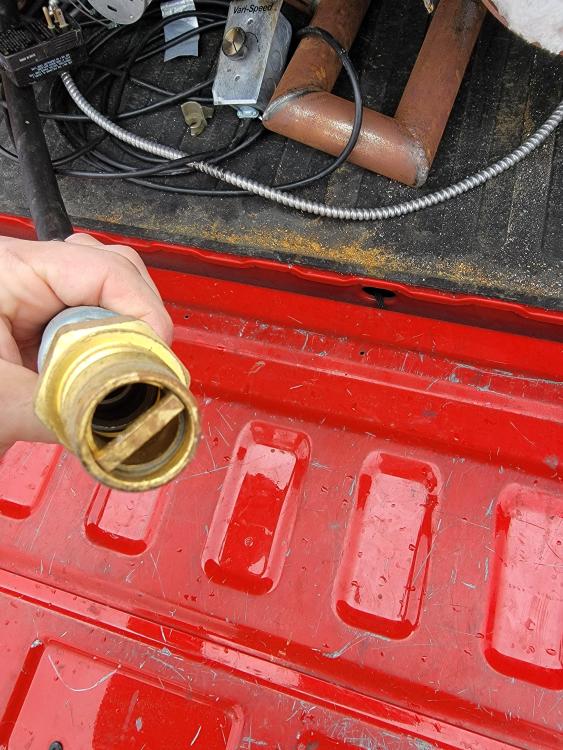

Just picked this up last night. It is set up for low pressure gas and has a variable blower fan. I will have to convert it to LP grill tanks. Will the fan work or be usefull with a high pressure set up? Or how would I go about setting up a 40# LPG into a low pressure system?
The Smith says it works great as it sits but got rid of it because he built a bigger one. I know I need to ridgedize the fiber. I need to brick the openings. There are a couple welds that have broke free in transport home I believe. And the plaster/concrete on the bottom slides around in the forge.

B y "low pressure gas" do you mean Natural Gas at household pressures or Propane at low pressures? If it's propane at low pressures; that is just dealt with by using a regulator to meet the pressure(s) it is designed for.

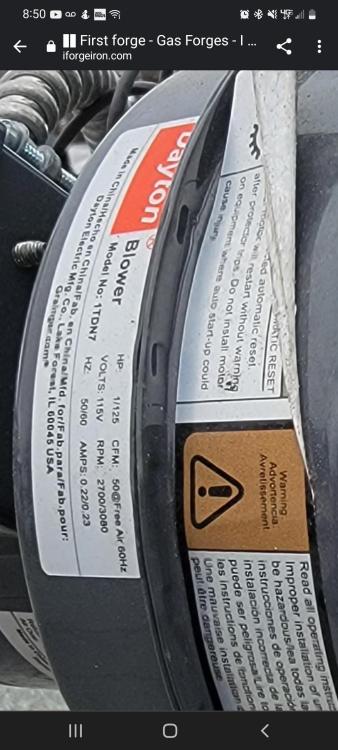

Since the burner is NOT designed as a NA burner; you gotta have a fan!   Will that one work for the BTU's you plan to shove into the forge---Maybe.  My blown propane burner uses a 150 cfm blower considerably choked down, what is that one rated at?  Propane and NG work a bit differently due to the base energy content of the fuels. All those bends in the mixing tube makes one think it was designed for propane anyway. My best suggestion is to try it and see!  I hope you know how to tune a burner by varying both air and gas to get a good burn.

As far as the supplies to finish the interior of the forge, everything is right here in the IFI store. Important note I would not fire it up until I had it rigidized and the blanket coated with castable refractory.

I've never seen a build quite like that one but the multiple 90* turns in the supply pipe assure the fuel gas is well mixed. Yes, as you say the interior needs to be rigidized and a coat of hard refractory applied. A final kiln wash will improve effectiveness too.
BBQ regulators tend to be too low volume to adequately supply a propane forge. 0-30psi high pressure regs. are reasonable money online and provide enough volume to run more than a reasonable fellow needs. My old obsolete 0-20psi regulator handles four 3/4" T burners easily.

I hope the floor in your forge isn't REALLY "plaster/concrete":o!! If it's loose just slide it on out and replace it with something appropriate to a propane forge environment!

All advice here has been very good to date.  I expect the original hookup was for residential pressure natural gas, which is what I run here at home as well, based on the apparent size of the gas feed.  I've not converted one to high pressure propane (or wanted to as NG is so much more convenient), but it shouldn't be that hard.
I would definitely keep the fan assist configuration, but you may want to neck down the gas feed to something like 1/2" with a 1/4" orifice to avoid having a flame thrower if you regulator fails for some unknown reason (not critical, but a good safety measure).  Of course doors, proper rigidizing and coating with a refractory are also a good idea, as is a good quality gas regulator.
The other safety recommendation I have is to install a gas rated solenoid valve on your propane feed that is connected tot he same circuit as the fan.  Not quite as good as a flow or pressure switch, but if the power to the fan shuts down it will shut off the gas.

Floor and burner look to me to have been cast from Mizzou or some similar refractory.  Should be fine for flame and flux contact, but the floor may bleed a little heat.

As for the CFM of the blower I also don't know right now but will update as soon as I get home from storm duty (probably tomorrow night 4/19). The power cord for the blower and speed dial is pretty long 20-30'. I know this will be a lot of trial by fire for me as I've never had a forge. But every bit helps and I will use the knowledge given. And yes, the wierd plumbing set-up caught me off guard quite a bit as well.  I play with power all day on the poles but I've never been great as an electrician so the fuel solenoid may sit on the back burner for a while, atleast till I get comfortable with this forge and know that it is running well/ consistently.
I did get a picture of the tag. I could remember if I did. Says 50 CFM @ free air

That blower should make plenty of air. Free air or transparent mean air can move freely through it so blocking it off or choking it completely won't damage the blower or blow something apart. It's an impeller fan, it makes a LOT of air for the power you put in but won't stall if blocked off. they're good, safe blowers.
