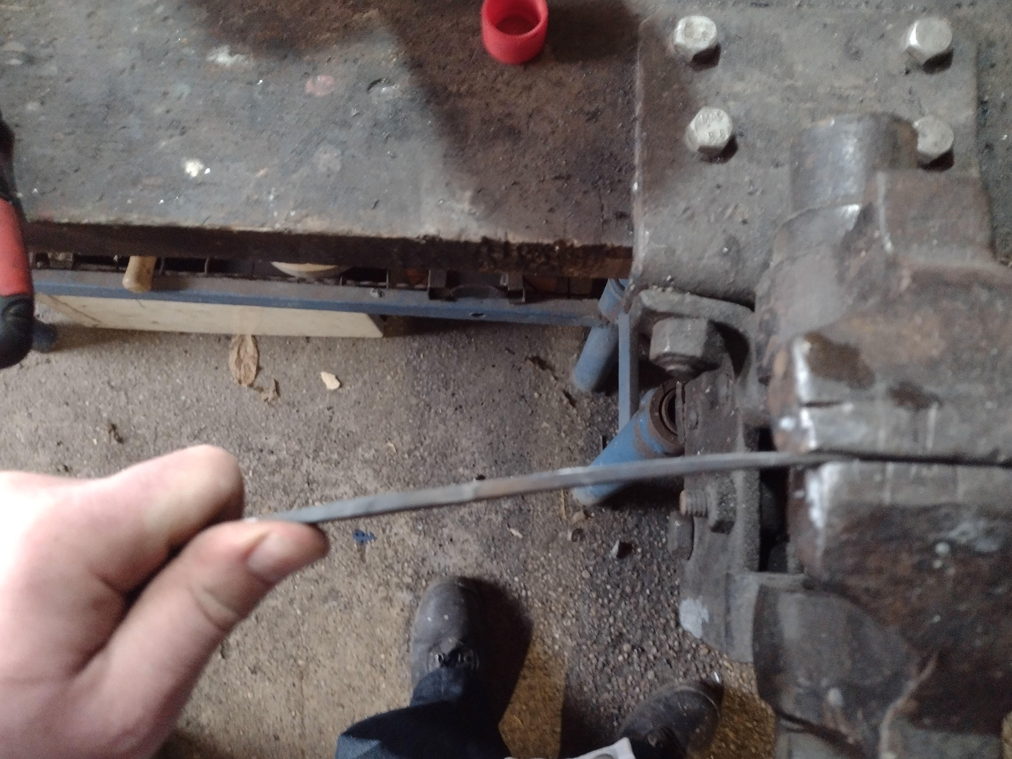

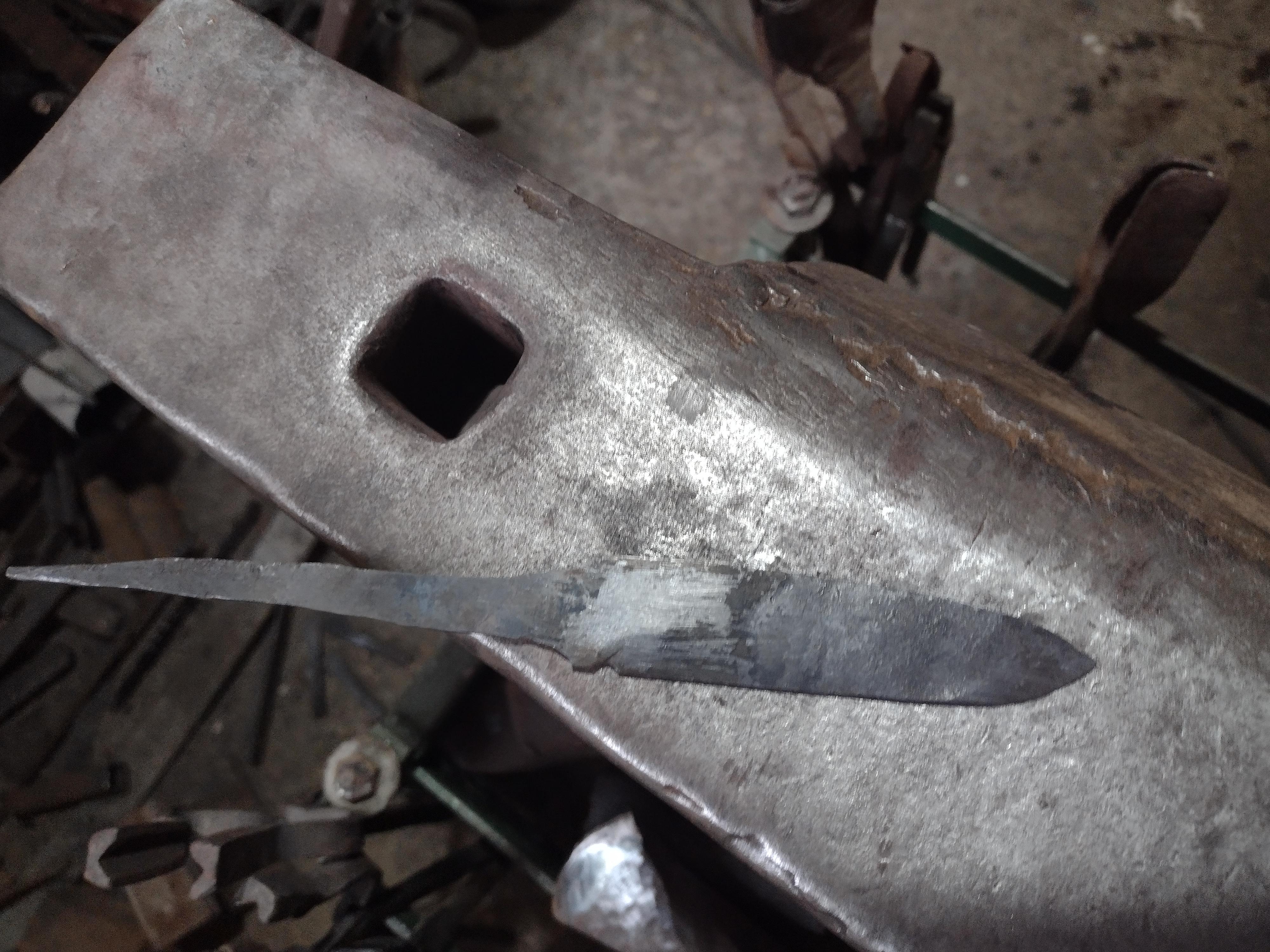

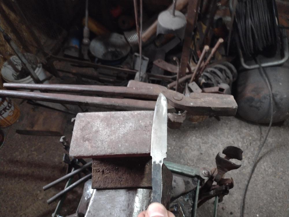

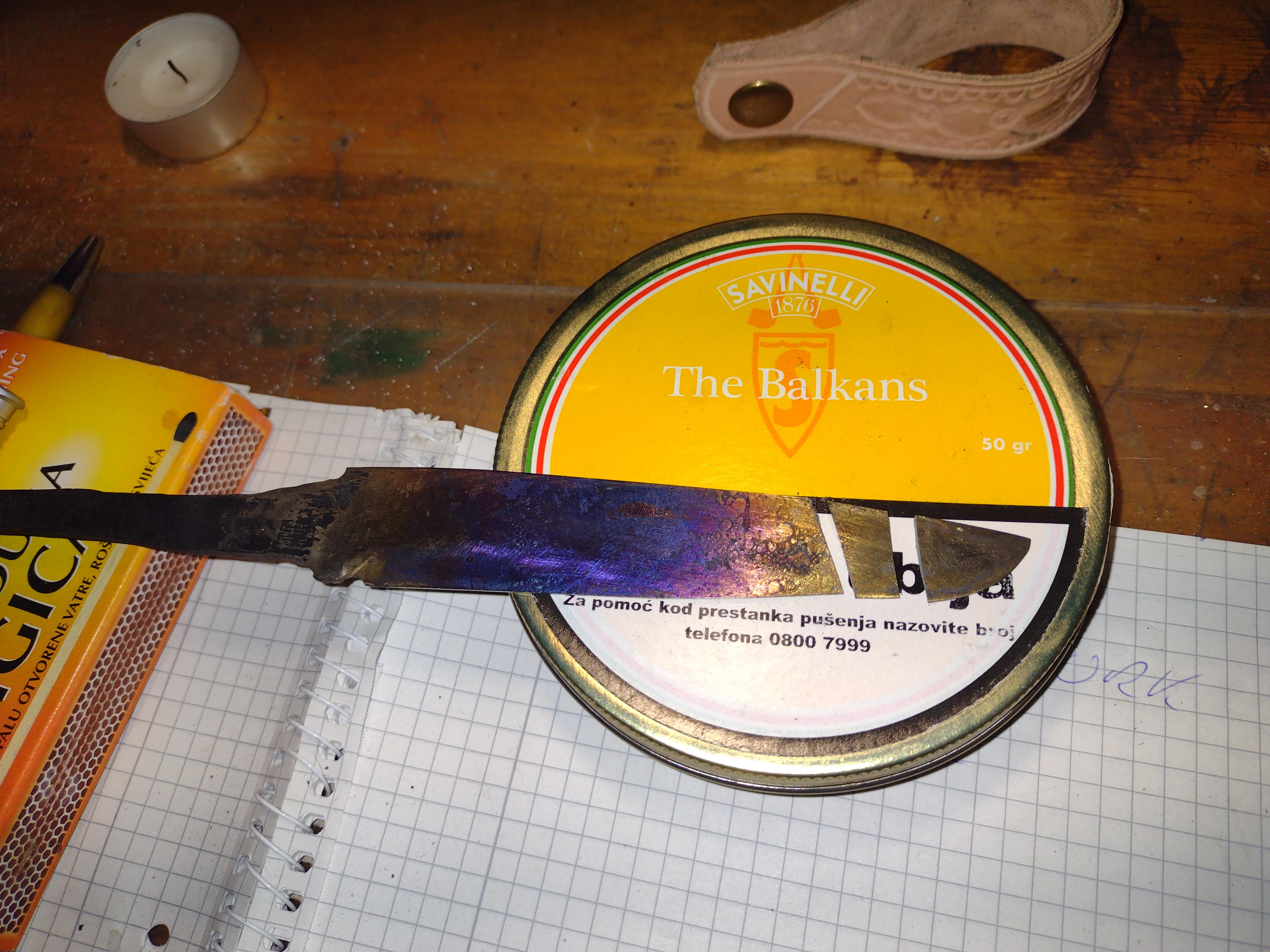

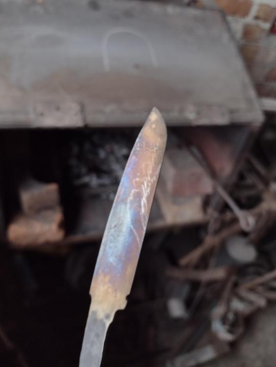

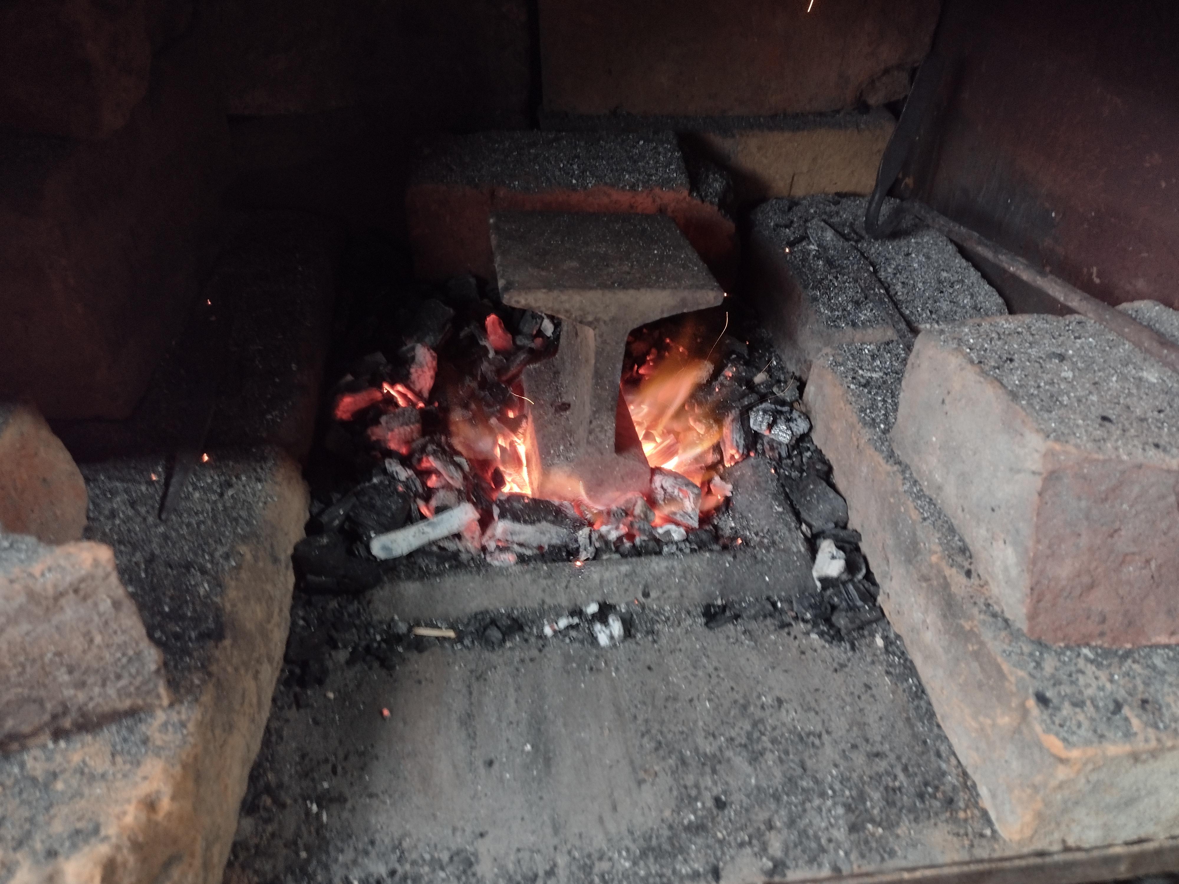

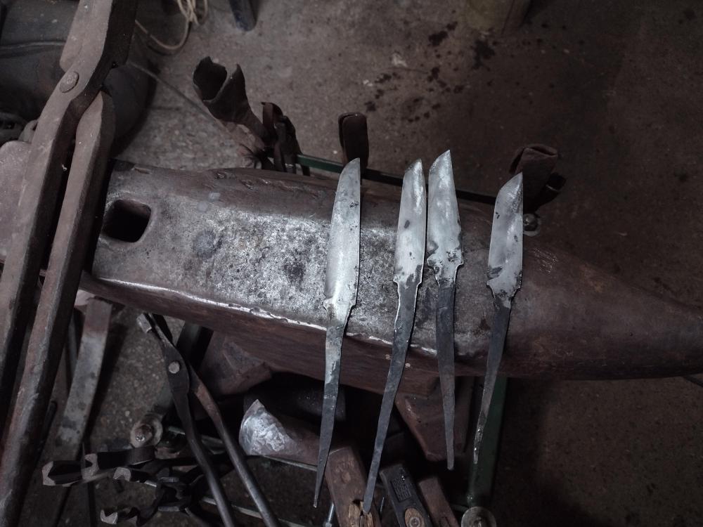

Well I had some blades I needed to harden and temper. So, I bring it up to quench temperature (magnet helps), quench it in motor oil and then I heated a chunk of steel in the forge and place the blade on it and watch the colours. Blue or close to it is fine, on the back of the blade not on the edge or the tip. And cool it in water. Now my test if it went good is: File on the back, must be soft. File on the edge, must skate or be hard. Then I clamp it in the vise and it must be flexible, last step I drop it from waist heigh tip first on the concrete. If it survives it is fine. One didn't survive, but that is nothing to worry about. Just reforge the tip.
Edited by Mod30
Resize photos
Picture of flexibility.
