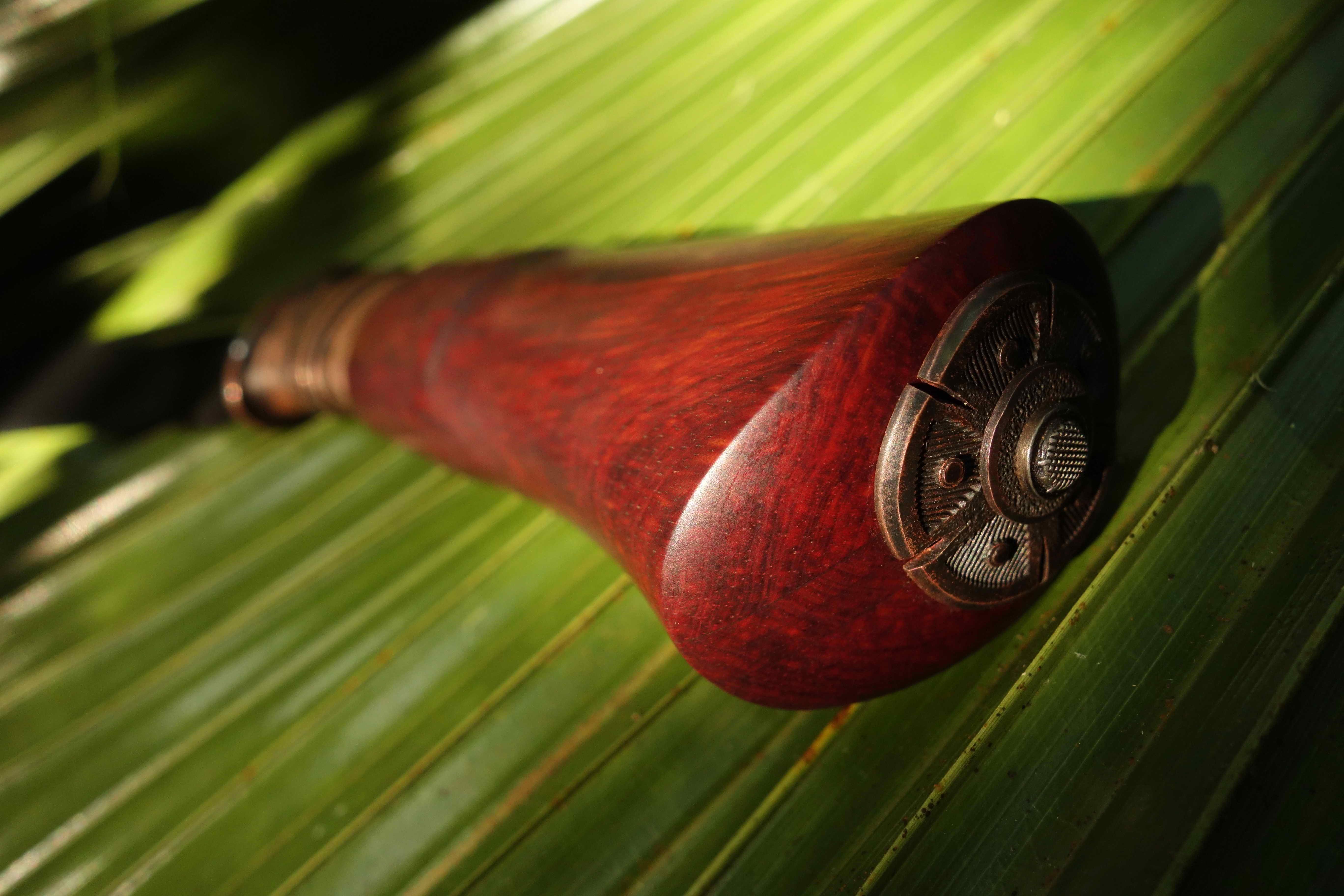

The 260 mm long blade made of 115W8 is ground convex, has a fuller and a ridge on the back.
I used Indian almond tree (Terminalia Catappa)as the handle material and copper for the real ferrule.
The tang is riveted on the butt and shows itself as a flower stamp in the copper flower.
The scabbard consists of a core made of Burmese ironwood,
the throat and tip are reinforced with cape buffalo horn and molded and sewn wet in a half tanned leather quiver.
The sheath and quiver can be separated from each other for maintenance and repair purposes,
I made the clip from fully heat-treated high carbon spring steel.
Overall length measures 410 mm.
