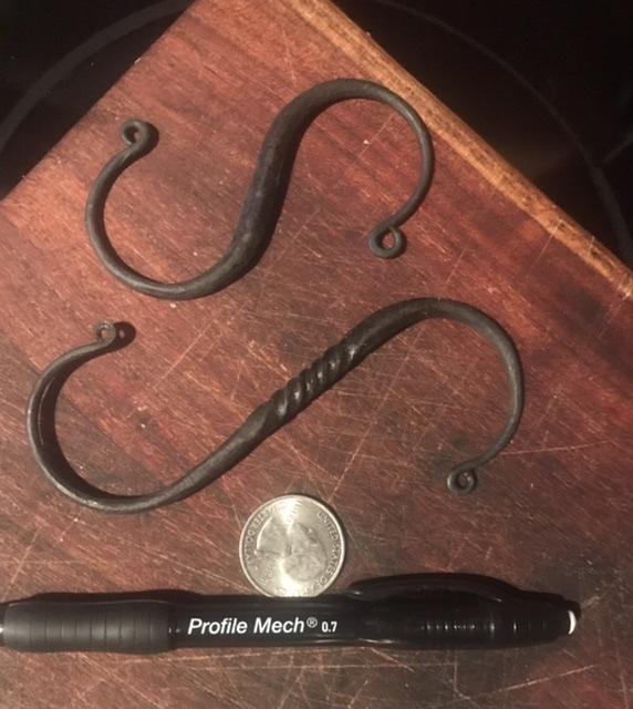

Treating little hooks
I made these hooks from a garage door spring, although far stronger than mild as is, I would to try heat treat them.
my thoughts are veggie oil quench and temper in toaster oven.
Any tips on hardening such thin stock? Thanks for looking
First, very nice.
Second, oil quench and temper to blue would probably work.
Third, why temper them at all? Normalized, they'd already be tougher than the equivalent hook in mild steel.
I think John means: why harden them and temper when just normalization will make a tough hook.  If they are hardened they should be tempered!
Yes, that's right; sorry. At least I didn't say "heat treat".

Lol, first I'd make them from mild steel. Second, if I made them from a tool steel, I'd just normslize them.
To answer your question, I would do a test piece and harden in water to see if it works.  Tom Bredlow turned me on to this. He tempers small springs with large cross section changes in corn oil. Put the corn oil in a large enough pan to cover your hooks. Then slowly raise the temp until the corn oil flashes. According to him, corn oil flashes at the temp he prefers for a spring temp. Works for me.
Corn oil has a smoke point of 457°F / 236°C, a flash point of 600°F / 315°C and a fire point of 700°F / 371°C. In the tempering color spectrum, 600°F is on the gray side of blue.

You are absolutely correct, I should have included that in my post. After quenching them in warm oil, I have my lead pot set to 700°F and verified by a lead thermometer. For very thin springs I will back the heat to 650°F then test each V spring in my hand vise by compressing them several times.
I have used Bredlow's oil temper also and it does work, it's just handier for me to turn on the lead pot which always has lead in it. The spring stock I buy from Brownells says to temper to 650°-700°F if I remember correctly.
