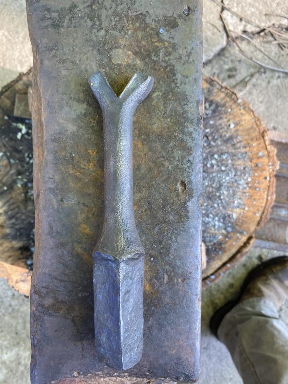

TWISTEDWILLOW Posted October 12, 2021 Author Share Posted October 12, 2021 I forgot to post on this thread, my leaf stake redo, I wasn’t happy with how it turned out so I cut it off and re forged it, this time I upset it first and then used a handled hot cut to split it from the top, I like how this one turned out better Quote Link to comment Share on other sites More sharing options...

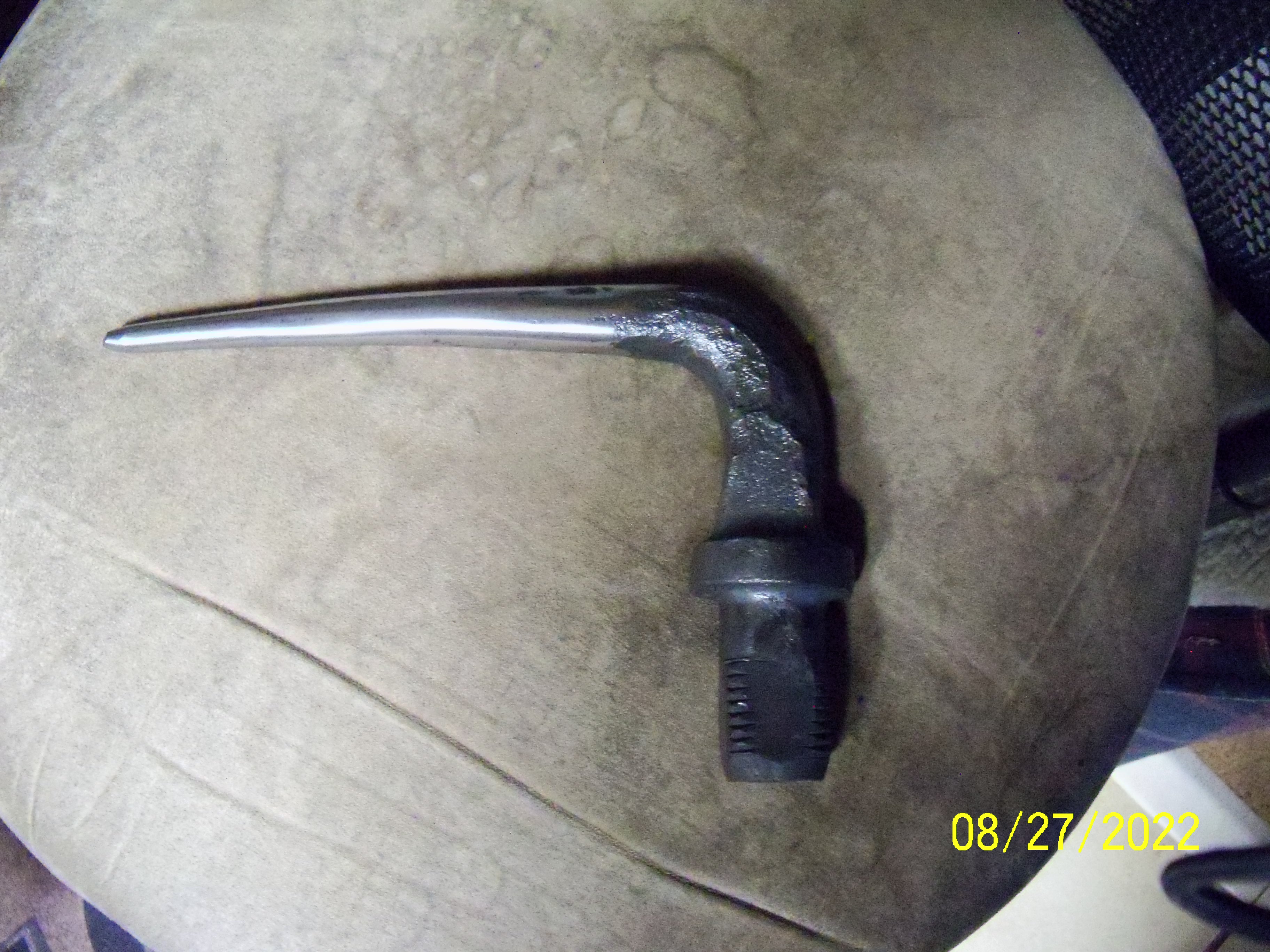

Irondragon Forge ClayWorks Posted August 28, 2022 Share Posted August 28, 2022 Most sucker rods I have run across are made from 4130 steel. Pretty hard to move with a hand hammer. If I didn't have the 30 pound Starr hammer, I would be into next week or the local ER drawing this out by hand. Quote Link to comment Share on other sites More sharing options...
Charles R. Stevens Posted August 28, 2022 Share Posted August 28, 2022 I have a set of 3# hammers for forging sucker rod, lol. One is a big radius cross pein, the second is a like radius cross pein and the third is round. They all are simple bald rounds ground from double jacks. They do an excellent job of drowning out large diameter sucker rod over the horn. I use the largest diameter for bics. Forging the coller down to 1” is the biggest pain. Forgot and cold hardiest I actually use the treaded end on the medium size stock (1” square) forging the transition on the rod end down square is easier than the flange and the treads just grind off when you sharpen it. I just let it fan out and then grind them much like an axe. Quote Link to comment Share on other sites More sharing options...
TWISTEDWILLOW Posted August 28, 2022 Author Share Posted August 28, 2022 I like it Randy! Quote Link to comment Share on other sites More sharing options...
Frosty Posted August 28, 2022 Share Posted August 28, 2022 Nice bickern Randy but you make it sound like they have a power hammer in the local ER. It gave me an entertaining mental image of you yelling out, "Nurse, FLATTER, STAT!" Nice start on a Sunday morning, thanks. Frosty The Lucky. Quote Link to comment Share on other sites More sharing options...
