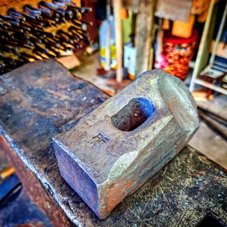

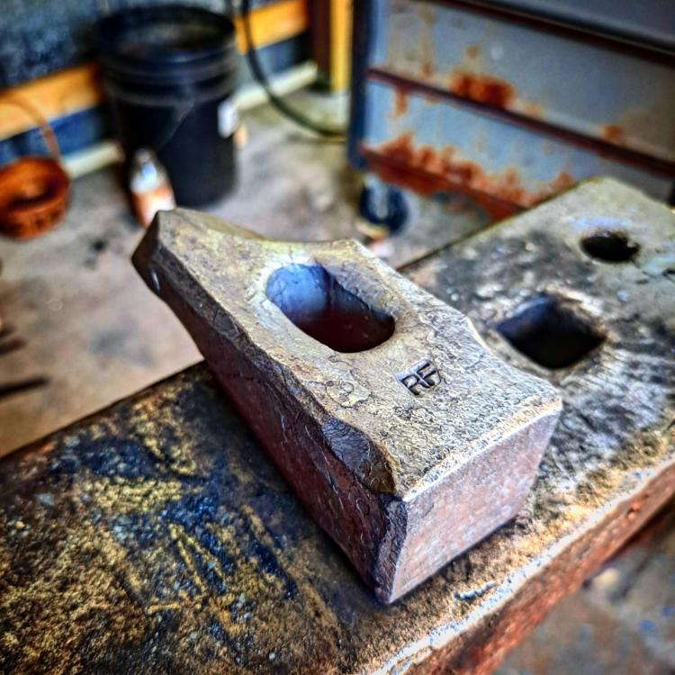

Ridgeway Forge Studio Posted June 29, 2021 Share Posted June 29, 2021 Hello all! I reached a milestone today in my blacksmithing career- my first hammer. Made from 1045, about 1.5 square, 3 inches long. I forged to shape on my press, then normalized twice. I have yet to grind, harden or temper, but I would love some feedback on how I did! The eye is about 10 degrees off of square, but I'll keep practicing! Quote Link to comment Share on other sites More sharing options...
Daswulf Posted June 29, 2021 Share Posted June 29, 2021 Looks like a good forged hammer. You'll find out how you did when it is done and you use it. Quote Link to comment Share on other sites More sharing options...
Irondragon Forge ClayWorks Posted June 30, 2021 Share Posted June 30, 2021 Looks good to me. Quote Link to comment Share on other sites More sharing options...
anvil Posted July 1, 2021 Share Posted July 1, 2021 Looks good. Clean and simple. If the eye is a bit off, you can correct that when you fit your handle. Just set your hammer handle along the centerline of your hammer. Also with a diagonal peen, it's nice to have a pair. The other with the diagonal going the opposite direction. Quote Link to comment Share on other sites More sharing options...
ThomasPowers Posted July 1, 2021 Share Posted July 1, 2021 Or a double with each face going the opposite way to the other. Quote Link to comment Share on other sites More sharing options...

anvil Posted July 1, 2021 Share Posted July 1, 2021 Not meaning to diss your nice work, but technically speaking, I'm not a fan of diagonal peens. My go to is a simple cross peen. Reason is, I'd rather move my iron to the proper prospective than add two hammers to my tools to do the same thing. Quote Link to comment Share on other sites More sharing options...

anvil Posted July 6, 2021 Share Posted July 6, 2021 2 hours ago, Frosty said: old farts vs. new tricks Actually it has nothing to do with being "Old and in the Way" or new tricks. It has all to do with how I use the other end of my cross peen... The flat face. The first step to hammer control is to be able to hit that flat face flat on the anvil. The next step is to start using the side edges of the flat face as well as the flat. Rotate the handle just a bit in your hand and you have mostly flat and a little edge. Go full bore and you are using mostly edge and very little face. As I work back to the transition, I drop the face, thus using more face as I approach the transition. Thus I use the flat face as a straight peen and a flat face. This means that my cross peen hammer serves three purposes: a cross peen, a straight peen with an infinite number of angles, and a flat face. If you apply this to a straight peen, you have a straight peen on one end, a multi-angled straight peen/fuller, and the flat face. Make sense? "Old and in the way" is a great ole album and still on my phone so I can play it whilst in the car. Quote Link to comment Share on other sites More sharing options...
