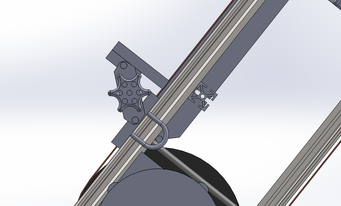

SinDoc Posted April 27, 2021 Share Posted April 27, 2021 Just wanted to share this. One of my good friends is a engineer who after finally finishing his some 10 years in college, decided to open a machine shop. I had off hand mentioned I wanted a grinder, but couldn't find any that I thought were affordable. He offered to make me one for next to nothing mostly to test his process and make sure it was up to snuff. He mostly worked on it during his down time and well, its nearly done! What are your guys thoughts? I think he did a dang good job. Granted, it still needs guards and such but its 90% done. Uses a 1/3 hp variable speed motor with custom variable speed control he built. 1750 rpm and ~3600 sfpm. Frame is Hiwin linear rails that were no longer usuable for CNC applications. The rollers and other misc parts are 3D printed and filled with granite epoxy. Quote Link to comment Share on other sites More sharing options...
ThomasPowers Posted April 27, 2021 Share Posted April 27, 2021 Looks like he built a woodworking one and not a metalworking one. I see neither a platen nor a contact wheel and 1/3 hp is WAY underpowered. I would suggest they look at plans created by people who have experience using them. 1.5HP is suggested! How is the belt tensioned for quick changes? Quote Link to comment Share on other sites More sharing options...
Buzzkill Posted April 27, 2021 Share Posted April 27, 2021 Interesting design. A couple thoughts though. If it has a belt tracking adjustment I didn't spot it in the photos. The variation in belts makes that a necessity. Secondly you will need a flat platen, but I assume there is a plan for that. Most importantly, that is not nearly enough HP for a 2x72 belt grinder. You really want to be in the 1.5 to 3 hp range if you plan to do any real grinding. I stalled a 1 hp motor frequently with moderate pressure before I upgraded. Looks like TP beat me to it and with pretty much the same issues. Quote Link to comment Share on other sites More sharing options...

SinDoc Posted April 27, 2021 Author Share Posted April 27, 2021 The belt tracking and such has yet to be put on. Its what he is working on today. This was kind of just the "shell". The platen has yet to be put on as well. He was curious if the motor would be up to par with it. Once he gets the rest done and can test it, he has other motors on hand to swap with. He may have done calcs based on a 3 phase motor which to my understanding has a little more oomph behind it. Ill have to ask. Quote Link to comment Share on other sites More sharing options...
ThomasPowers Posted April 27, 2021 Share Posted April 27, 2021 Horsepower is horsepower, however torque can differ. And belt tensioning and quick change capabilities? Quote Link to comment Share on other sites More sharing options...
Buzzkill Posted April 27, 2021 Share Posted April 27, 2021 Keep in mind that the size of the drive wheel makes a big difference in speed and power. The bigger the drive wheel the greater the speed (surface feet per minute), but the lower the effective power. Normally you see drive wheels in the 3 to 5 inch diameter range even with 2 or 3hp motors powering them. Quote Link to comment Share on other sites More sharing options...
SinDoc Posted April 27, 2021 Author Share Posted April 27, 2021 The belt tension system I believe he said isnt on yet either. I believe he said he is going to have the upper wheel utilize the rail to slide up and down to apply tension and allow quick and easy changing of the belt. Quote Link to comment Share on other sites More sharing options...
SinDoc Posted April 29, 2021 Author Share Posted April 29, 2021 I relayed the concerns you guys laid out to him and he is making a few design changes. He is going to test the motor and see how easily is stalls out then swap it if needed. I slightly jumped the gun on the completion. I guess it is only roughly 60% complete and not 90% as he still has a decent bit of stuff to do . I believe he said he took inspiration from Grizzly and their models and set rpm/fpm based off Red Labels website which states hard and hardened steel is between 1560-2940 fpm. I looked and they also list carbon steel as 4920-8820 fpm. Should he had shot for that one? Quote Link to comment Share on other sites More sharing options...

SinDoc Posted May 19, 2021 Author Share Posted May 19, 2021 More design progress! The backplate (not sure what the actually technical name is) has already been made and installed. Next is the work deck that should be attached today. Confirmed with my friend that the tensioning system works via the threaded rod and the top wheel. Using the knob allows the wheel to be moved up and down for quick tensioning and belt changes. He was able to stop grinding an item and change the belt out very quickly. He tested the tracking and it tracked beautifully. After more testing, we upgraded to a 1HP motor but it still bogs down a little bit when applying a lot of pressure to really hog off material with the 40 grit belt. Edit: I know you guys had mentioned the right HP for the motor, but 1HP was the biggest he had laying around. I am hoping to try it out and if it still is a problem, I will have to purchase a higher HP and send to him to be modified/fitted to the machine. Still trying to use what he has laying around and is free . Quote Link to comment Share on other sites More sharing options...
