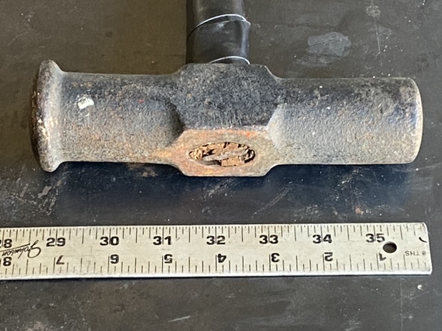

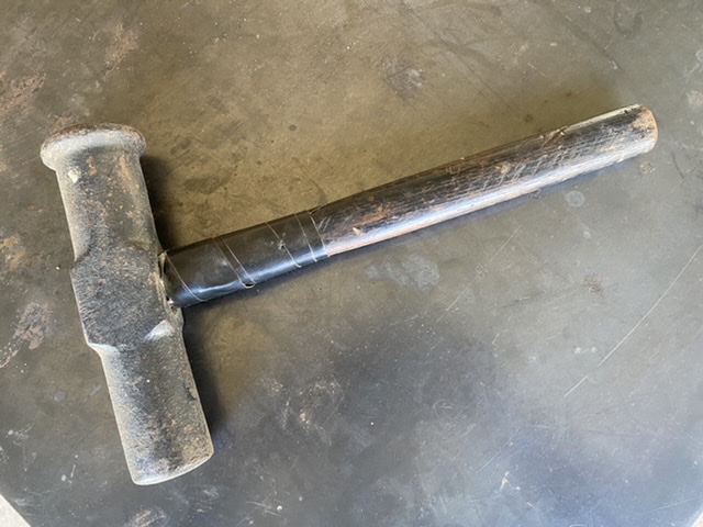

JHCC Posted March 20, 2021 Share Posted March 20, 2021 When I was starting out as a teenage smith, I had a hammer like this one. I used it as a big rounding hanger for heavy smashing jobs, but it was one of the tools that got left behind when I left New England in ‘92. This one was in a bin of hammers I got at the industrial surplus place yesterday. It’s very similar to my old one, although possibly a hair smaller and with the enlarged face on only one side rather than both. Anyone ever seen a hammer like this and can give me an idea about what it might have originally been for? Quote Link to comment Share on other sites More sharing options...
Irondragon Forge ClayWorks Posted March 21, 2021 Share Posted March 21, 2021 A friend of mine had one and he was a retired Boilermaker. Quote Link to comment Share on other sites More sharing options...
JHCC Posted March 21, 2021 Author Share Posted March 21, 2021 Interesting. Quote Link to comment Share on other sites More sharing options...
swedefiddle Posted March 21, 2021 Share Posted March 21, 2021 Wine barrel bungs. Neil Quote Link to comment Share on other sites More sharing options...
JHCC Posted March 21, 2021 Author Share Posted March 21, 2021 I believe bung mallets are usually wood with metal bands, rather like a fatter version of a caulking mallet. Quote Link to comment Share on other sites More sharing options...
Frosty Posted March 21, 2021 Share Posted March 21, 2021 I've seen them as boiler makers or plate hammers, often as double jacks. I have one somewhere but it's heavier than I generally use. Handy when you need a little authority. Frosty The Lucky. Quote Link to comment Share on other sites More sharing options...
ThomasPowers Posted March 22, 2021 Share Posted March 22, 2021 Boiler makers for seating fire tubes for fire tube boilers. I have 2 on my rack. Both sourced in Ohio as I recall. I wonder if Lima was rife with them? Quote Link to comment Share on other sites More sharing options...
JHCC Posted March 22, 2021 Author Share Posted March 22, 2021 Interesting. I got the first one at a flea market in the Hudson Valley in NY, if memory serves. Quote Link to comment Share on other sites More sharing options...
anvil Posted March 22, 2021 Share Posted March 22, 2021 It would make a great drift. I think I've seen that shape of hammer used setting spikes to hold rr track in place. Quote Link to comment Share on other sites More sharing options...

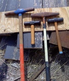

ThomasPowers Posted March 22, 2021 Share Posted March 22, 2021 I have examples of both the spike setting hammers: cylindrical and sq/octagonal ones and the boilermaker's hammers. Here are pictures of the boilermaker's hammers and the spike hammers together: The domed on both faces of the boilermaker's hammers would be hard to drive a spike straight with; the spike driving hammers have flat faces. Quote Link to comment Share on other sites More sharing options...
JHCC Posted March 22, 2021 Author Share Posted March 22, 2021 Yessir, that's my baby. Should be good for heavy dishing, if nothing else. Quote Link to comment Share on other sites More sharing options...
Irondragon Forge ClayWorks Posted March 23, 2021 Share Posted March 23, 2021 For once I got the ID right. When I saw the picture it brought back a long lost memory of "Average Chandler" nickname of my friend the retired boilermaker. Haven't seen or heard from him in decades. Quote Link to comment Share on other sites More sharing options...
