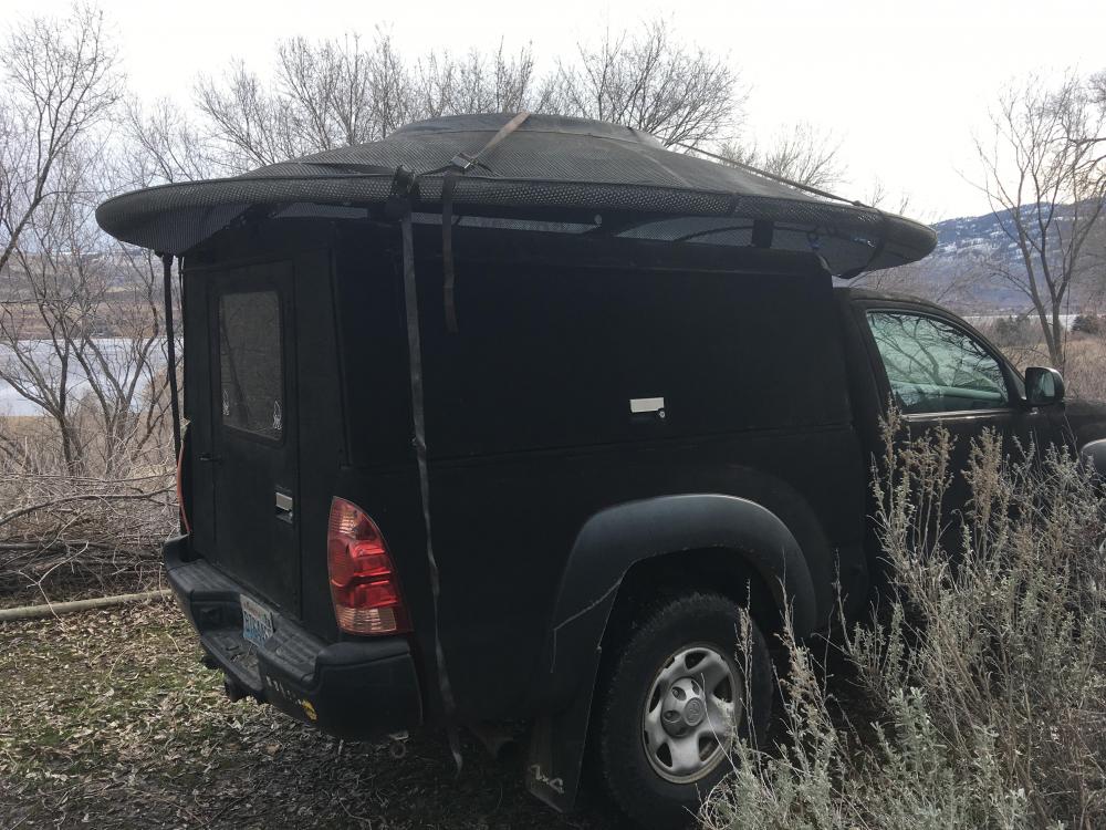

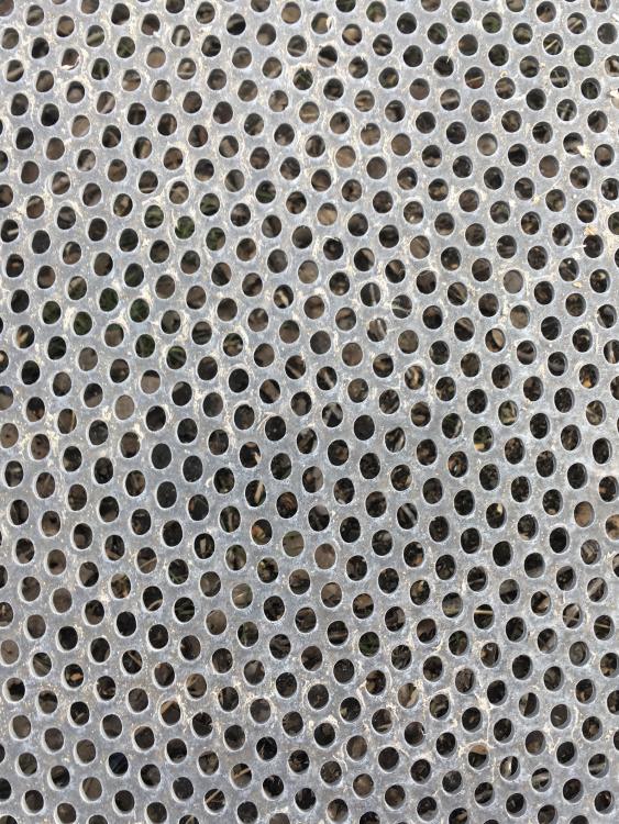

Thanks for responding folks, progress as follows.  Picked up dish this morning.  Plenty of tin foil hat jokes with it transported on top of my truck.  Real thickness is 1/8” and 9’ diameter.  If you step on it it dents but springs back ito shape.  Center aluminum cover was welded to mesh; used angle grinder to weaken weld then hammered chisel through,  hard one hour of deafening pounding but only mesh left now.  Edges rolled for strength.  Have a brush burning torch to heat and bend maybe over log to get cone.  So once cone is achieved heat up over fire pit then cool quickly with water, is that annealing?image.thumb.jpeg.b0ed9959e0ef976f27eb3dde8a11ae8c.jpeg

Not sure on type of aluminum alloy.  When I used angle grinder to weaken welds to remove aluminum cap, had to be careful not to cut through mesh.  Seems soft when heated with angle grinder.  Mesh is strong but flexes with 20lb pressure.  Will use reciprocal saw and try to bend by hand /with torch heating.  Here’s a good laugh, wife said I am taking this tin foil hat thing a little too serious, pic.

Now, i would have left it strapped down to the truck, taken it to the scrap yard and exchanged for the equivalent in sheet steel.

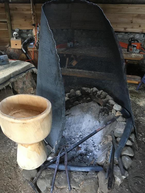

Worked all day in shop.  Reciprocal saw cut aluminum easily, then split dish in equal sections then cut off curled ring off bottom shroud.  Bent by stepping on inside and pushing, didn’t need come along.  Anealed over fire pit then moved outside and bent again by body weight.   Micro fit around fire pit and bent edges.  Added cutoff curl too.  Made fire much hotter.  Forged without gloves but still got too hot a few times.  Worked ambidextrous both sides of anvil, moving material constantly.  Ball pien hammer is fun.  Made point on poker, worked tongs, shattered aluminum motorcycle bonz, chainsaw carved djembe drum and drummed a little too.  Hands sore a good day.  Aluminum fumes?
Sounds like you're having way too much fun in your shop. Glad that dish turned out to be easy to work. You might want to take a file to the cut edges before you or someone else brushes into it and christens it in blood.
