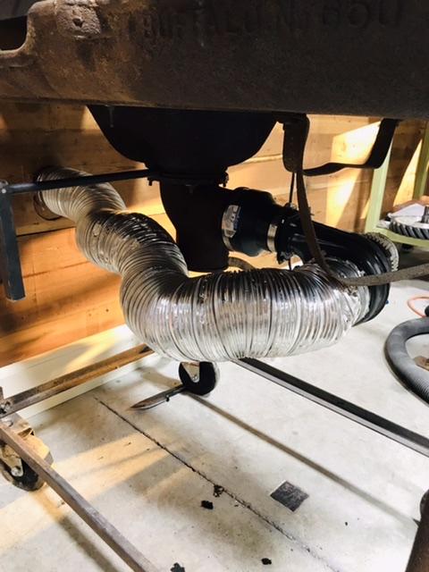

I got the blower setup with outside air and motor controller, installed a new clinker breaker and the bar. I only made one temporary handle for the bar on the clinker breaker. I need it to be functional for now, but want to make something more functional and aesthetic for both sides of the forge.
DBB607C6-1528-48EF-877C-B1362BB9F193.jpeg.427aa680a88b8878834c561051102d4e.jpegD06EB28B-16EA-4433-82C5-79E91A557B44.jpeg.9b4d88df44a6f2549955ff8461051e3a.jpeg
Of course I need to lengthen the cord on the blower and mount the motor controller (I think between the front all-thread holding the hood), and remake the original blower mounts to properly support the new blower.
The more I get done, the more I find needs done…
Maybe tomorrow I can get the wire changed out and do a test fire to make sure my hood drafts properly. If it doesn’t… I probably be back for advice!
