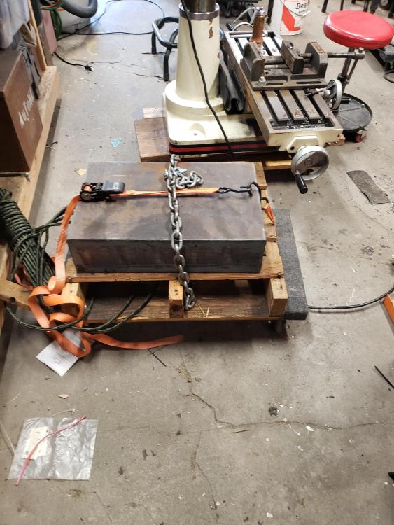

Well.....first try getting out of the truck....not so good. All I managed to do was tip it over...shoot.. now I have a 550 lb pancake that is no longer on the pallet aaaaannnnd still in the bed of my xxxxx truck!!!. So I gotta re-think this process. The magnetic lifting eye won't be here til nov 5th. I guess I could back up real fast slam on the brakes and hope it doesn't destroy my tailgate and bumper although I don't think I can build up enough speed to do it. No not really..... just a little frustrated right now. Gonna look at it tomorrow. I might weld a eye on it. Use a lever and fulcrum to lift it up enough to get a chain around it.  I have access to a mag drill I could drill a couple of 3/4 in holes in it and weld round stock for a handle. We'll see. Thanks for letting me vent. I'll let yuall know how it goes (-:《
Veyser:  When moving that hunk of steel, particularly by yourself,remember that the pyramids were built with simple machines, levers, rollers, inclined planes, and skids.  I have moved similar sized pieces of stone by levering it up onto several rollers (3" diameter pieces of fence posts) and pushing it with my wife and son moving the rollers from the back to the front.  It needs to move slowly but it works surprisingly well.
As I said previously, be careful!
"By hammer and hand all arts do stands"
Rollers and cribbing are two important shop tools people often don't think of.  Using them I have loaded a powerhammer into my pickup all by myself; though I did use a come-a-long for the starting lay-down.)

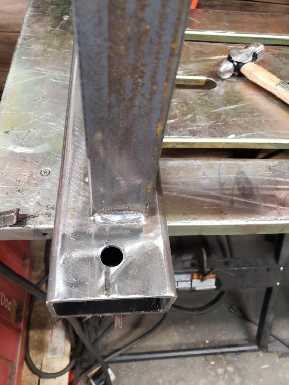

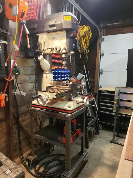

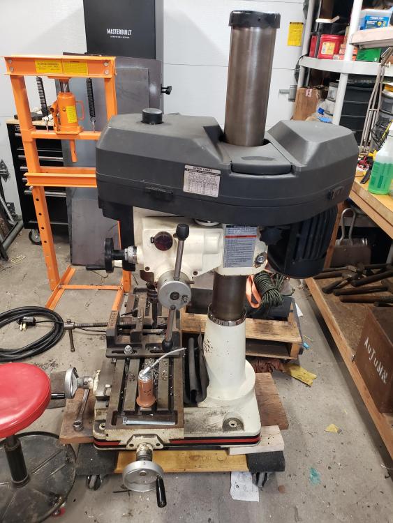

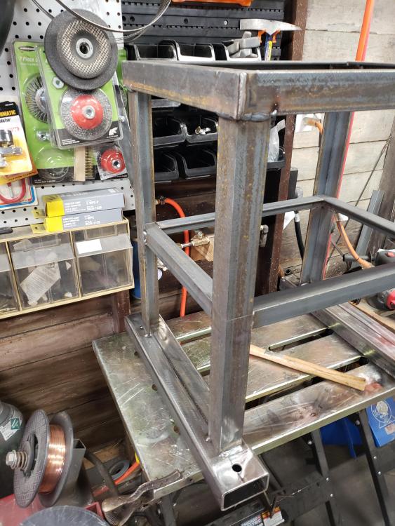

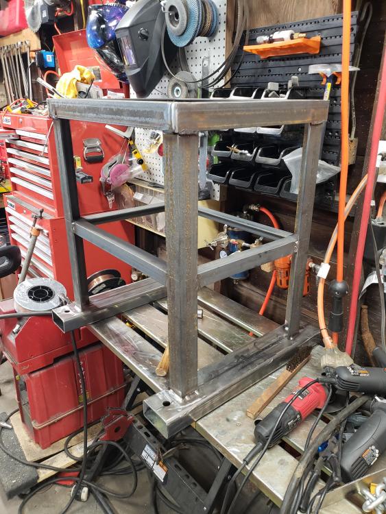

Oh yay I got that big block of steel out of my truck and back on the pallet on a dolly. Didn't wreck anything. Turns out my ability to measure was impaired. Its 20x14x5 hardend steel block 400 lbs. I also bought a mill from the fabrication shop. I'd practice building a stand for the anvil by building a stand for the mill. Almost done. My shops a little crowded thinking about putting the anvil and eventually the forge outside under a lean-to. I think I'd like to build a metal stand for the anvil. probably better if its gonna live outside. Plus I want to kind of steam punk it up. Give it a riveted look.
Pretty  nice job o the stand. When you make one for the anvil turn the angle iron over on the spreaders so you can lay a piece of screen or expanded metal in it for a cool down shelf.. Of course a plywood shelf is handy too but it's nice to have a safe place to toss: hot tongs, pieces of stock tools, etc. to cool gradually.
Looks like a nice little mill.
Good job on the stand and getting the anvil & mill. I would mount the anvil on edge with the 14 in under the hammer & stock, it will have a very good sweet spot and plenty of surface to play around with.
