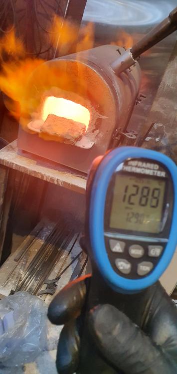

Mikishelby Posted February 20, 2021 Author Share Posted February 20, 2021 got the forge covered with 2 layers it goes up to 1300 o nearly finished building the grinder should have to grinder finished tomorrow Quote Link to comment Share on other sites More sharing options...
Mikey98118 Posted February 20, 2021 Share Posted February 20, 2021 Your exhhaust appears to outgassing some calcium binder. Please send another photo after is get done with that; it will make a neat visual record of the phenomenon. Quote Link to comment Share on other sites More sharing options...
Frosty Posted February 21, 2021 Share Posted February 21, 2021 That's what it looks like to me. Frosty The Lucky. Quote Link to comment Share on other sites More sharing options...
ThomasPowers Posted February 21, 2021 Share Posted February 21, 2021 Was that degrees Kelvin, Fahrenheit or Celsius? Quote Link to comment Share on other sites More sharing options...

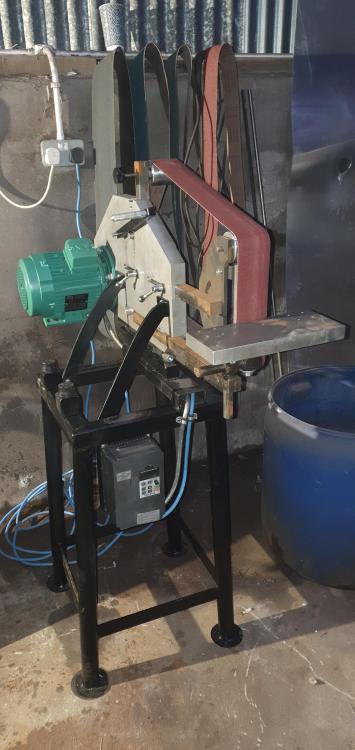

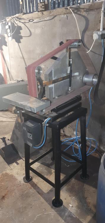

Mikishelby Posted February 21, 2021 Author Share Posted February 21, 2021 thats celcius ... 1285 celcius 2345 farenheit is this good? I have not run the forge today focused on finishing the grinder and finally the build is completed. Grinder is all made by myself and my good friend from start to finish, plenty of hours spend on makining it but I am very pleased with how it turned out.. its on a hinge so can flip it down as well Quote Link to comment Share on other sites More sharing options...
