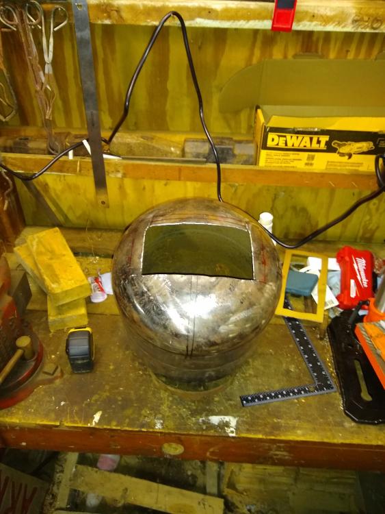

For a number of reasons I have begun putting together a propane bottle forge. Mostly because I found an old propane bottle in the brush on my property and also because this winter I would like to have both coal and propane forges to practice with, because sometimes it is just too cold to putz around trying to light anthracite coal.
I have begun by cutting out the front forge portal, cutting the rear through-port for longer stock, and taking the front off to accommodate installing the liners. The front will be welded back on once the insulating blanket is installed, and the rest I plan to apply through the opening. I have been considering whether to open it up with a side hinge like WayneCo suggests in his build, but there is time to decide.
The front opening is roughly (really roughly) 4in. x 7in. and the rear one is 1.75in. x 3in. The idea is to use k26 firebrick with protective coating as a door for both sides. I will fabricate an actual door once I get the thing working properly.
Reading the forums I have a pretty good idea about the proper method of lining the forge and the right materials that I plan to order from Glenn soon, but the issue I have is the burners.
Ihave read up on Frosty's T burners and I am confident I could follow those directions. (As a sidenote, excellent directions and well put together. Thank you.) However, I did some pricing and with the parts I would need for two burners, the correct sized drill bits, and the tapping tools, it would cost me a good amount of money out of the gate. Admittedly I would then be able to make more of them, but the idea for me is to only need the ones I have. The rub is that I can find T burners online for around $50 for two already assembled. Any extra cost would only be for hookups to the fuel source which I would need for DIY ones anyways. Does it seem reasonable to purchase ones online? Or am I just being a bit too frugal? I did the same cost analysis for the forge body itself and because I already have all the tools necessary it was cheaper to make it than buy it. I personally don't trust the burner sellers because the burners are likely made in China, but for the price and fact that I can return them if they don't work, it seems silly to spend more to work harder. Just looking for some wisdom on this front.
Anyways, here are some pictures of the hack job. Before anyone points it out, yes I am in fact terrible with an angle grinder. :P

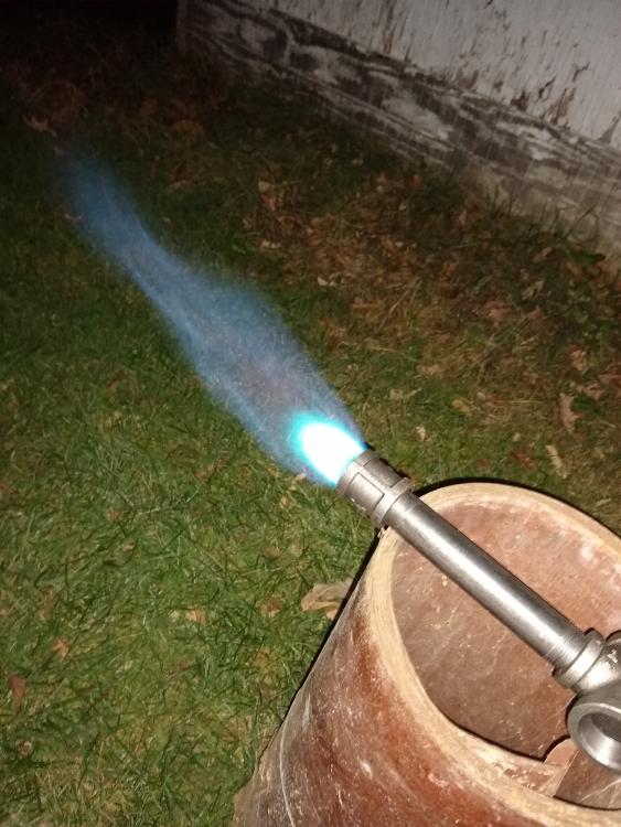

So, it's been slow going but I am continuing to work on my propane powered propane bottle forge. I haven't done much else with the shell but I have been working on a pair of 3/4" Frosty T-burners. I have been using my coal forge to practice my smithing and making Christmas gifts, so I have not been able to focus on this project as much as I'd like.
I only have one fully assembled so far, and it "works" as in it all goes together, connects to a propane tank, produces a flame somewhat, and doesn't explode. I admit that I might need to drill and tap another T for it because I didn't get it quite as straight as I would have liked.
The flame at this point is unstable at best. I don't plan to really work on tuning it until I have a forge to put it into. At 3+ PSI the flame just shoots off the end of the burner. I can hold the lighter at the end and it looks nice and sounds good, but as soon as the heat source is gone it's just blowing out propane. If I drop the pressure slowly it will light and stay for a few seconds but with no obvious "oompf" then start to flutter till it goes out. If I drop it low enough the flame backs into the T and I have to shut the valve off. My guess is that it's too rich because I have the mig tip cut back only just so that it's halfway to the mixing tube. Figure I will wait till it actually has back pressure in the shell to tune further.

Just posting a couple more pictures and giving some numbers.
Did almost exactly how Frosty and Spanky described in the PDF. Just had to do some different things to hook up to the propane.
1" x 1" x 3/4" steel T (found it at Home Depot, surprisingly)
3/4" pipe nipple, 6" long
Added a 3/4" coupling at the end because I intend to use it to attach to the forge shell
.035" Hobart Mig tip from Tractor Supply (snipped a tiny bit, will do more once it's in the forge)
1/8" MIP Hex Nipple (Everbilt brand from Home Depot, along with all the other brass)
3/8" MIP x 1/8" FIP Hex Bushing
3/8" Flare x 3/8" FIP Coupling
0-30 PSI propane regulator with gauge (Amazon for 20 bucks)
Took a little while to get the taps and tap handles before I could start the project. Only issue I ran into is that when I went to drill the hole in the T, I believe I didn't have a large enough punch mark and the drill walked a little bit. It's off just enough that the tap didn't go in as true as I would have liked. I figure next time I will recruit my friend who has a full sized machining lathe to help with that step. That or I will punch it harder, use a smaller drill first for a pilot hole, then try again. The press vise makes it much easier to keep it straight but maybe I will use the floor flange method? Who knows!
I also believe that I tapped the T a little too deep. The NPT tap is tapered and I kept going a little deeper, backing it out, and checking with the nipple. It wouldn't even go in for at least five attempts so I think I got a little over-zealous because now to screw it tight the face of the nipple is at least a quarter inch inside the T behind the mig tip... Oops!
It's all good, I am having fun toying around with it so I guess that's a plus. I still need to get the forge itself built so it is not a rush job or anything.
I have been on cut hours at work because of the downturn in demand for aerospace parts so I have to save my pennies to move from one step to another on this project. I still need to order the lining components from Glenn but I am confident that once I get them I will be able to assemble the forge relatively quickly. I am not going to cut up the cylinder any more, the front that I cut off I am going to attach with a hinge and a latch that I will weld or bolt on. That will be my means of inserting odd shaped stock and replacing the liner when that day arrives.
I do have one question though before this ramble ends. How far apart should the burners be from one another? I assume that they should be relatively evenly spaced in the center of the actual cylinder lengthwise, but not sure how far apart to drill the burner holes. I intend to have them mounted facing at a downward angle. I also intend to cut the holes large enough that I can upgrade to a 1" burner if I need to in the future.
Anyways, here are some more pictures. I hear you guys and gals like pictures.
Looking GOOD! Almost tuned to the nines. You got the jet straight down the pipe, excellent.
