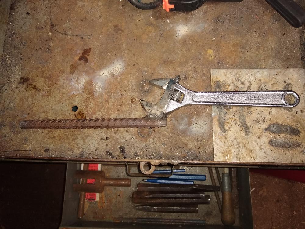

  1. That's true. Probably will just let it be then. Welding is all done and I don't want to deal with a hazmat incident this month. Buying a ford wrench online is likely not going to happen, since I can make due with this wrench and maybe make a few sizes of the traditional style ones. My wife is still on a day-walker schedule so maybe I will give her a picture of a ford wrench this spring and summer to do hunting while at sales and such. Assuming the plague doesn't keep everything closed for another season.

  3. Alrighty, lots of good input. Firstly, you were all totally correct about which side I welded it to. That evening I had been wandering my local Walmart and saw a ~$3 adjustable wrench and thought "I need something to twist with. I wonder if that chunk of rebar is still in the shed?" And away I went with a half thought through plan. My first thought was the galvanized coating. I put on my PPE and ground the area I was planning on welding clean and the area around it. I figured I could worry about the rest later if this worked. I then spent half an hour or more learning that my welding area sucks and I need to do something about that at some point so I can hold my work where I need it. After fumbling with the wrench and steel for a while, I got it welded, snapped the picture, and went inside to post this thread before bed. Didn't get back to the garage till this weekend and when I did I looked at my wrench and realized exactly what y'all pointed out. So, I hacked off the offending end, safely ground the opposite side, swore at my welding area for a while, and now have the wrench sitting in a vinegar bath for a day or so. I also cut the rebar to length, removed the rubber material, and filed all the sharp edges as were suggested. I agree also with using a nice monkey wrench (not pipe) but I have not seen one in a long time outside of full price online. I don't get out to sales like I used to since I went on overnights a couple years ago. However, I feel this one will work for me in the short term. I'm on the early end of the smithing learning curve so I have time to pick up better tools as they become available/essential. Safety first kids!

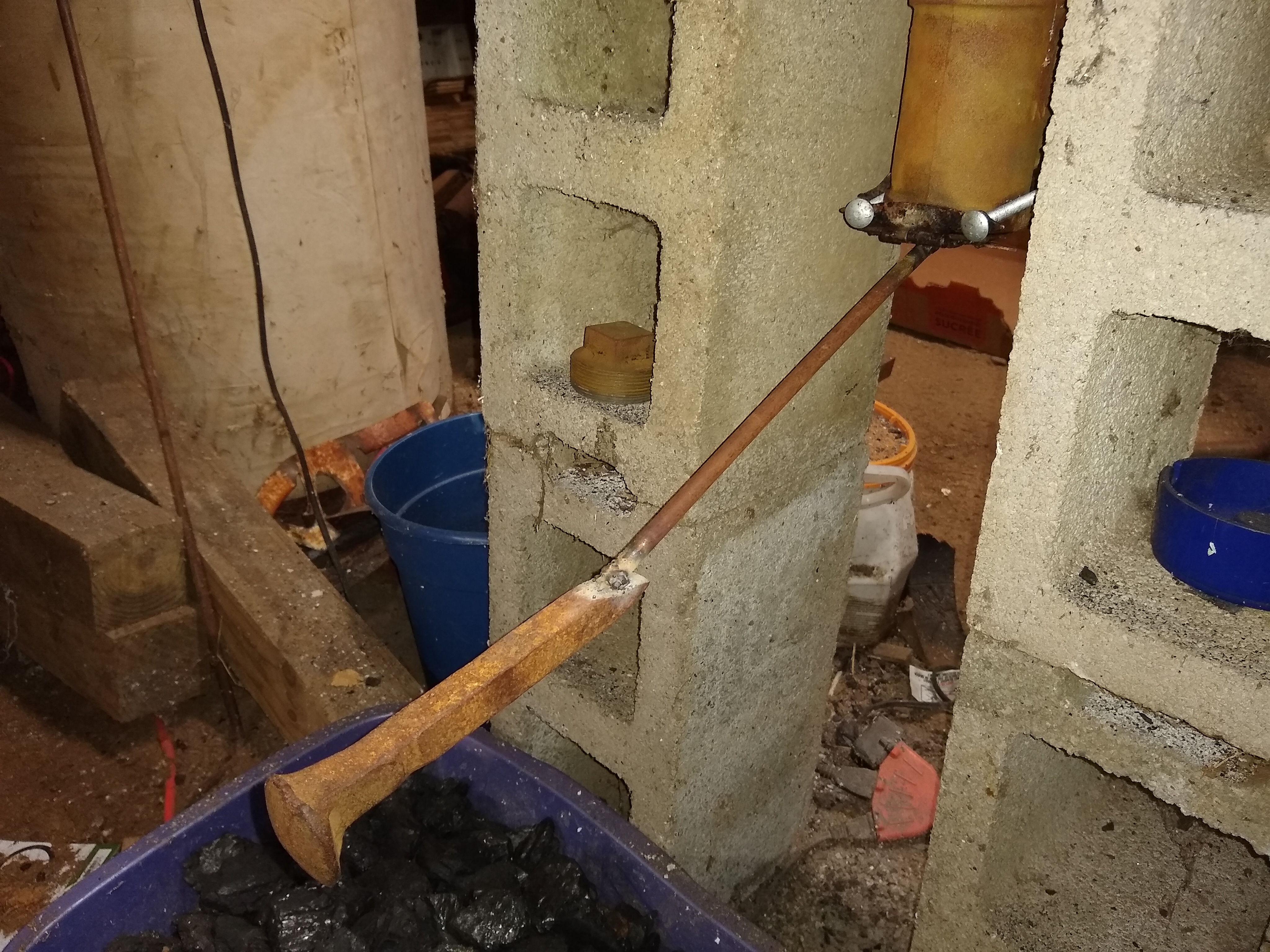

  14. Just because I remembered that a couple different people mentioned it on this thread, I wanted to point out that I added the 4in. pipe nipple that was suggested for ash accumulation. I also welded the flap hinge that I fabricated directly to the nipple so that it is more secure. And I left the railroad spike at the end of my handle only because I think it looks neat. If I am ever hurting for scrap steel I can always hack it off in case of emergency! Also, the vent pipe works great.

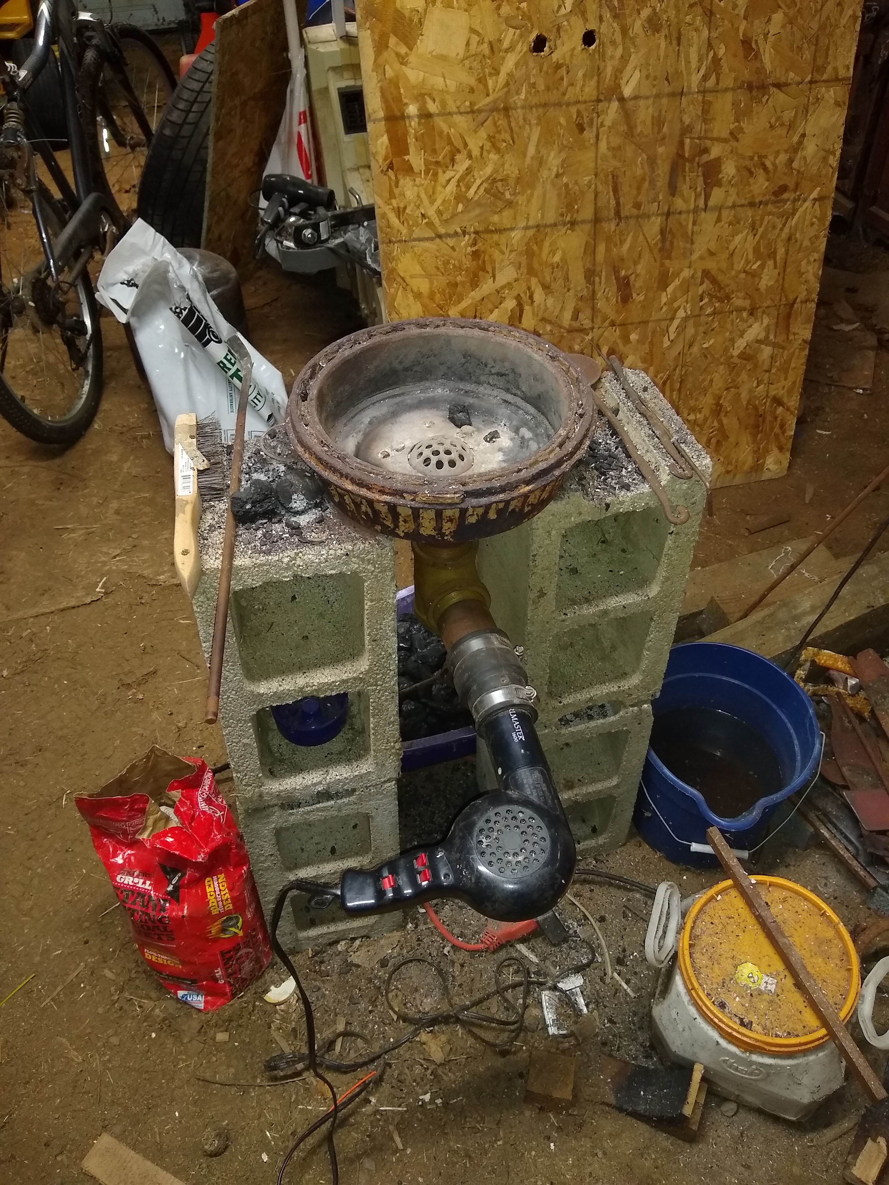

  15. For a number of reasons I have begun putting together a propane bottle forge. Mostly because I found an old propane bottle in the brush on my property and also because this winter I would like to have both coal and propane forges to practice with, because sometimes it is just too cold to putz around trying to light anthracite coal. I have begun by cutting out the front forge portal, cutting the rear through-port for longer stock, and taking the front off to accommodate installing the liners. The front will be welded back on once the insulating blanket is installed, and the rest I plan to apply through the opening. I have been considering whether to open it up with a side hinge like WayneCo suggests in his build, but there is time to decide. The front opening is roughly (really roughly) 4in. x 7in. and the rear one is 1.75in. x 3in. The idea is to use k26 firebrick with protective coating as a door for both sides. I will fabricate an actual door once I get the thing working properly. Reading the forums I have a pretty good idea about the proper method of lining the forge and the right materials that I plan to order from Glenn soon, but the issue I have is the burners. Ihave read up on Frosty's T burners and I am confident I could follow those directions. (As a sidenote, excellent directions and well put together. Thank you.) However, I did some pricing and with the parts I would need for two burners, the correct sized drill bits, and the tapping tools, it would cost me a good amount of money out of the gate. Admittedly I would then be able to make more of them, but the idea for me is to only need the ones I have. The rub is that I can find T burners online for around $50 for two already assembled. Any extra cost would only be for hookups to the fuel source which I would need for DIY ones anyways. Does it seem reasonable to purchase ones online? Or am I just being a bit too frugal? I did the same cost analysis for the forge body itself and because I already have all the tools necessary it was cheaper to make it than buy it. I personally don't trust the burner sellers because the burners are likely made in China, but for the price and fact that I can return them if they don't work, it seems silly to spend more to work harder. Just looking for some wisdom on this front. Anyways, here are some pictures of the hack job. Before anyone points it out, yes I am in fact terrible with an angle grinder.

  17. Also, I finished my ash dump contraption. I made a bracket to secure the flap I forged out of the mower blade using old kitchen hardware. Drilled out the holes to put two bolts through a cabinet door hinge on the flap and a drawer handle on the opposite side of the pipe. Then I secured it around the bottom. I can disconnect it and move it once I get a length of pipe for ash collection as mentioned. I welded a bar to the bottom of the flap and welded a railroad spike as a counterweight. Best part is that it seems to actually work! And don't mind my ugly welds, I am just as new to welding as I am smithing!

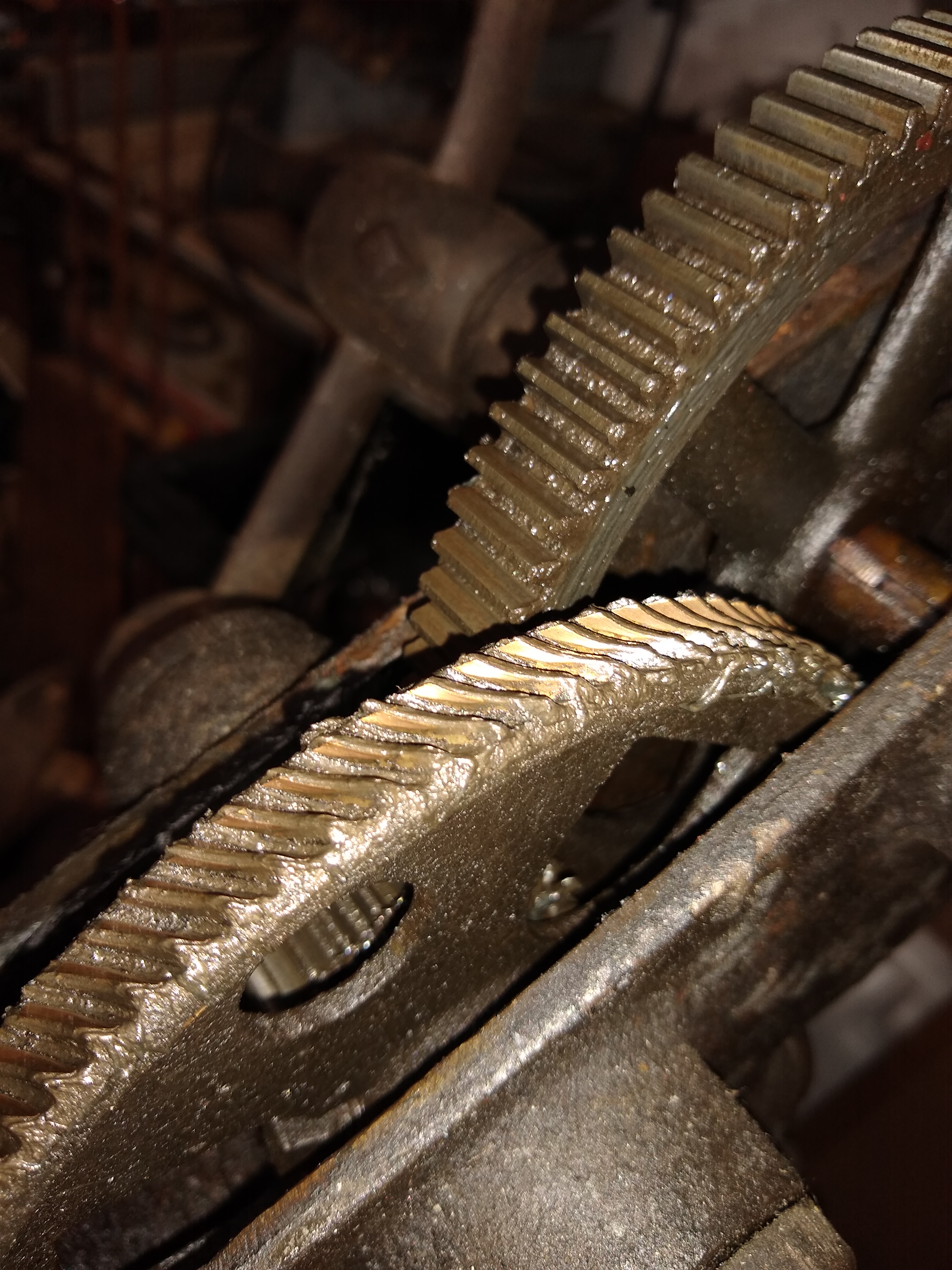

  18. Well, I checked out the interior of the 400 and it was well maintained. The blades are all intact and the interior is free of varmints. The gear box looks like he have used a thicker grease to lubricate but the gears are in excellent condition and it turns smooth. I went to the hardware store and hunted all around for the aluminum dryer vent hoses. I found them and they were all 4 inch diameter. But off to the side there was a that looked like the smaller generic version of all the others. It was 3 inch but labeled specifically NOT for dryer vents. Since I am not using it for a dryer anyways I figured I was in luck! They also had 2-4 inch hose clamps there so I got a couple and now can use my blower once it's cleaned and oiled. Thanks again all.

  23. So, I posted some pictures of my forge in the "Show me your forge" thread. I am new to this little obsession and am looking for some tips here and there. In this particular case I have a question about attaching my blower. It's the image below, a Champion 400 that works great. I bought it, a couple cross peen hammers, and the former owner's excessively large fire pot for $100. The fire pot is far too large for me at the moment (it's a hub of some sort off of an old tractor trailer) so I made my own brake drum forge. At the moment I have a hair dryer attached as shown in the other picture below. However, I am trying to figure out how to attach the 400 because I have learned it will work wonderfully. My current tuyere is made from 2inch (internal diameter) formerly galvanized pipe and fittings with the hair dryer attached as shown. The 400 has a roughly 3 inch exit and my piping is slightly larger than 2 inches externally. Anyone have suggestions for the best way to get air from one end to the other? Thanks in advance.
