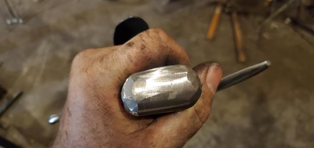

Chad J. Posted January 17, 2021 Author Share Posted January 17, 2021 I got busy with the colder weather and a move into my house. Also, for the life of me, I couldn't get a decent handle extension forged... until today. I was goofing off making an herb chopper from a rail road spike when I realized that with minimal work it, the cap would make a great pommel end and drawing out the spike would bring it to the width and thickness I wanted. Since I was on a roll, and I have plenty of rail spikes, I started drawing another one out for the guards. So after a few months I can finally get back on this project. Link to comment Share on other sites More sharing options...

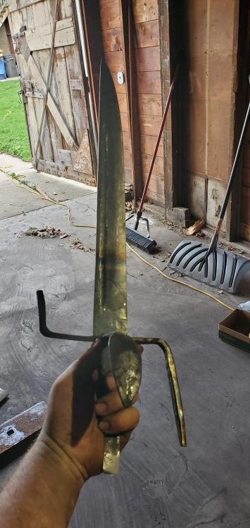

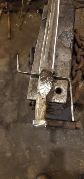

Chad J. Posted July 18, 2021 Author Share Posted July 18, 2021 I have some cleanup work to do on it but I have finally assembled my short sword. RR Spike guard and knuckle bow, rr bolt pommel peened on, deer antler handle with epoxy for a good measure. Nothing is moving. It isn't the prettiest sword but it's my first competed. Link to comment Share on other sites More sharing options...
George N. M. Posted July 18, 2021 Share Posted July 18, 2021 Nice job. Did you forge the fuller in or did you grind it in? If I may make a couple of suggestions: I think the guards would look better with more of a curve than the sharp angle you have used. Also, I suggest that the knuckle guard be curved back on itself. You have a semi-sharp point aimed at the user and that is seldom a good idea. You never want to facilitate a self inflicted injury. I can see it getting knocked into your leg or hip, particularly when parrying an opponent's blow. "By hammer and hand all arts do stand." Link to comment Share on other sites More sharing options...
