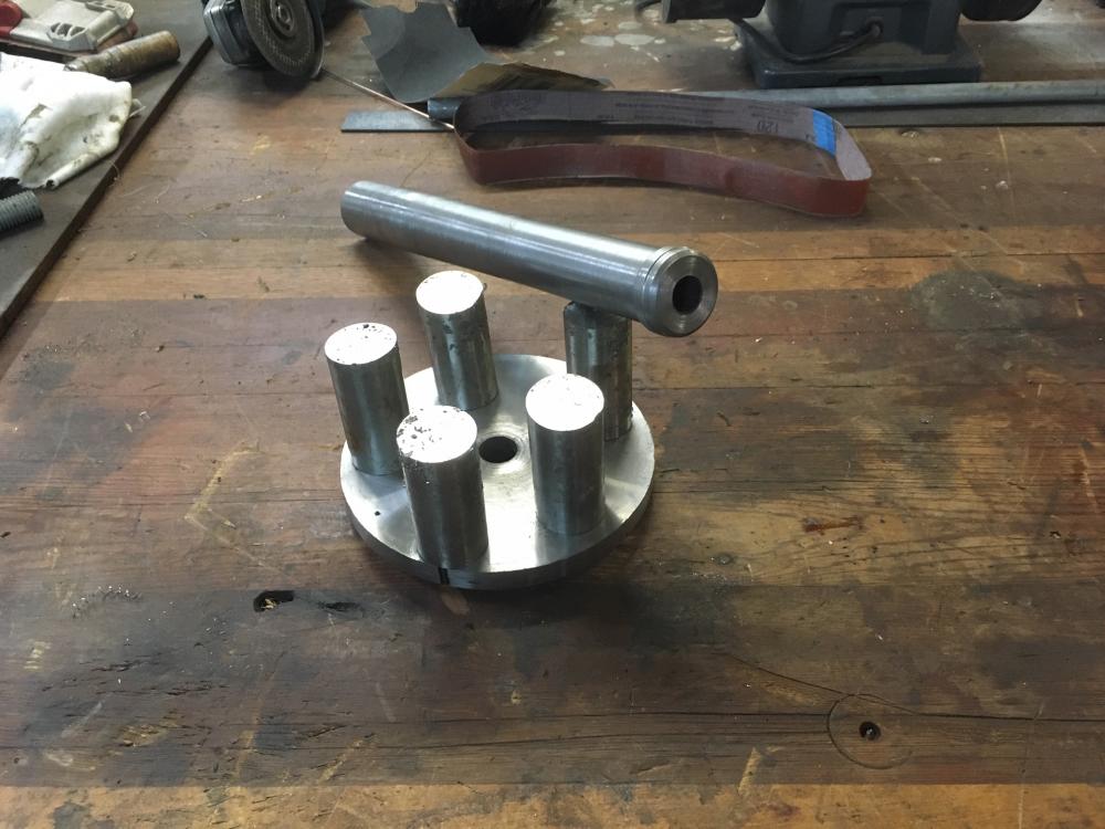

Apacheforge Posted August 24, 2020 Share Posted August 24, 2020 I have been a metals craftsman for 53 years. From fine jewelry to tunnel boring machines. Along the way enjoyed building a variety of scale historic cannon. Recently i have created a table top scale Puckle Gun. A repeating cannon invented by James Puckle in 1718. It is a functioning concept model with the idea of building a 40mm rifled version. Link to comment Share on other sites More sharing options...

Apacheforge Posted August 31, 2020 Author Share Posted August 31, 2020 The barrel is from a de-mil anti-aircraft gun. And the other parts are from heat treated 4140 alloy steel. I designed this to withstand smokeless powder pressures but will only run pyrodex powder, which is a low pressure propellant made to be used in blackpowder guns. the receiver and chambers are machined from solid bar stock. I have made cannons using high pressure seamless tube before and have 20 years of regular shooting with them, but in this instance i prefer starting off with solid stock. Link to comment Share on other sites More sharing options...

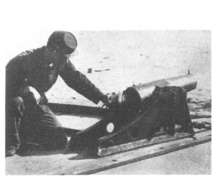

Apacheforge Posted September 13, 2020 Author Share Posted September 13, 2020 On 8/31/2020 at 12:47 AM, Frosty said: The rifled, breech loading, cartridge, mountain howitzer. I don't need a large howitzer, just something for the shooting range. A few friends of mine have purchased little Krupp 50mm pack howitzers that were found in a warehouse in Thailand. Cute and deadly from around 1900. At the time my friends bought them, those guns sold for $25,000. Now you can expect to pay $75,000. Heres a pic. Link to comment Share on other sites More sharing options...
Apacheforge Posted September 13, 2020 Author Share Posted September 13, 2020 Here is the receiver being set up for locating the trunnions. Counter bores were added and the trunnions had a stub turned at the base to fit the counter bore. I then Tig welded them in place with nice big and deep filets. I then bored and turned some solid 4130 bar into collars that will be coped for a nice fit and then welded in place. Link to comment Share on other sites More sharing options...
Frosty Posted September 14, 2020 Share Posted September 14, 2020 One of those little Krupps looks like what I was thinking of. Sure be an attention getter at the gun range. Frosty The Lucky. Link to comment Share on other sites More sharing options...

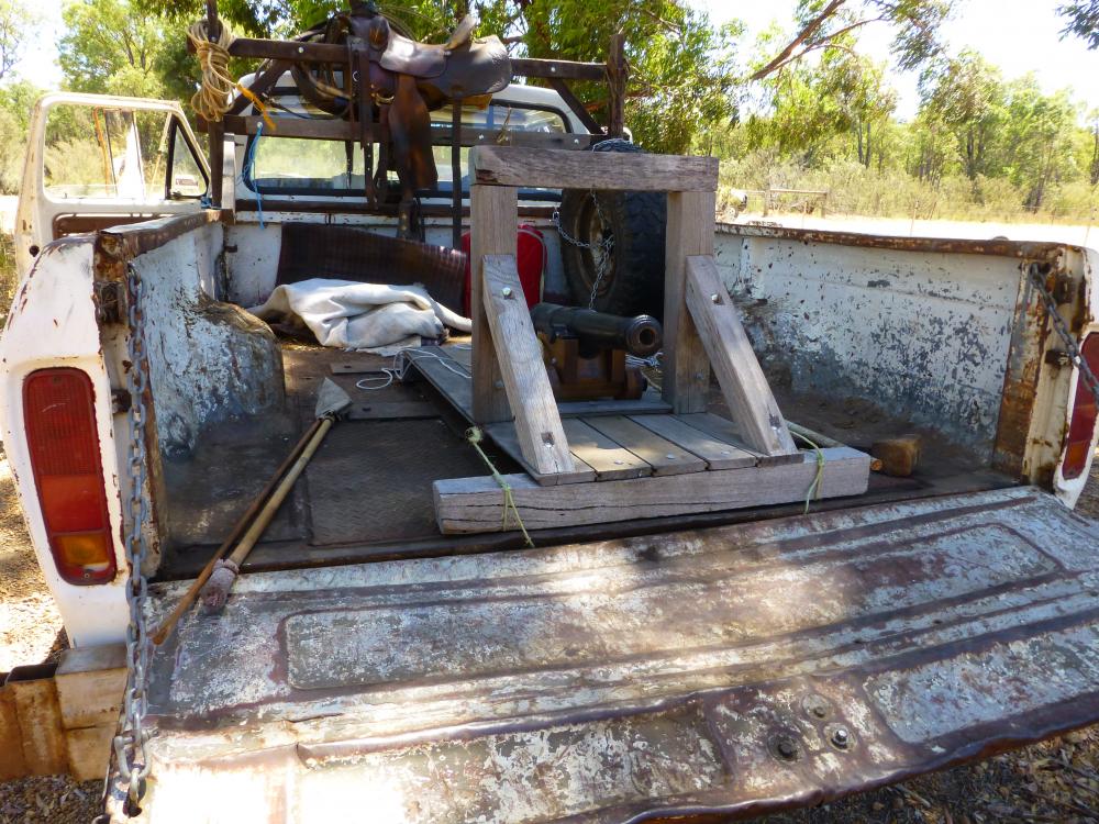

Heelerau Posted September 15, 2020 Share Posted September 15, 2020 I trust you are making it with a square bore for shooting non christians! That is a mighty project, will be interested in the finished result. I love the Krupp pack cannons. I have a 3rd scale 32lb naval gun that mounts in the bed of my old pickup Link to comment Share on other sites More sharing options...
George N. M. Posted September 16, 2020 Share Posted September 16, 2020 Do you have wee, 2 foot high, gunners to serve the piece? How large is the bore, what weight shot, and range? It appears that you are using a linstock for ignition although a pistol flint lock might be about in scale for a 1/3 scale cannon lock. I particularly like all the tackle to return the piece to battery. "By hammer and hand all arts do stand." Link to comment Share on other sites More sharing options...
Frosty Posted September 16, 2020 Share Posted September 16, 2020 What I like is he appears to be firing it from the basement. Boy would solicitors get the message. . . Finally. I need more friends with cannons. Frosty The Lucky. Link to comment Share on other sites More sharing options...
Heelerau Posted September 16, 2020 Share Posted September 16, 2020 1 1/4 inch bore, 10z of Fg, ball just over 1/2 lb cast lead. We have a terrace on the south side of the house with an embrasure for the gun, next to a flag pole. That was a time shot hence the double image. Weight of about 70 lbs, cast iron around a seamless steel bore with welded breech plug. Cast in a local Perth boundary, a chap had a number of these made, my in-laws gave it to me as a 50th birthday present. Link to comment Share on other sites More sharing options...
