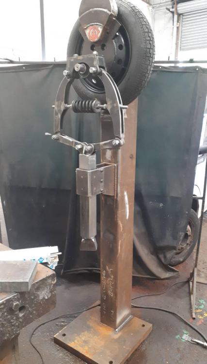

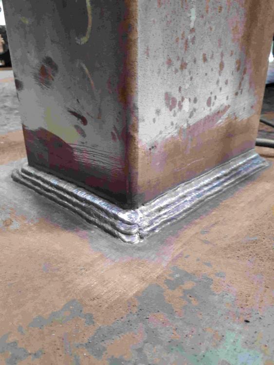

Gavj75 Posted June 21, 2020 Share Posted June 21, 2020 I got another 4 hours graft on my tyre hammer build today and I think it's coming on a treat. I finally got some 4mm welding rods and finished off the welding of the box sec. spine to the 50mm base plt. The result is approximately a 15mm fillet made up of 6 runs. With 3.25's, 1 in and 2 over then with the 4mm's, 3 over those The other thing I did today was drill and tap the 4 M16 holes in the corners of the 50mm, 140×140mm plt, which will then be welded to the top of the anvil post. This is how I'm going to fix the anvil dies or blocks(not sure what they're called)to the anvil post. So that was today's progress I'm getting close to attaching the drive motor so prior to that I need the drive wheel making but are not sure how big it should be? My motor is 2hp and runs at 1360rpm and the wheel is a 15" diameter. If anyone can advise me on this that would be cool. Thanks Quote Link to comment Share on other sites More sharing options...

arftist Posted July 3, 2020 Share Posted July 3, 2020 Your slide area looks way too short. You want at least 10 inches. Quote Link to comment Share on other sites More sharing options...
Irondragon Forge ClayWorks Posted July 3, 2020 Share Posted July 3, 2020 For my Star 30 pounder, I have it set up for 120 BPM, that's plenty fast for me and what I do with it. Any faster and it gets scary. Quote Link to comment Share on other sites More sharing options...
Gavj75 Posted July 8, 2020 Author Share Posted July 8, 2020 The contacting surfaces between the shaft of the hammer and the brass slides which are housed in the shaft sleeve have been a source of concern for me since I first put the assembly together. All my instincts have told me that I need to make it bigger so thanks, ''arftist'', for assuring me this is the case. I have an idea that I'm going to give a go, by adding some guiding rollers to the top and bottom of the sleeve, before I re-make the whole assembly. Who knows? you don't know until you give it a go, right? As for the bpm's, I was originally going to go for 150, 2.5 per second but decided to up it to 180 after reading the reply's I got. I'm now going to go with 150 again which is a 2.5inch diameter drive wheel. If this turns out to be too fast and possibly even scary, I can always drop it down some more by taking a bit more meat off my drive wheel. I can take more off but can't add more on. I didn't get much done in the shop again this week(I only get a few hours most sundays) apart from I built my anvil post. Its not fully welded yet and don't have any pics for you to see, but it's a bit more progress I spoze. Thanks again for everyone's feedback, untill next time Quote Link to comment Share on other sites More sharing options...
Frosty Posted July 8, 2020 Share Posted July 8, 2020 Don't worry about a hammer that goes faster than you like, you can throttle the speed with the treadle. You don't drive your car by mashing the gas to the floor do you? 9 minutes ago, Gavj75 said: I have an idea that I'm going to give a go, by adding some guiding rollers to the top and bottom of the sleeve, before I re-make the whole assembly. Who knows? you don't know until you give it a go, right? Yes, we DO know, people have been putting guide rollers on home built power hammers for years and most seem to have reverted to slide guides. You know you can buy proven plans so you'll KNOW it will work if you follow them. Yes? The time to start experimenting with machinery is AFTER you understand them and can predict the probable outcomes of experiments. Frosty The Lucky. Quote Link to comment Share on other sites More sharing options...
Gavj75 Posted July 8, 2020 Author Share Posted July 8, 2020 Yep, got you, read u loud and clear. It's not that I'm ignoring your advice FTL, and I do appreciate your input and guidance, it's more a case of as I don't have money to throw at the issues I come up against,and even if I did, I wouldn't, as well as the fact that I'm a mechanical engineer with 20+ years experience using heavy machinery and the fact that I started doing this because I enjoy designing and building things, that I'll be trying out my ideas before reverting to an alternate altogether. I have no interest in buying proven plans to build something from. That is pretty much what I do at work every day. There is no fun in that 4 me and if there's no fun, what is the point in the first place. Quote Link to comment Share on other sites More sharing options...

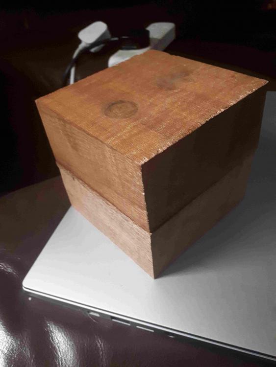

Gavj75 Posted July 18, 2020 Author Share Posted July 18, 2020 As soon as the anvil post is finished I've got the small problem of making my drive wheel. Getting one turned is definitely not an option as I was laid off from work last Friday, along with 30 other lads, so I now have even less money to spend on it than before. My idea is to make one from 2 bits of hard wood glued together to make a block roughly 4" × 4". It's teak apparently.I'm going to grind a 25mm wood drill bit down to 23.9mm, ish(the motor shaft is 24mm)then drill and attach the block to the motor. Then build an improvised wood lathe around that to turn the block into my wheel. Thats the plan anyway. I'll let you all know how it goes. Quote Link to comment Share on other sites More sharing options...
Frosty Posted July 19, 2020 Share Posted July 19, 2020 That should work. Are you alternate the direction of the grain when you glue it up? It'll help prevent grain splitting out when you turn it. Frosty The Lucky. Quote Link to comment Share on other sites More sharing options...
Gavj75 Posted July 19, 2020 Author Share Posted July 19, 2020 Yeah, I lined up the 2 chunks of wood with the grains running roughly at 90° to each other. Used PVA wood glue and left them clamped up for 24hours. Just need my motor wiring up now so I can crack on with it. Quote Link to comment Share on other sites More sharing options...

Buzzkill Posted July 20, 2020 Share Posted July 20, 2020 On 7/17/2020 at 8:22 PM, Gavj75 said: My idea is to make one from 2 bits of hard wood glued together to make a block roughly 4" × 4". It's teak apparently.I'm going to grind a 25mm wood drill bit down to 23.9mm, ish(the motor shaft is 24mm)then drill and attach the block to the motor. Then build an improvised wood lathe around that to turn the block into my wheel. That's pretty much what I did for my drive wheel as well. I clamped the motor to a work bench (with the correct amount of shims for height) and used a piece of RR track as the tool rest. My motor runs faster by a few hundred rpm, but it worked fine and the drive wheel is still doing fine after several hours of use. Quote Link to comment Share on other sites More sharing options...
