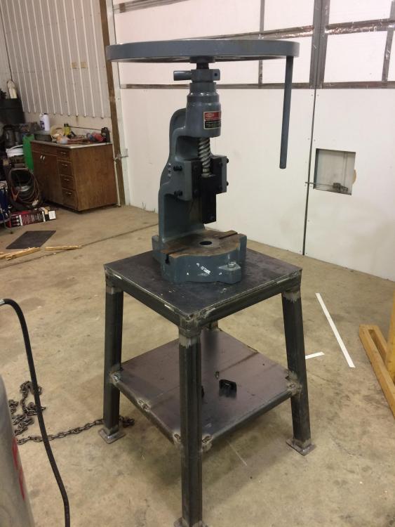

I decided to go with the #5 and I'm happy I did. I have since built a stand for it and used it a little. It's not overly cumbersome, which I think allows you to hit faster when doing light work. But yet it's heavy enough that you can really move some metal when you want to. After using it, and making a few different tools for it, I actually think punching a hammer eye would be one of the easier jobs for a flypress because the force is so concentrated on that one small spot. I think if you just design your tools properly, and make them concentrate the force enough, you can eventually do about anything that you want done on any sized press.
My flypress and stand :D-->IMG_2545.thumb.JPG.250b579d02f7bdc1f14603be105d3863.JPG
