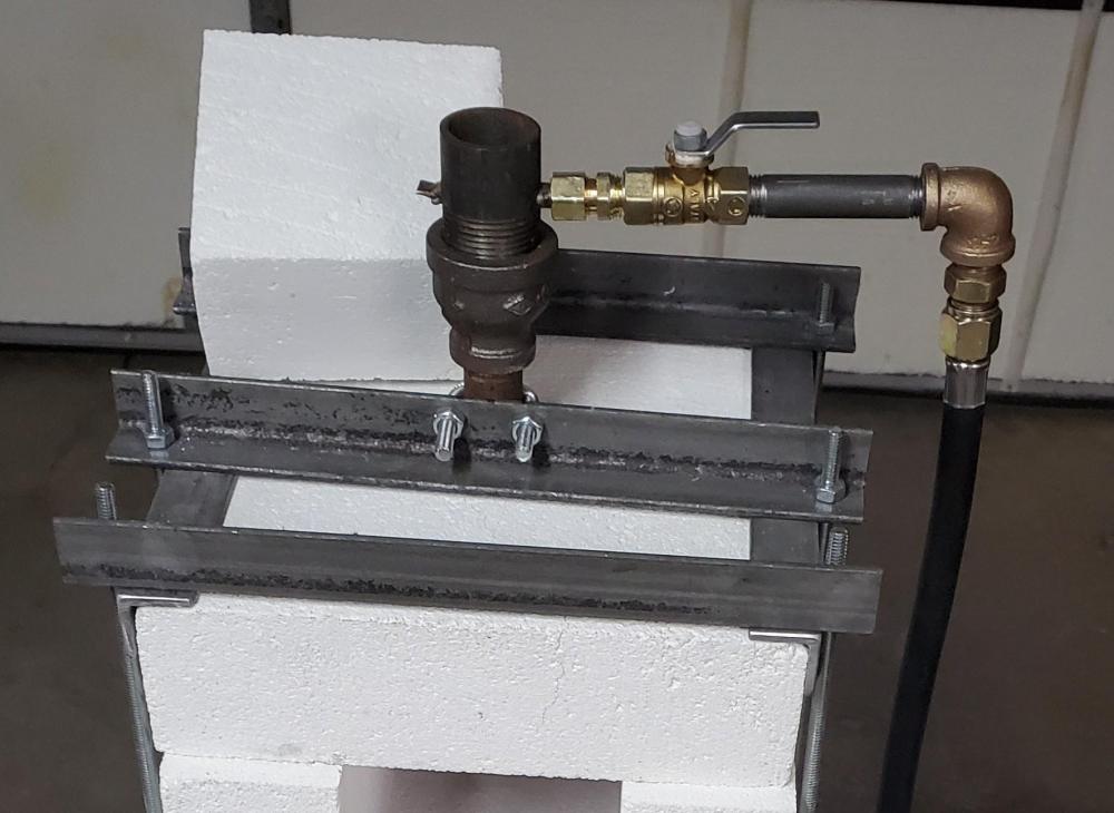

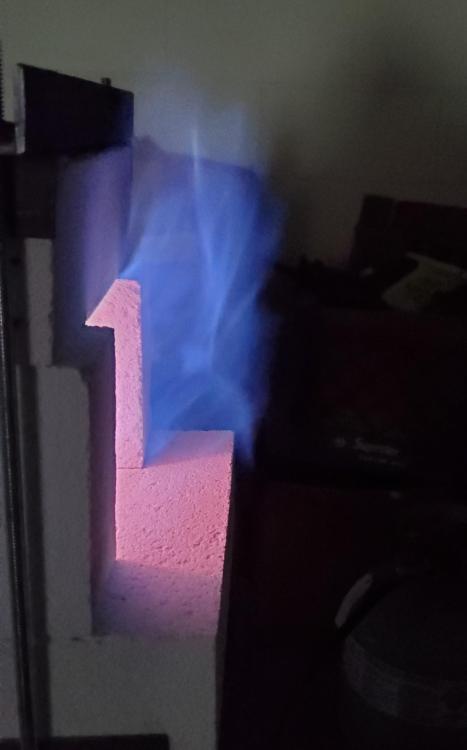

I know this is posted frequently, but I struggle with colors.  I see all the primary colors but don't see shades very well.  Anyway, I'm new to propane forges (forges in general actually) and I'm trying to learn.  Using Thermal Ceramics JM30 3000f firebrick pile (approx 145 cu in) with a single 1/2" Reil style burner.  I built the burner before I had read much admittedly but it is to general specs in fitting sizes and lengths. Using a 0.03 inch orifice (not mig tip sizing but actual orifice size).
I feel like this is running a little rich but again, I struggle with color.  I can't see any green, though green is very hard for me to see in general.  Once warmed up the flame seems steady.  I tried to take photos that represent what I see looking into the forge in a mostly dark shop.  I did try to take photos at slightly different exposures.  This is after about 5 minutes running.  The piece of railroad spike was nonmagnetic immediately after these photos.  The first photo is most like what I see in person.  Dragon's breath is not real big, 4-5 inches at most and more orange than anything.  That's really hard for me to see and I couldn't get a photo, sorry.  Using an adj pressure regulator, no gage yet (on the way), but estimate between 5 and 10psi.
Any opinions welcome and thanks for having me on this great forum!
The flame looks pretty good, but is so washed out by the incandescent walls, that nothing conclusive can be said. One more photo, with the flame in a forge, which hasn't have time to heat will tell more. In the meantime, the orange color of  a forge that is running with one side wide opening is strong indication that its flame is in good shape.
Thank you Mike!  I've been lurking and reading here for the past week.  I downloaded your book also and very well done and written! Only copies I was finding to buy were very expensive and I've read you mention to others how easy it was to find and download that I took that as acceptable to do. I got that's ok.  If you know a source that isn't close to 100 bucks, I'd be happy to buy one!  Again, thanks for chiming in and for the wealth of knowledge you have shared.
Just adjusted a few things a bit on the burner, mainly adjusted it more vertical (it was pointing a hair left in the clamp before) and smoothed out a slightly tapered flare in the brick to act as burner flare trying to follow the 1:12 taper I've seen you, Frosty and others recommend. The end of the burner is set about 1inch into the brick measured from the inside forge chamber face, which is also where the taper begins.  I had previously smoothed down, rounding and lightly tapering, all the inside edges of the venturi bell the step in the reducing side of the bell and both ends of the burner pipe.  Each detail did seem to add a minute improvement, whether it mattered I don't know, haha.
I'm attaching a couple images from just now.  The first two (lighter) are within a minute of lighting it, running (I estimate) 4-5psi. The second two are after warming up about 4 minutes in a darker space.  That has a higher psi, approx 6-8psi.
After that I threw a full size rail road spike in and closed half the front off with a brick.  It got up to non magnetic within 3 minutes.  Pretty happy but I'm trying to learn both how to judge color and temp better and trying to optimize this setup as much as possible.

your flame looks a smidge on the green side to me in the photo with it heated and running at 8 psi.  The photo at 4psi looks a lot green but I have a feeling that is because of the low pressure stopping you from drawing as much air.  and you have a good bit of dragons breath so yeah you're running rich.  can I see a photo of the burner please?  I know you said it was a riel style but there's a lot of different design's.  Also did you drill the orifice or did you use a migtip?  and what size?

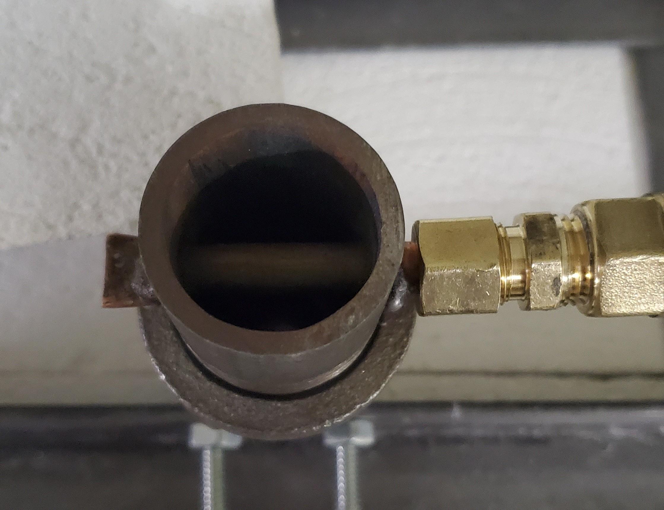

I've attached two photos.  I made this before I found this site or had done much reading and as a result I think my venturi bell is too small.  That should lead to a rich flame, correct?  I used a 1/2" burner tube which is cut to 4 inches long. Then a 1/2"to 1" reducer and a short pice of 1" as the inlet. I suspect I should have used 1-1/4" but I already had all those parts in the garage so I went for it. My orifice is drilled into the side of 1/4 copper tube that has the end crimped and soldered.  I used water from a hose to align the orifice with the center of the burner tube, then soldered it in place.  The orifice was made with a 0.03 drill. It may be a hair bigger if there was runout, I have no way of measuring further.
Here in lies me problem, in neither real life or in the photos can I see any green. I believe you, I just can't see it.
What about the dragons breath suggests rich?  More green color? Something else?  I thought a rich condition there was signified by a strong yellow in the dragons breath... Not from experience, from reading, obviously.

yes you are not drawing enough oxygen someone like mikey or frosty would be better at recommended a possible solution with your set up.  My recommendation is to just build a T burner following the directions on here.  it will work for you as is it just won't work to the best parameters.   As for the dragons breath having large billowing wisps is an indicator you are running rich because you are not getting full combustion in the chamber.

Blue or not, all that flame outside the forge means there is more fuel than can burn IN the chamber where you want the energy. Yes?
Nothing wrong with  one of Ron's linear burners. What I don't understand is the pipe nipple on the intake bell. It reduces the air intake cross section considerably and being so far above the bell does little or nothing to induce vortex.
I don't know who did that first but it's turned into some kind of . . . thing.
How about instead of trying a larger intake bell you lose the nipple and solder the jet directly to the intake bell. That alone should increase the combustion air considerably, maybe 50%, I'm not going to look up the ID of the pipe or large end of the bell so that's just an eyeball guesstimate.
See what that does before you try some of the more complicated ways to increase air induction through a linear.
The BIG difference between a linear and a jet ejector type induction machine is how much vacuum they draw. IIRC an optimally tuned linear induction device will draw about 20 : 1 in a propane burner that is 20 parts air per  1 part propane. This requires a choke to restrict air for a proper burn ratio. Linear inducers are commonly used to induce combustion air and mix fuel, lift the cover panel on a gas range, or under a BBQ Yes? Jet ejectors aren't used commercially as burners, they're used to draw vacuum, the trucks cleaning storm drains use a jet ejector to make a STRONG vacuum drainage truck are famous for sucking dead bodies through the hose and boom into the tanks. Nasa's big vacuum chambers used to train astronauts and test things like space shuttles in vacuum before shooting them into space are evacuated with BIG, think tanker truck sized jet ejectors.
All  that is to say on our level of home made inducers a jet ejector, a Mikey, Sidearm or T properly tuned can draw up to 29:1 which means we can use a larger gas jet and put more fuel and air in the forge at a lower velocity. More flammable mixture per second that stays IN the forge longer to transfer more energy to the forge liner so we can use it.
Most of the tricks for tuning a jet ejector don't work so well on a linear type burner but they're sort of run as built anyway. Primary PSI (gas pressure) has a greater effect on induction ratio making it much easier to use a smaller than ideal jet and higher primary psi to induce more air than necessary and put a choke on it to control air intake.
If you build a T burner we can talk about how I fine tune those. Once tuned jet ejectors have a much flatter induction curve so you don't have to mess with them, they turn up or down without effecting flame characteristics much, other than velocity and BTU per second output.

So, the flame photos.  Note, I cannot seem to get my cellphone to capture photos that are even close to the colors I see in person.  These photos seem to have a lot of magenta and purple that I do not see in person.  In person the bulk of the flame is a nice, bright light and dark blues reminiscent of the flame I have used in well functioning oxy/act brazing and cutting torches. This flame with just a little tuning has no green (I think Ive finally figured out how to identify that by examining flames that I know have to be very rich/reducing, though I do see it as a difference in blue at the tips rather than green due to my color vision issues), a rich blue color and occasional wisps of yellow.  I have tried this burner with all manner of tip lengths in an attempt to better see and understand what various states of flame look like, starting at extreme rich/reducing using a full length mig tip and working my way back in 1/32-1/16 steps until the mig tip was almost gone resulting in a very lean/oxidizing flame.  I figure sacrificing one tip was a worthwhile cost and I stand by that.  A tip costs max $2 so it was money well spent.
These photos are with the tip cut just past halfway (closer to the top of the T and further from the burner tube).  Currently the tip is approx 1/32-1/16" shorter than half the opening distance.  My method of construction (see my next posts soon) allows me to screw it in and out the up to +/_ 2/27" (thread pitch on a 1/8" NPT thread is 1 in 27).  I've tried throughout this range and to my eye this best matches what I've seen the gurus here recommend, specifically Frosty where he has suggested tuning until just barely rich/reducing with no green and only minor wisps of orange in the flame and dragons breath.  *Frosty, if I am misspeaking or have interpreted this incorrectly I apologize and am ready to be corrected.!*
The first photo is within 1 minute of lighting the cold forge at approx 4-5 psi.  I believe people say psi isn't the most useful measure but i like to provide as much info as possible both for myself in future readers (and my future self).  Remember, this is a less accurate and lighter blue than in person but the proportions are similar and the occasional orange streaks are represented.
Second photo is after approximately 2 minutes when its stabilized enough I could turn it up.  This is around 8-10psi.
Third photo as immediately after from the side.  Note, in all of these the back is completely closed off.
I suspect this is still running a touch rich, but too rich?  Again, I am sorry for the poorly captured colors.  I've spent a lot of time with nice camera equipment and editing software and not being able to capture reasonably accurate images is frustrating to no end.  My good gear is 3000miles away :/

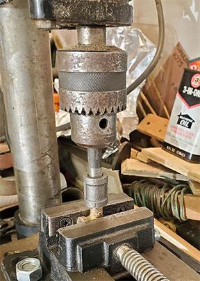

Here is a brief write-up with photos of how I built the injector for my 1/2" burner.  Nothing real special and I didn't change the fundamental design in any way, Frosty has already optimized the design and function, but this is the tooling and tricks i used to drill out the T and fit a mig tip given the tools and materials i had available. There are two places during construction where people are most likely to run into errors that result in off-centered mig tips not pointing directly down the center of the burner tube.  This does require access to a drill press.
Frosty recommends using a floor flange and close nipple to support, clamp and align the T most easily.  I agree with that but found my store has pretty low quality floor flange, T's and other fittings that are not always cast or machined so well.  The floor flanges, for example, were not cast flat enough to rest solid on a surface nor were most tapped perpendicular to the base.  I decided to come up with a way that would bypass those issues, hopefully.  The second issue I found was no access to schedule 80 pipe fittings, meaning i could not find fittings with small enough internal sizes nor with enough brass/steel in the wall to drill and tap for the mig tip threads. I solved this by using a brass street elbow.
By incorporating brass fittings, which do cost a touch more but that are machined to size the tolerances are greatly improved.
Having a top mounted burner in a brick pile forge I wanted to move the propane hose connection to the side, hence I used a 1/8" brass street elbow.  Street fittings have one male and one female fitting, usually but not always, in the same size/thread.  I already had a 1/8 NPT (national pipe thread) tap so using the street gave me an inside diameter with plenty of wall thickness suitable to be taped for the 1/4"-20 threads on the Lincoln Mig tips i am using. * Note, different welder manufacturers utilize a variety of thread pitches including 1/4-20, 1/4-27, 1/4-28 and various metric sizes.  Make sure you have the correct tap, pilot drill, etc to fit your particular tips.  This has already been discussed in depth in other threads.  As for the brass or steel fitting you use to insert into the T and hold the mig tip, use whatever style you need that will fit your setup and allow you to eventually connect gas.  A street elbow is cast before it is threaded with a die so it is not the best choice.  I picked through the pile to find one that seemed to have the cast hole as close to center in the threads as I could and with careful alignment before drilling and tapping it worked fine.  My idea choice would have been a straight brass fitting, which are machined, but I went with what I had. Note, i did use a belt sander (or use a file) to cut back the end of the street a couple threads this got rid of any burrs and created a better surface to start driling an taping, and provides a better seat for the mig tip later.  You want this surface flat, square and smooth!
The biggest "trick" to all this is finding ways to index your critical surfaces with the chuck of your drill press, as you will see below.
Here is a photo of all the fittings and main tools I used for this, plus a drill press and some wrenches.
Now here is my first trick.  Since we want our mig tip centered perfectly in the outer male threads of the 1/8" street elbow i will use the 2" nipple from my build plus an extra 1/'8 coupler.  A brass coupler is more likely to be manufactured better but this one worked.  By chucking the nipple in an UNPLUGGED drill press (you'd be amazed how much muscle memory makes you want to turn it on!) you can use it to carefully tighten the vise (you can use any clamping arrangement needed to make this work, including using angle clamped to the fitting the clamped to the table but these vises are cheap and very handy) then clamp or bolt down the vise.  Careful patience here will keep everything lined up tight and straight.  you can turn the quill by hand to back out the fittings leaving the elbow firmly clamped, then move them back down and turn my hand watching for run-out to ensure everything was tightened inline and didn't shift.  And deviation try again until it is correct!
Now remove the coupler and nipple and put in your drill bit sized appropriately for the tap for your mig tip threads.  In my case it is a #7 for the 1/4-20 threads on the Lincoln tips.  As you are machining very soft brass for only a short distance you don't need a number 7, a 13/64 is certainly close enough.  Keep in mind you will need to change out the drill bit then but in a shorter tap,. all without moving the drill press table so play around with how down you have the quill when you clamp the fitting into the vise so you have room to do everything in one shot.
Then drill out the interior of the fitting until you get almost to the internal bend, remove the drill bit, unplug the machine, put in the tap, and use the quill, turned by hand, with gentle and steady downward pressure on the handle to turn in the tap cutting the threads,.  follow proper threading technique using lubricant and backing off frequently to break the chip, until you have threaded though the fitting.  Read up on that if you do not know how.  You will want to try the tip in the fitting before removing it from the vise to ensure you tapped far enough.  Remember the taps are tapered toward the end to facilitate starting.  Tap several threads longer than you need to be safe and to give you room for adjustment later.
First part done!  Notice how the mig tip seats tightly and square because I squared off the end of the street earlier.
Now, using the same trick of indexing the important surfaces using the quill of the drill press, we are going to use a brass 3/8"hose to 1/2"NPT as an alignment jig.
Above you see me drilling also.  I messed up here and forgot to take an image of a key step!!!  The real trick is to put the barb in the drill drill press quill, plunge down and lock in a vise and lock the vise to the table, then chuck up a drill  bit that is just barely bigger than the inside diameter of the barb, and drill out the barb first.  This allows the barb to act as a bushing also during drilling allowing the bit to wander less and start better against the rough and rounded inner surface of the T.  All of this work is pointless if the bit wanders off center.  By doing all of this we are helping to ensure that the hole in the T is lined up perfectly with the burner tube threads, which will ensure a centered mig tip and a better functioning burner.  This also helps us align the T more accurately in a future step.
After you drill out the barb, put the barb into the T, place it in the unplugged drill press chuck, move it down to the vise, tighten, lock down the vise, double check everything, release the chuck and insert the drill bit you just used.  You may need a dry run here ,depending on how much travel you have in your quill, to have enough room to drill the T and also get the bit into the chuck.  I have a tiny tabletop drill press and was able to just do it.  Slowly drill the hole, starting gentle to help keep the bit from wandering or binding on the uneven, curved inner surface of the T, as shown above.
Finally, we need to tap the T for the 1/8"NPT but we must do that from the outside, as they are tapered threads.  Since we drilled out the barb fitting and it is inline with the hole and is all the same size, we have a convenient way to index this after we move it.  Remove everything from the vise.  Unplug the machine,. flip the T and barb over and slip them onto the drill bit still in the machine.  Push the quill almost all the way down and lock the barb hex into the vise, lock down the vise.  Make sure nothing moved when you were locking it down, switch to a letter Q or 21/64" drill bit (the required size for a 1/8"NPT tap) and drill out the hole form the top.
Now unplug the machine, insert the tap and turn the quill by hand to tap perfectly straight and centered threads!
