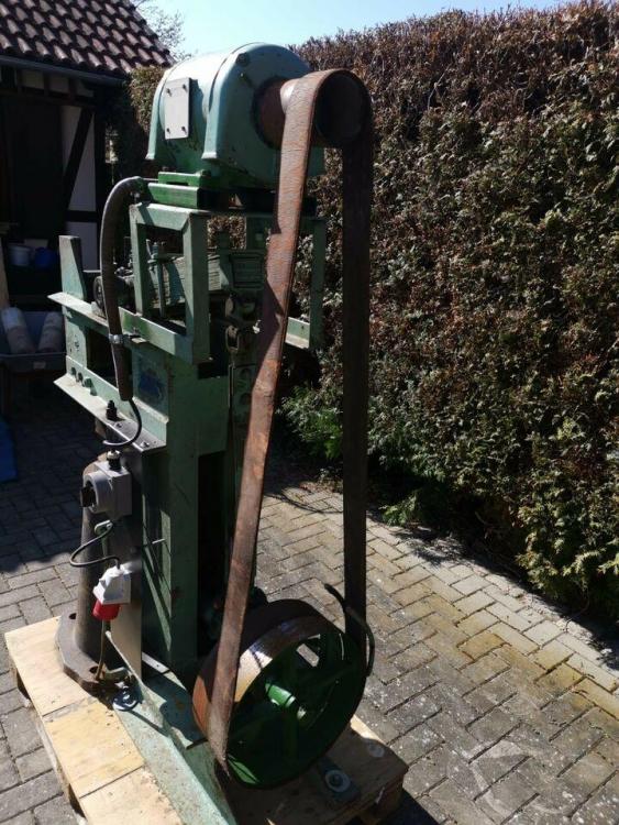

Benona blacksmith Posted April 29, 2020 Posted April 29, 2020 Does anyone have any info on this style hammer? I am buying it but dont know much about it. It is listed as being in good working order. There is no info on tup (bär) weight. Mainly what I'm interested in is the ram weight. I will try and get some more pictures. Quote

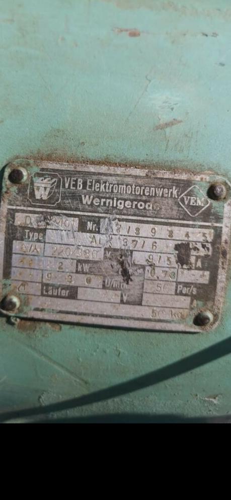

ThomasPowers Posted April 29, 2020 Posted April 29, 2020 Please do, I've seen other examples of the laminated rocker arm and guided ram hammers in PotP IIRC; but they don't seem to be common in the states. How big a motor does it use? Quote

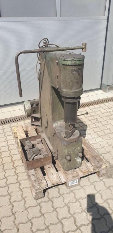

Benona blacksmith Posted April 29, 2020 Author Posted April 29, 2020 It says 2 kw or almost 3 hp I'm also getting this 26 kg Kuhn Reiter Quote
Broad River Forge Posted April 30, 2020 Posted April 30, 2020 looks like a ball park 70kg hammer. thats about the right horsepower too based on the Ajax and Prako hammers that one is similar to. Quote
Benona blacksmith Posted May 3, 2020 Author Posted May 3, 2020 Ok so the motor plate that I posted a picture of I dismissed as having any information about the actual hammer itself. But after looking closer at it, it says 50kg in the lower right hand corner! Unless that's the weight of the motor? Quote
Hans Richter Posted May 3, 2020 Posted May 3, 2020 Hi, maybe some additional information with you hammer. The nameplate and the brand name mentioned state in any case that the electric motor was produced in the former East Germany (my parent are married in 1967 near to the company). In my early days in 1988, I myself forged many of fence post with a UHF 50 ("50" witch means the 'Bär' weight) that was properly equipped with this electric motor. Unfortunately, little information can be found about the UHF company in the city of Karl-Marx-Stadt (now Chemnitz) that produced these hammers. Wish you good luck and hope to have been a little helpful. Cheers, Hans Quote

Hans Richter Posted May 5, 2020 Posted May 5, 2020 Hi Ben, I'm definitely not a Sir, just one of many seekers like all of us. According to many German forging forums that I consult, you will run a beautiful spring hammer that has many similarities with an Ajax-Hammer about which you can find more on the worldwide net (search also for WMW). Here, especially the stroke control and the cold brittleness of the spring package (age) are a controversial item. In my golden memories, I especially like the jar of beeswax that was necessary to prevent slipping of the flat belt while switching from the neutral disc to the drive disc. On 5/5/2020 at 8:53 AM, Benona blacksmith said: Thank you sir for the information!!! By the way, it is very amusing how an East German spring hammer finds its way to Minnesota Quote

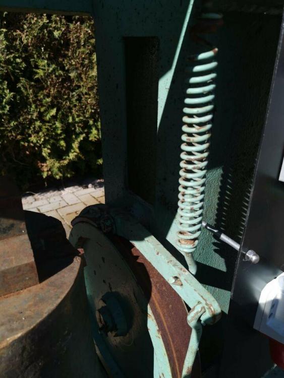

Benona blacksmith Posted May 11, 2020 Author Posted May 11, 2020 Here is a few more photos if the hammer. Looks like it has a brake on it. Quote
Hans Richter Posted May 11, 2020 Posted May 11, 2020 That would indeed not be a nice discovery of the main flywheel and the brake of the hammer. If the broken-out part of the flywheel is still present, you can still rebuild it with cast iron electrodes (stickwelding) or fill it up with cladding. In the worst case, the flywheel must be replaced with a newly turned part. Also pay attention to the brake lining of the hammer, which may be made of asbestos. If you want to spar on the whole issue, skype my or send a PM is happy to be at your service. Quote
